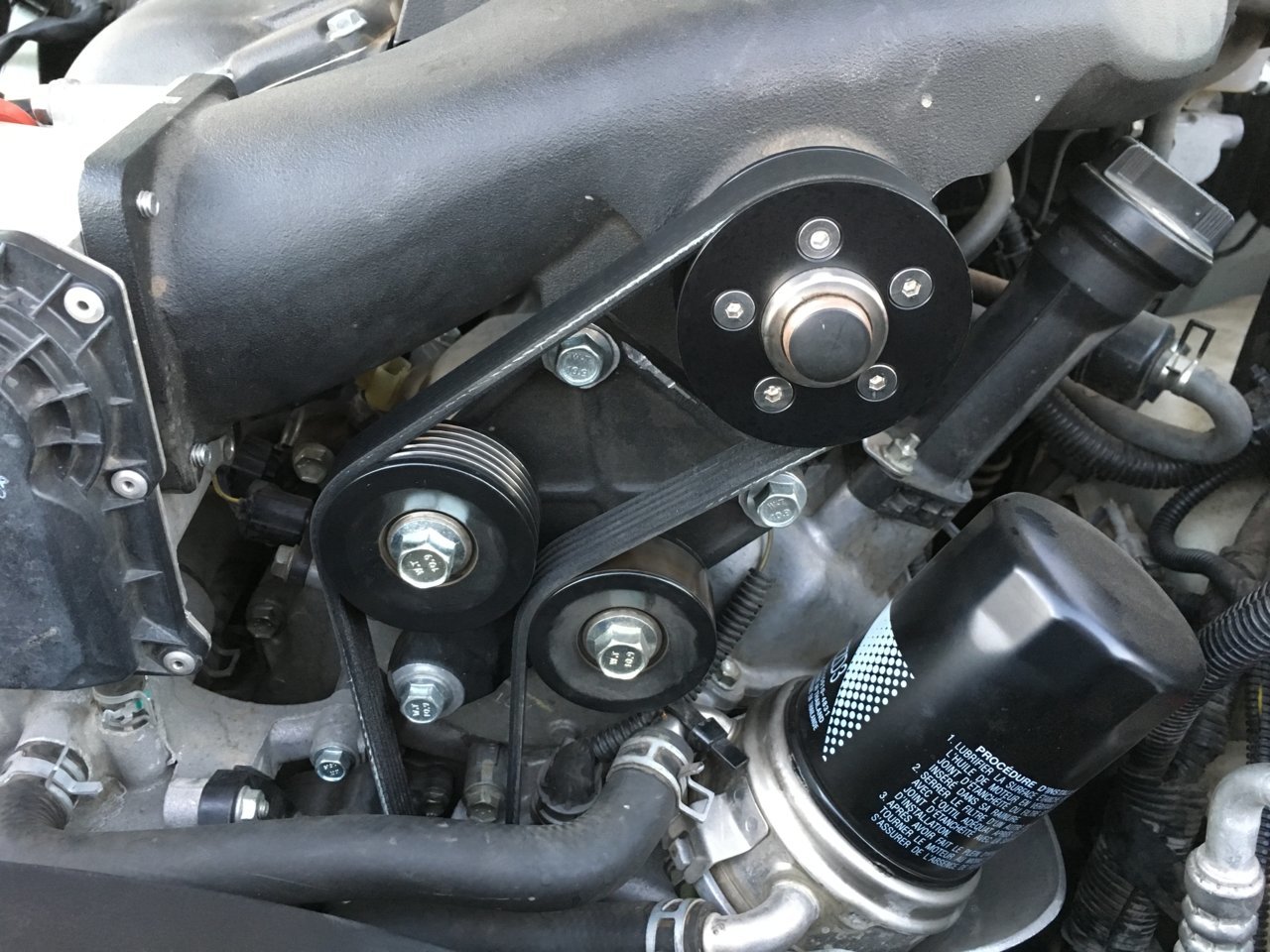

    Spent some time yesterday trying to maximize boost numbers.
    Clamped vacuum line to the bypass valve diaphragm.
    Double checked setscrew adjustment.
    Cleaned air filter (which, admittedly, was pretty filthy).
    Removed the bullshit carbon screen in the lid of the air filter housing.
    Wiped out the inside of the intake tube. Was covered in a thin film of super fine dust and oil.
    Cleaned the throttle body since I was there.
    Initial test drive around the block looked promising. Saw 8.5-ish psi on the gauge. A longer drive up the freeway revealed I’m pretty much no further ahead that I was. 7.5-8 psi during long 4th, 5th, and 6th gear pulls.
    At this point, I can only conclude that the belt is slipping. Which seems odd to me. Belt doesn’t appear glazed. No black dust anywhere. No squealing.

    We are with smaller pulleys getting slip. Even if it's a little. I tried to adjust my jfr pulley tighter for the first time since my 2.5 install. I screwed up and couldn't get it tight. A wot pull on the freeway and I swear I could SMELL belt slip. Its tight now. Whew.

    Ahh I see. Yeah I agree. It's been a party in here since the beginning. Always something going on. Okay, next steps to follow for you:
    - Check bypass valve adjustment and adjust if needed
    - Replace serpentine belt with a 69.56" Fleetrunner belt
    - Run Roostfactors belt wrap mod
    - This one is subjective to your own judgement, pull your restrictor jet
    Watch your boost numbers dramatically improve shortly after that.

    So in this discussion of belts, I went forward and ordered the Fleetrunner belt for the S/C drive for a 2.8 pulley. Any tips/tricks for getting a clean cut to remove the extra ribs? Razor knife vs metal shears vs hot knife....?
    Looking at the main drive belt, Gates provides a direct replacement that cross-references as
    Gates K070834 Multi V-Groove Belt.
    There is a fleetrunner belt K070834HD
    (https://www.gates.com/us/en/power-t...fleetrunner-micro-v-belts/p/p100278/v/9643353).
    Anyone know if this is also a compatible belt? I am assuming it is and the HD designation is reserved for the fleetrunner series belts, all else is the same.

    Stick to the belt I listed on page 1 for the proper length and numbered ribs if you want to run a Fleetrunner for your engine serpentine drive.
    This belt is NOT for your supercharger serpentine setup.
    Razor in a vice is the best bet, but it is very meticulous.

    I cut my belt using a razor knife and a kitchen cutting board. Cut on the v-side, go steady, and change blades often and you will be just fine.
