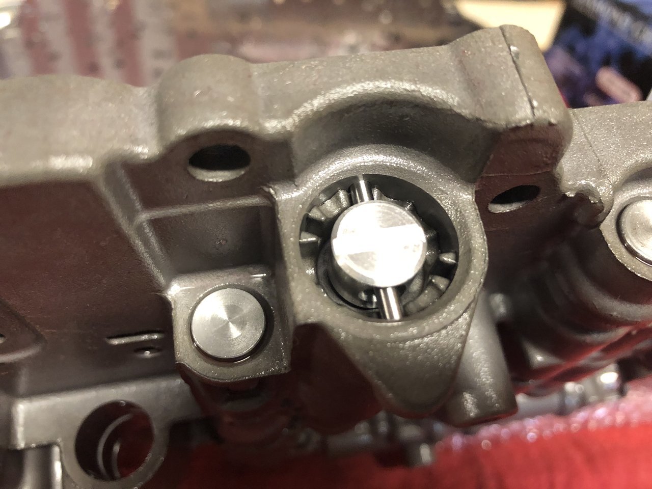

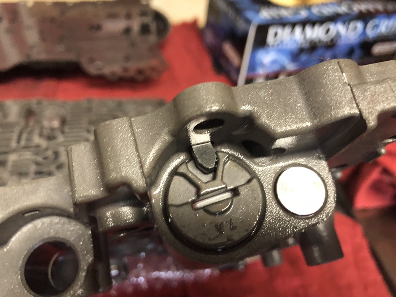

    Installed RatioTek shift kit and missed a step. Auto transmission is not in my wheel house. Decided to go for the IPT complete transmission route.
    When it shifts to 5th it just free revs. Pretty sure I know what I did wrong, but I'm not messing with it anymore until its out of the truck. Then it will either be a spare or I'll sell it.

    There may be some other issue as well, but I know for a fact that these are in the wrong positions.
    The first one is on the lower step (resulting in the piston being the farthest outward). The second one is on the lowest step (also resulting in the piston being the farthest outward)
    Pics below are of a brand new valve body from the dealer:
    343DABF6-EECA-4C34-876B-256FCD0A6229.jpg F08E9D35-7B89-4F2C-B4D3-C10644F7ABC0.jpg
    The RatioTek instructions say the middle notch on the 3-step and the other one on the position that results in the piston being the furthest inward.
    I was at work when I was doing it and several people were over pestering me about other shit and I wasn’t giving it my full attention.
    12TRDTacoma[OP] likes this.

    Yeah the position of that piston is paramount. The utmost care and attention is needed when you are performing delicate mods like this one. I hate it when people pester me and I am doing something tedious like this.
