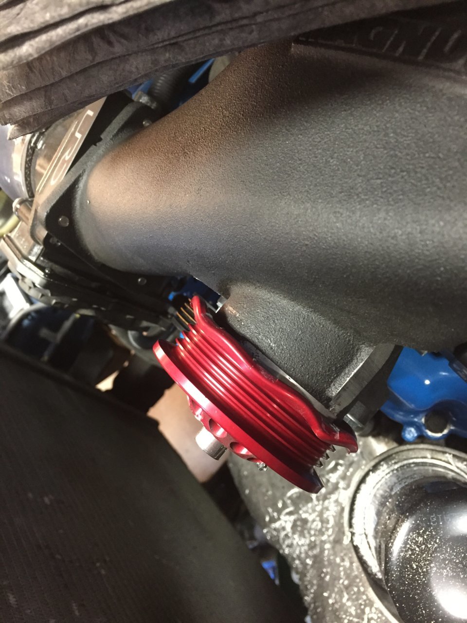

    Used a Craftsman 3/8" drive 1/2" socket to press against the shaft. Slightly smaller than the SC shaft. Nearly a perfect fit.
    FYI, I did use an impact gun on the puller and a prybar to counter-hold it so the thing wouldn't turn. As you can see in the pic, I did this before the blower was installed. Clearance for the puller and impact gun will be blocked by the radiator support if the supercharger is installed already.

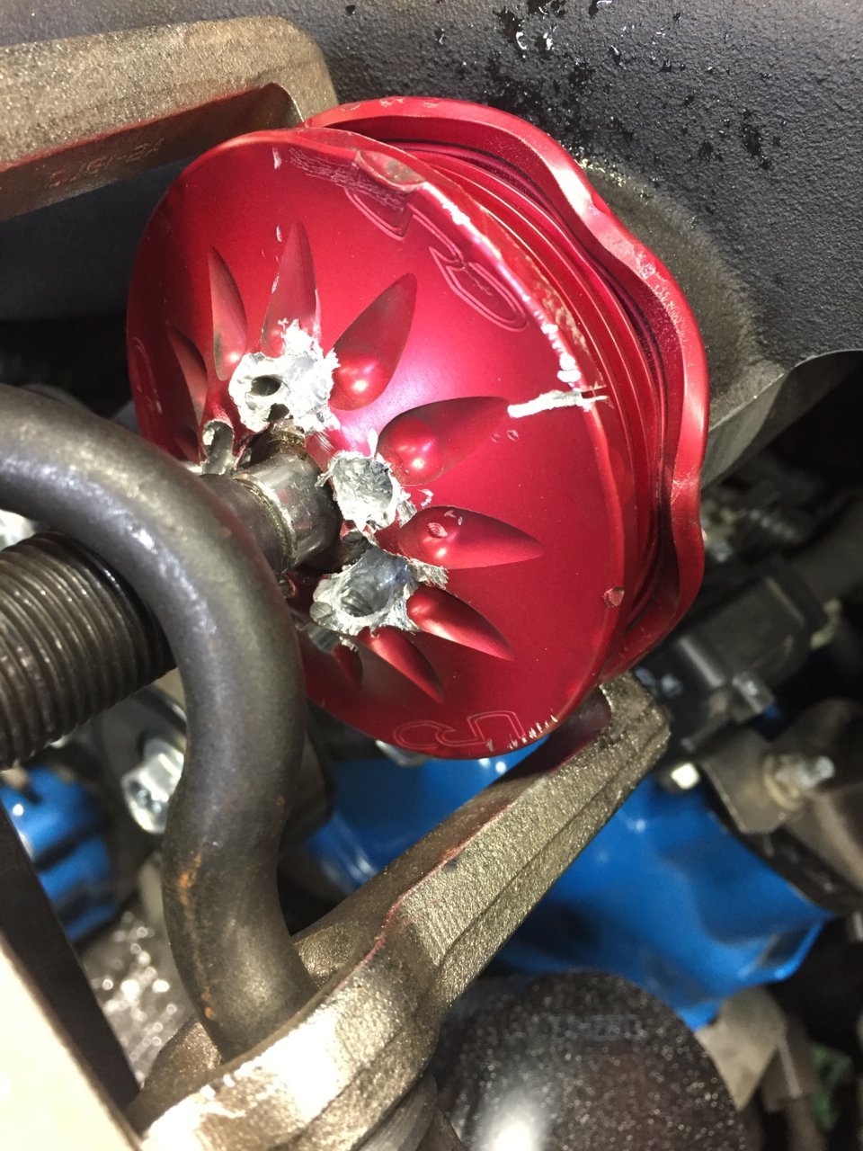

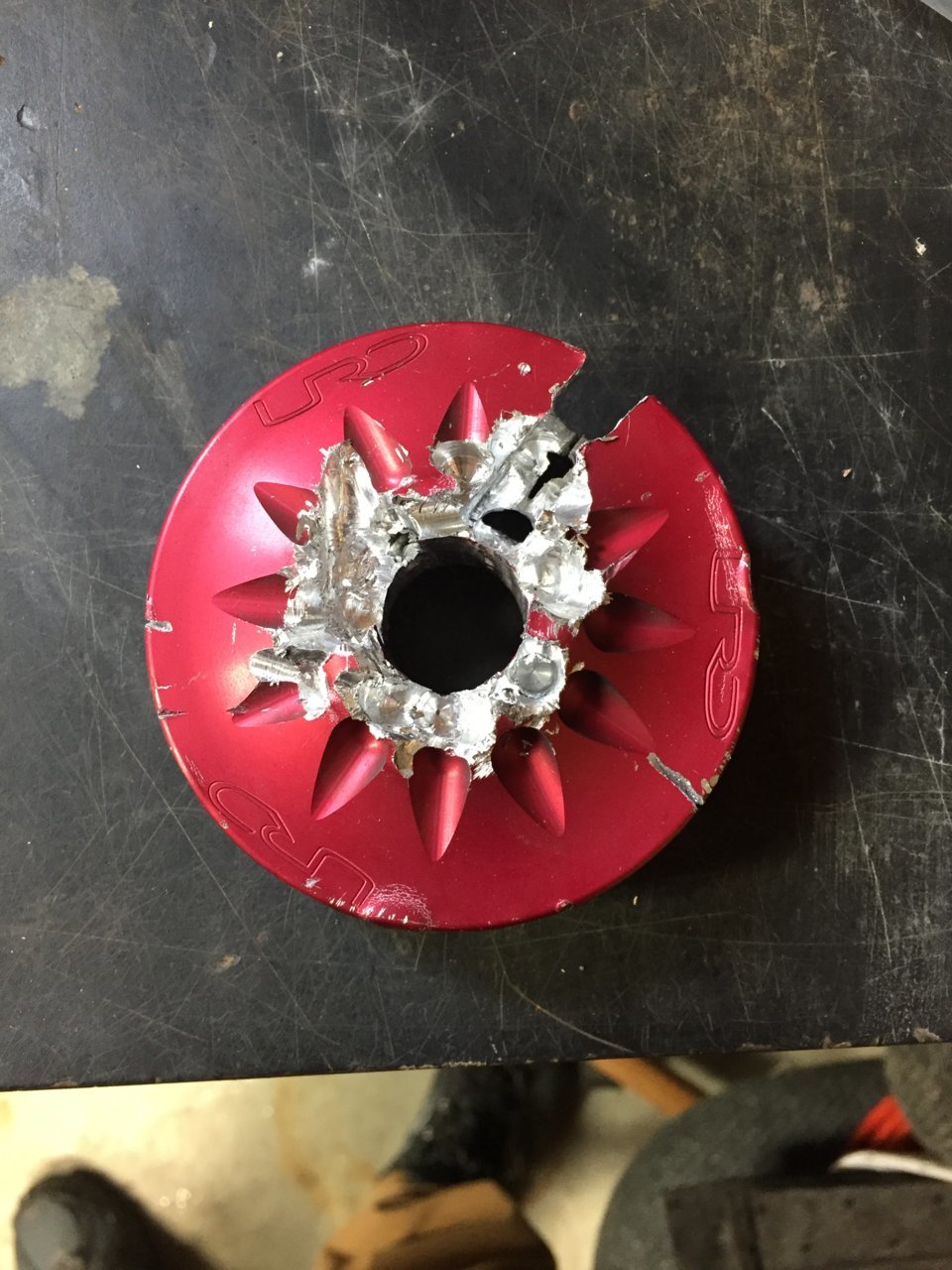

    01023431-BC5D-4F2D-ABBA-CA2B077DC8F4.jpg 0A41359B-0FA7-4F4E-B712-96F98C918FC4.jpg 41D613EA-7C2E-4984-8B67-CA6F2936CF98.jpg And then you can hack the sh!t out of it like me. Didn’t have a cut off wheel. Drill bits went to town.
  8. Dec 16, 2018 at 12:01 PM
    loginfailed
    loginfailed Well-Known Member
    Aug 29, 2016
    #195923
    5,156
    Dwayne
    Houston, TX
    2014 DCSB 4WD
    Looks like that took a minute, lol
