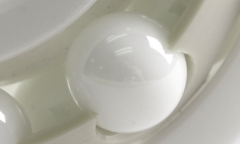

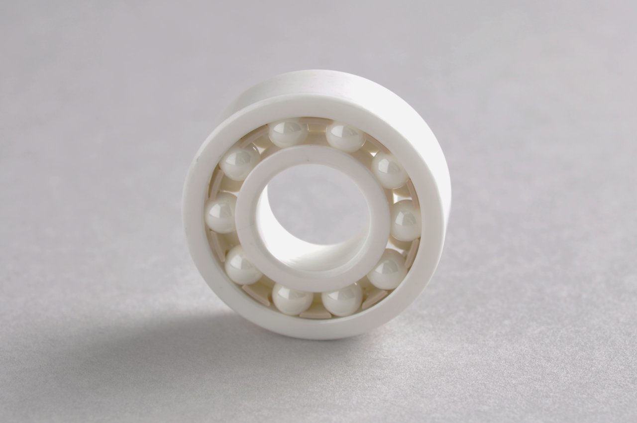

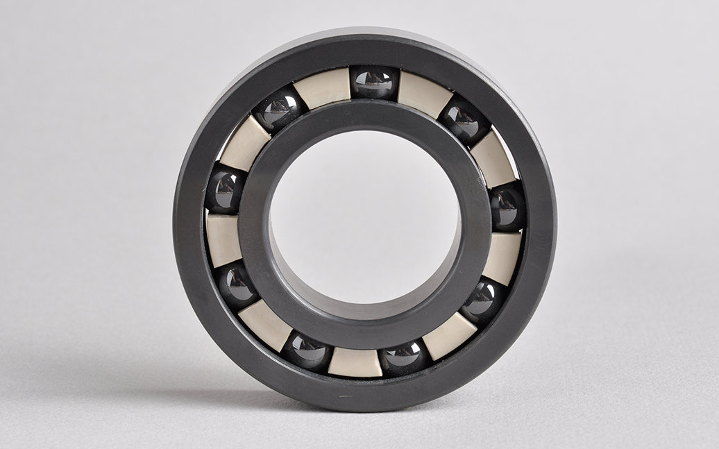

    I know ceramic bearings are used in the higher end space for the sportbike crew in things like BST carbon fiber wheels. I know I was eyeballing ceramic bearings when I was in the market for BSTs. Granted, in those applications the bearings don't see much dirt/mud due to the bikes being on a track, so the longevity is not questioned. Ceramic bearings could work but for now long? I'm no expert but I would bet if some mud got into a ceramic bearing it would self destruct after a little bit. If someone offered a manufacturer "sealed" ceramic bearing instead of the loose washer type seals, maybe that could work?

    Crazy how much more these bearings cost now than just 5 years ago. I’m not sure exactly, but I got a combination of microblue and new nsk bearings when installing all my nst pulleys. By all means, Nsk is a great bearing too. The type of grease you pack them with is just as important. :thumbsup:

    Click the link above. You can select your retainer, seal, lubricant, and bearing material.....Not saying I'm going to buy these, but they sure are pretty.
    Edit: AND they're assembled here in California, not a foreign factory. (I know some may consider California Foreign, but It's almost domestic)

    In all seriousness, I'm leaning towards the original NSK bearings... If I can find them. I've found some SKF's that look like they're good for the rpm. There's a lot of options in the 6303 chassis. Need to find some that are at a minimum ABEC 3 classification, and have reinforced or good PTFE/PEEK retainers so they will be good for 20,000 rpms. The NSK's would make things easier, if I can find them. If anyone is looking for them, the best search is to look for alternator bearings, they usually have the specifications required. I found some NAPA ones, but they are almost $50....makes me think seriously about ceramics.
