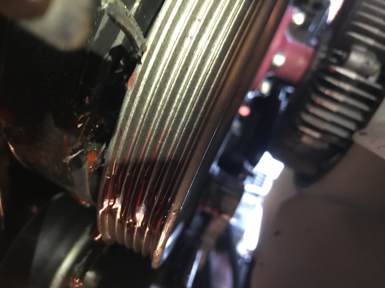

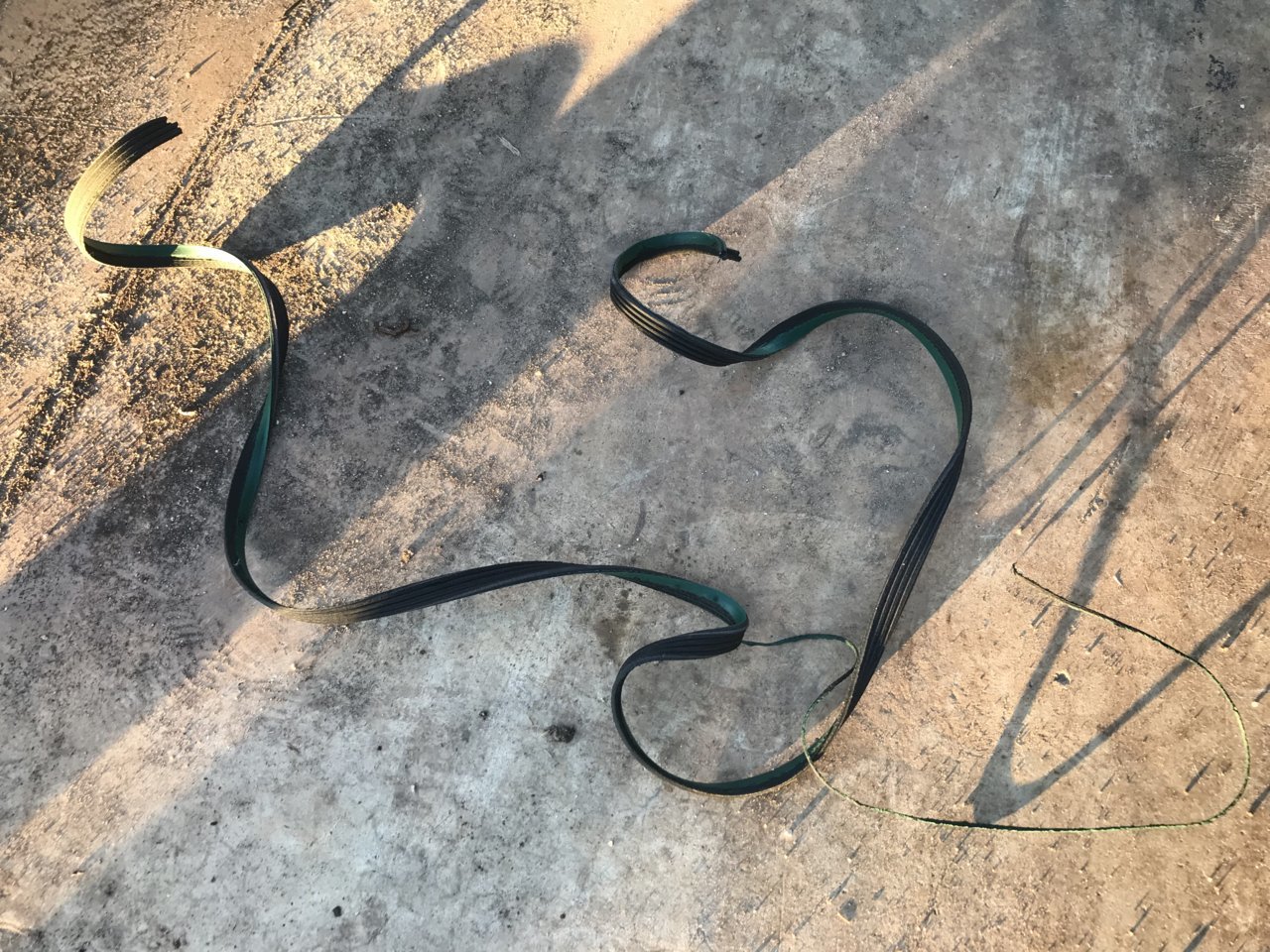

    Agreed, could've been way worse. Glad it was a pretty easy fix! Hope someone in here is able to avoid what I went through..

    So I have wondered this since the topic got started but figure it’s a really stupid question:
    When everyone is cutting ribs off the belts, all that’s happening is using a box cutter or super sharp blade to cut one of the troughs or low spots in the belt, all the way around correct?
    And does it matter if the cut edge is facing the engine vs the grill???
    Is there anything more to it?

    Yes that's correct!
    Doesn't matter, I've run them both ways
    Just make sure you get the edge you cut as flat (and similar to the side that wasn't cut) and you should be okay. That's where I screwed up
