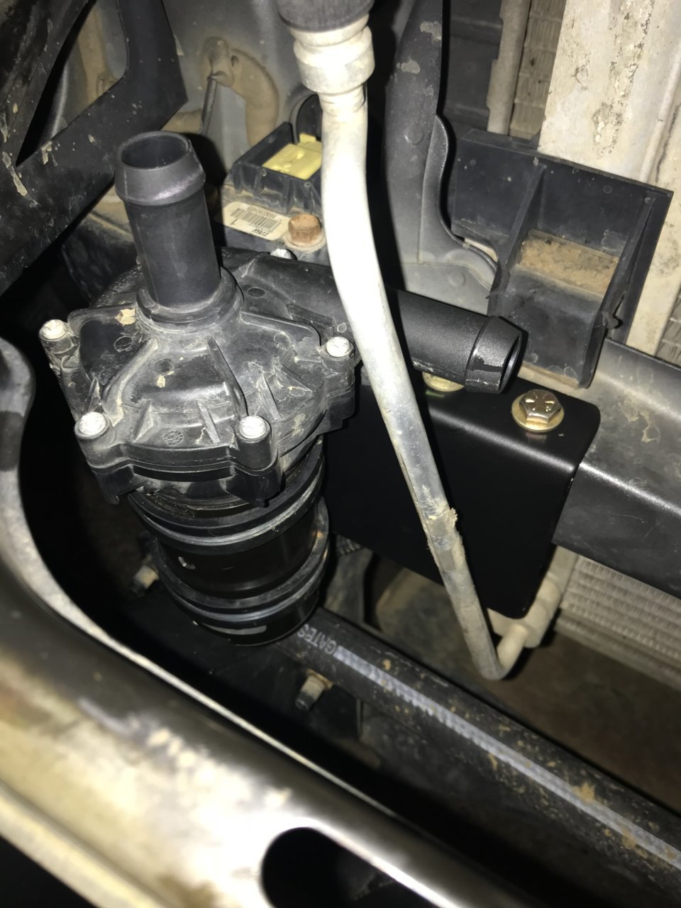

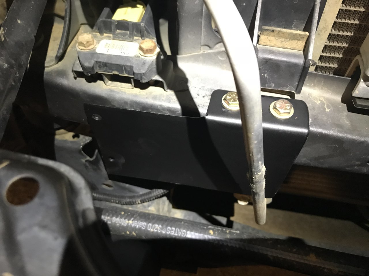

    Here was my fix. Cheap with a scrap sheet of metal. Had to get 2 bolts, 4 washers, and 2 nuts. Works prefect for my application :)

    Looks good! Did you extent the harness for the pump? Or were the leads long enough?

    Fortunately the harness reached with maybe 1/4” to spare. I would tell you that area is about as far as I’d take it, along that horizontal sub assembly cross member thing. The other benefit for me was my resi is located on the passenger whee well wall (opposite the original install instructions) which enabled me to run the “out hose” directly to the top of the pump, and the return line facing the firewall, to receive the coolant from the inter cooler. (If that makes sense)
