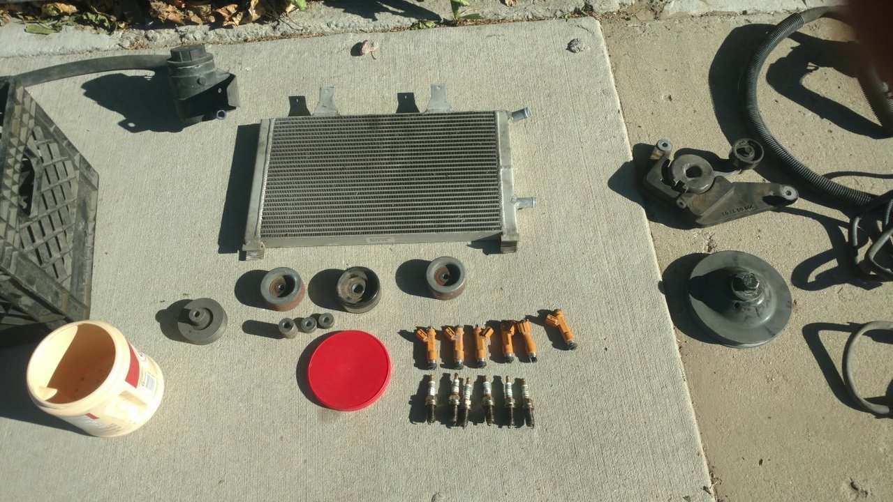

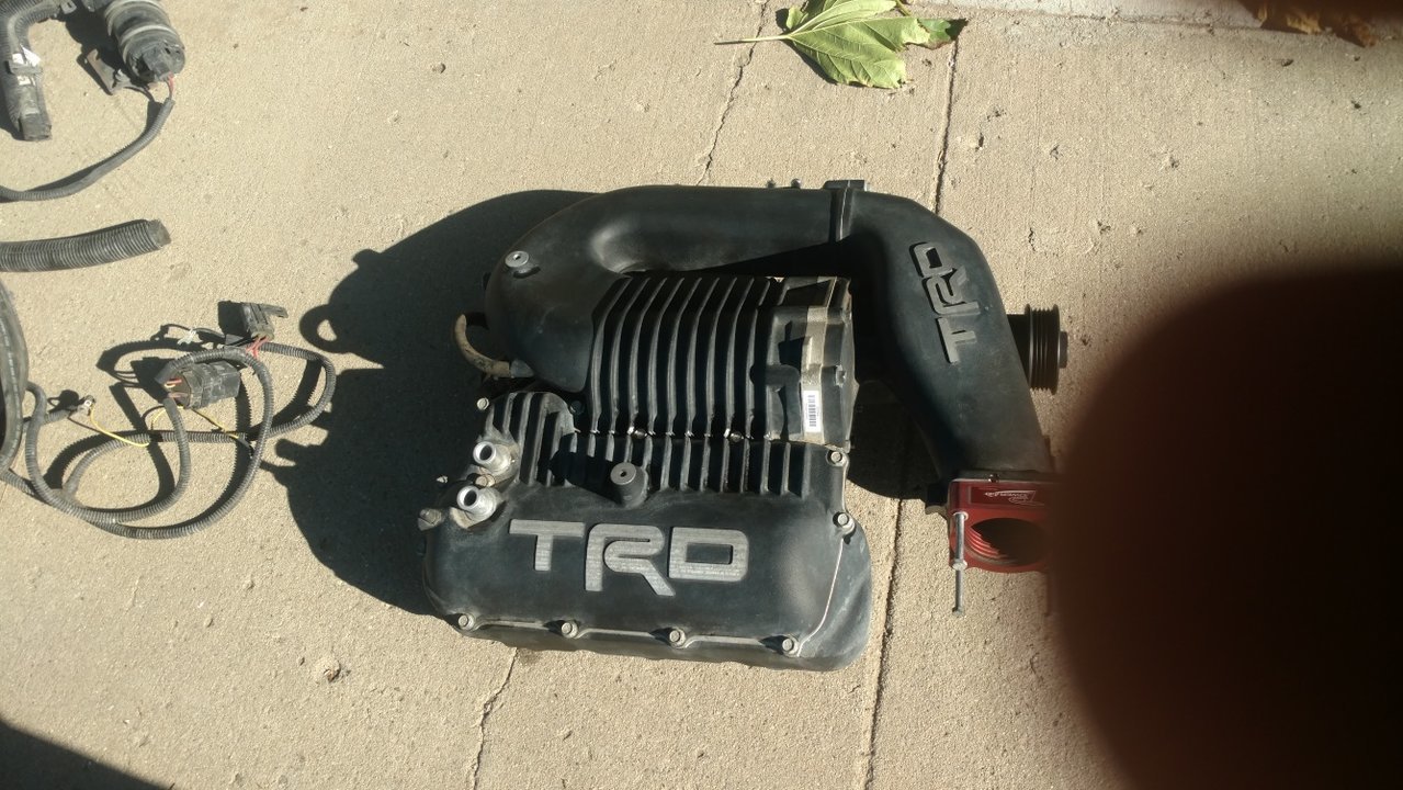

    I'm sure people know that the two items that make up the supercharger kit are:
    1. vehicle "Fit Kit"
    2. vehicle "supercharger kit"
    But, the supercharger kit/box isn't just a box that contains the Eaton M90 blower. It's the blower plus the vast assortment of other parts needed for the install.
    And the vehicle "fit kit" is actually the box with less components/parts. It only contains the intercooler/radiator bracket and a few misc items like the install manual/paperwork, etc.
    If the (OP) buys this used supercharger kit and it is missing parts.... it doesn't mean just buy the "fit kit" and you'll get all the necessary parts. The missing parts might be part of the supercharger box. And I wouldn't trust Toyota/TRD to be able to source and sell you individual parts from either kits.
    If you get a chance, look at the install book that comes with the kit and the parts description. It will list what parts are in which bag. And which bag is part of which of the two kits.
    Good luck.

    Maybe I left a few details out, Im not new to adding mods, at all.
    Also if it is indeed missing parts when I show up (I will have parts list in hand and will go over 1 by 1) I will just lowball him and if he doesn't want to sell it no big deal.
    I built up a 335i motor with ALL used parts, saved over 4k$ buying used (intake, meth injection, JB4 tuner, catless pipes, bigger IC etc...) and it was one of the strongest running motors I had ever worked with.
    Can't really understand how you could say "No install/mod ever goes as planned" like its a fact. I fully appreciate that things can and do go wrong, but I just have to disagree with that statement.
    Again I appreciate the input and I take what everyone says into consideration.
