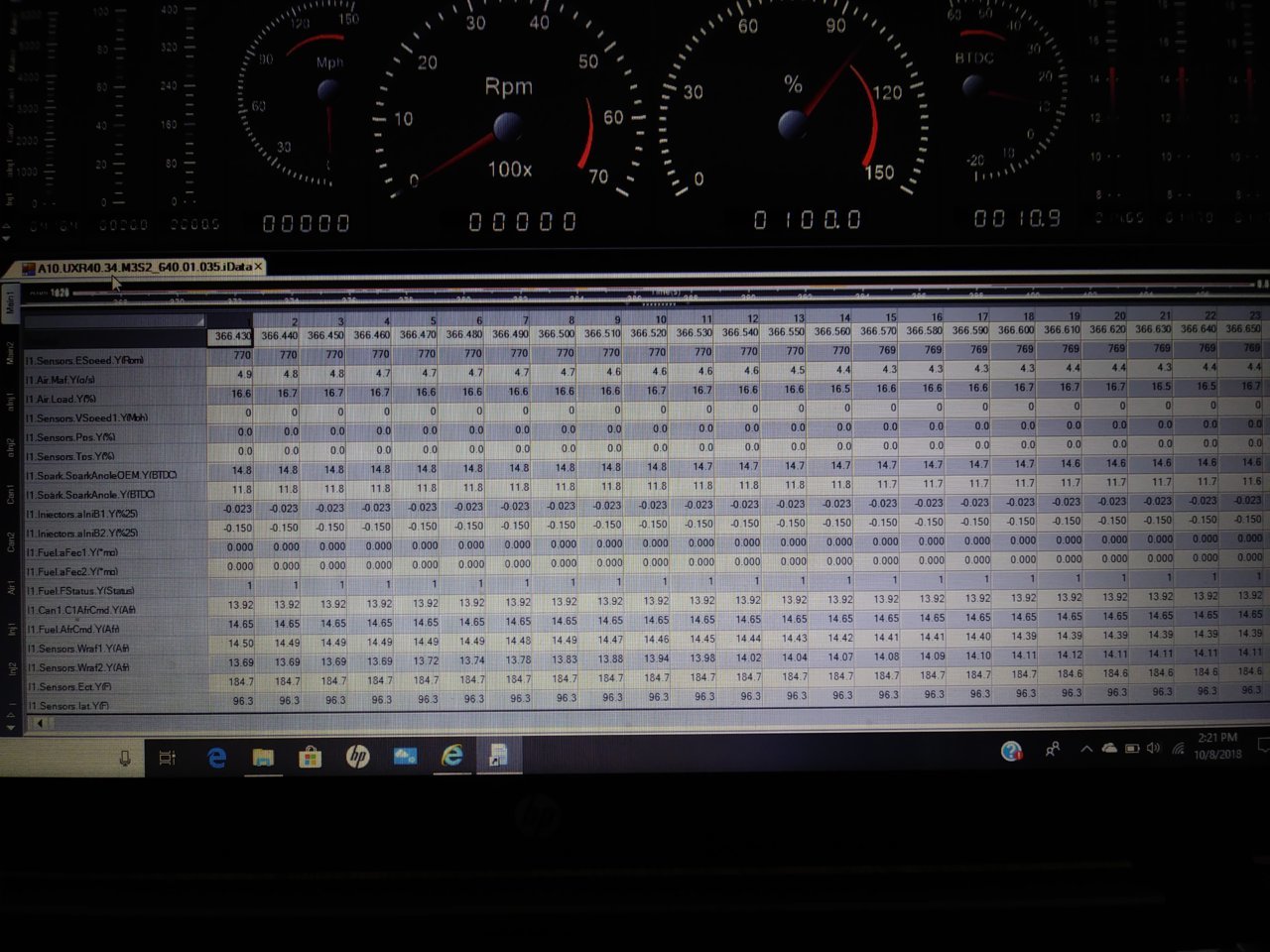

    Question for you all but going to do some research and testing tonight after work. So my trucks AFR's were doing great, Scott was even impressed with how well the truck ran for the amount of miles and how long I had been pig rich for. But then let the truck sit for a few days while life happens, and now it is pig rich again. Low 8's. Did my Ucon shit the bed? Going to plug in tonight and have my wife watch the target AFR and actual AFR using the Ucon datalog app hoping that it is just the new AEM AFR guage that didn't like sitting. Truck feels like it is running great. Loves the cold air. Vacuum is at -19 at idle so I don't suspect a vacuum leak. Also does anyone with the Ucon know for sure if I can actually watch the AFR in real time with the datalog app?

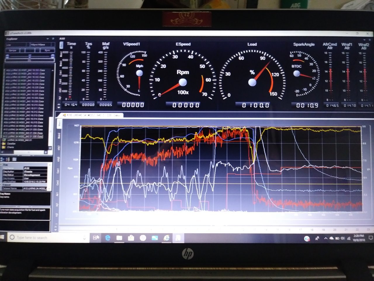

    For me it's easier to data log a sample and then look back. You can really focus on the anomalies or lack there of. However, I know you're trying to compare the Ucon's observed values versus your gauge. For that, can't you just use one of the gauge tables at the top to easily monitor it? I don't have my pc with me or I'd open it up and take a screen shot.
    IIRC, just to the left of the gauges, you can choose different groupings to look at.....

    Quoting an old post from N/Es06 that shows the gauges. To the left, is a selection tab system that should let you alternate between the live info being shown....I think this is what you're looking for. Look to the right in the first picture.

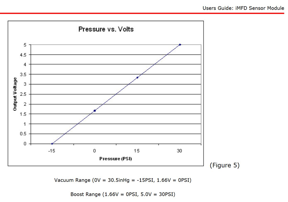

    Fellas,
    Looking for some input while I await a data log review by Scott.
    What could cause a boost gauge to read high? I am getting high boost spikes, very brief, on my PLX gauge.
    Normally I see up to 8.5lbs, over 9 on cold days. But I have been capturing max spikes of 12- 14psi?!?!
    I don't think the hose is getting pinched all of the sudden. So is it reading a voltage spike at the module due to failure...?
    Or am I having as actual event that is effecting the manifold pressure?
    Truck is not feeling strong, missing low end.

    A lot more info is needed.
    1. Mods (sc pulley, intake, exhaust, etc)
    2. Does it have any physical symptoms or is the only way you know it's happening through the PLX data?
    3. You say it is lacking low end, is this a new symptom?
    4. Have you changed anything recently that could potentially cause this?
    5. When is the boost spike occurring? When letting off throttle, at WOT, what RPM, etc?

    Probably nothing, but you have an '08. Have you checked your vacuum hoses? On the boost port, as well as everywhere else.
