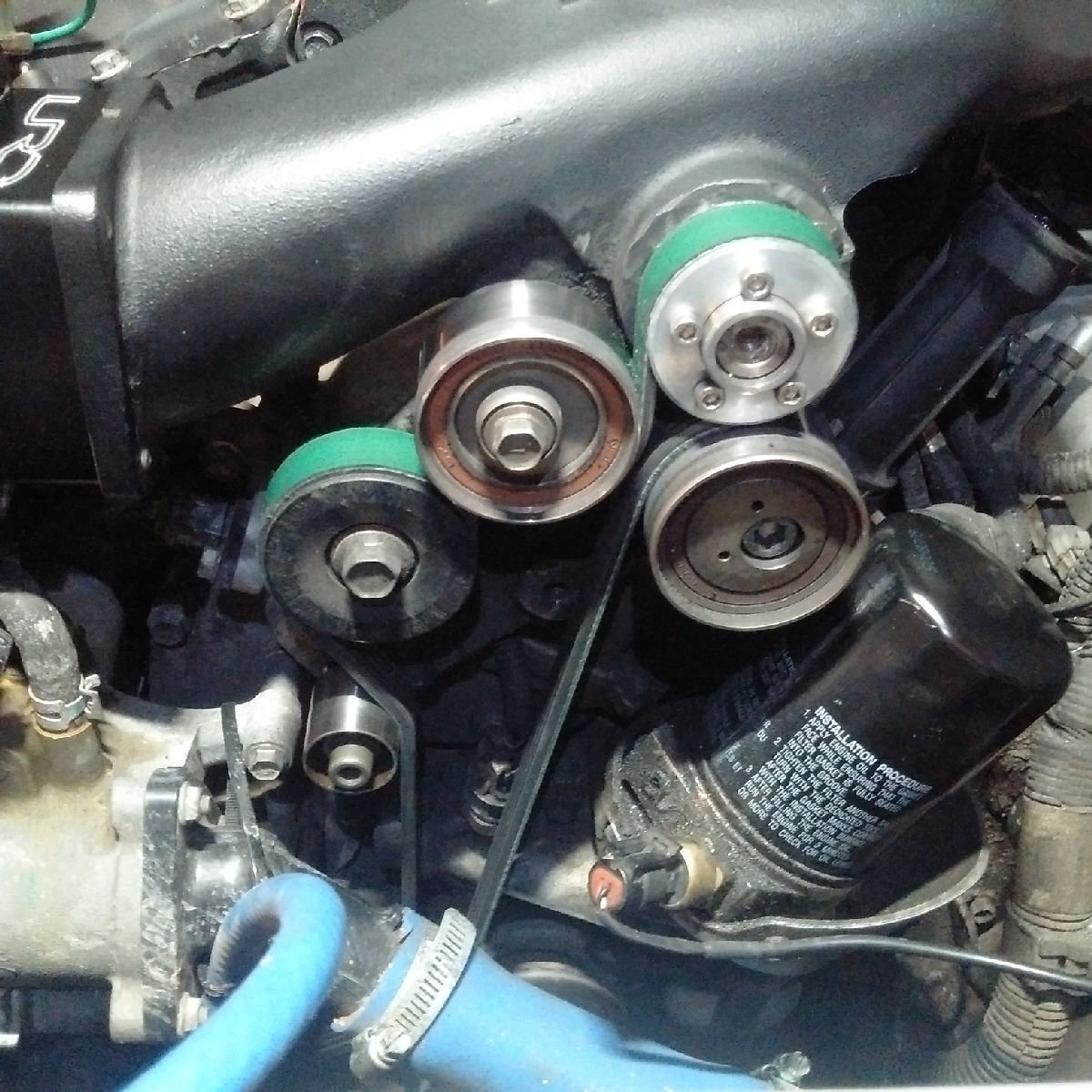

    Well, I went and did a pulley wrap thing. I wanted something between 38 and 42 mm in diameter to fit in this space. After much searching, I found a neat solution in an Audi/VW 1.8 timing belt idler. It's 40mm dia. I just chucked it up in the lathe and machined down the base to get it where I wanted it. The Gates RPM belt worked out perfectly with the 2.5" pulley.
    Been a couple weeks. No problems so far. The bad news is that the boost didn't go up. So, I guess it wasn't slipping after all.
    And yes, I plan to upgrade the bolt. Actually I'm going to a stud/nut arrangement. But the stud backordered on me.

    Here you go guys, this is the 1.87" by Smoothflow Pulleys. Custom job just for me, with the RIP mod as well. I put in my roush tensioner too, and it's at around 20% from max, which is about as tense as I want to go.
    So far we seem to be seeing another 1psi in all conditions over the 2.0" pulley. I will be monitoring belt dust for a while but I've already put 200 million revolutions on the supercharger with this pulley (napkin calculation) and I've seen only a tiny bit. Nothing, actually, for the past couple of days, so perhaps the belt has broken in or something.
    Norton, SUMOTNK, BassAckwards and 4 others like this.

    That looks awesome man! Sorry to release my picture right as you did.

    That's quite the pulley. And the pulley noose mod!

    I love that name for it!

    This looks great! Did you have to install anything special for it? Longer bolt, rear spacer or anything?

    you'll love it. boost, with 4.56's is awesome. plus a valve body upgrade.. mmmmhhmmmm. I love the low end my truck has. thats all im building it for. off the line power. and it has it.
    that came out awesome man! sucks that wasnt your cause for boost loss... but one thing less to worry about now. so.. back to vacuum leaks?
    holy hell thats awesome man!
