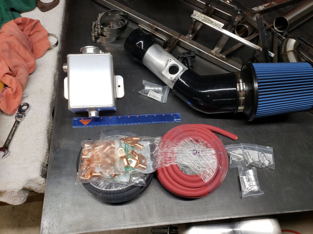

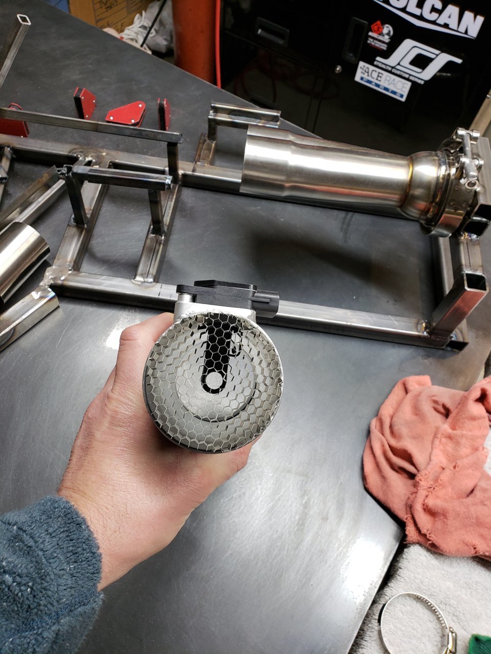

    Here is the maf flange and airflow straightener.
    I still need to epoxy the airflow straightener.
    The reservoir will have the inlet on the right side and the outlet is on the bottom.
    The various weld on barbs will be used for the reservoir and vacuum ports since the inlet part of the factory sc with the vacuum barbs will be removed.

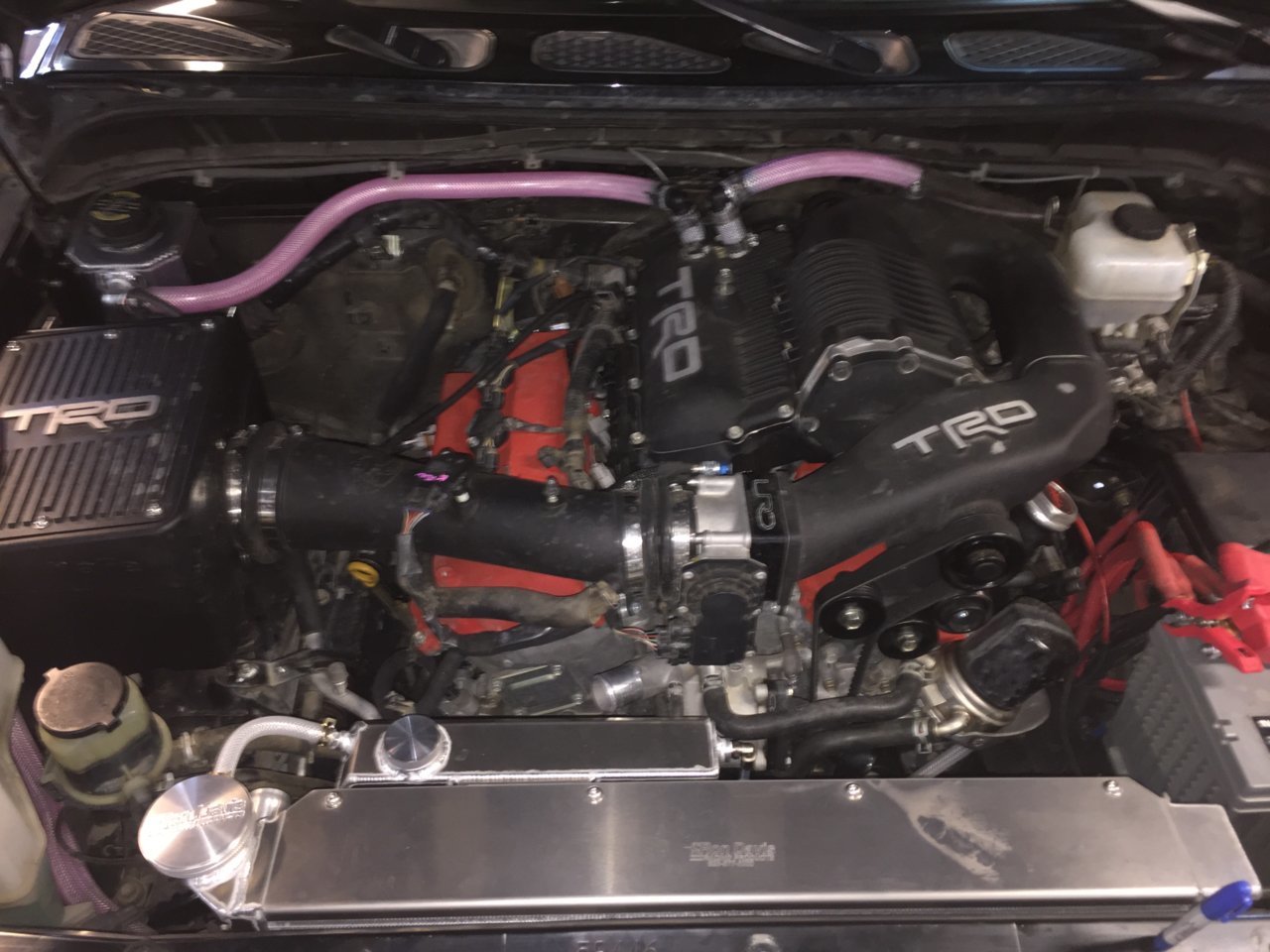

    Velocity stack won’t fit?

    Any of you guys ever use the borla or magnaflow dual/dual mufflers? I’m considering replacing my x pipe with one of those. In the unlikely scenario I do get popped I’d like them to not know about everything else on my car.
    Current setup
    And from the outside

    Velocity stack is integrated in the filter.

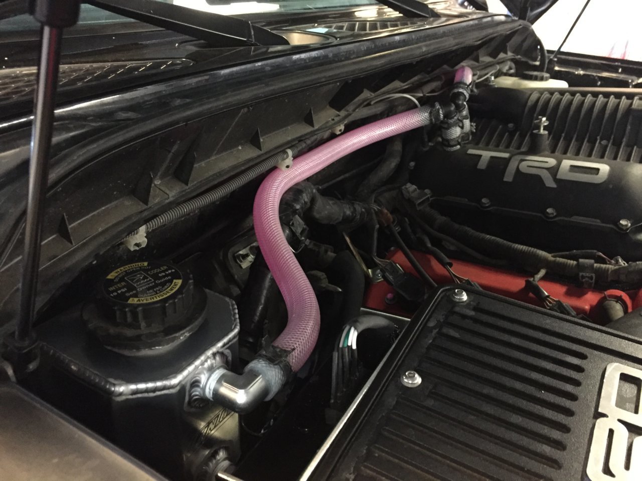

    I’m loving the commitment to your approach Roost. I just relocated my intercooler reservoir to the passengers side as well. Also moved the intercooler pump to the passengers side of the bumper. On a side note, found out the intercooler pump has a standard Bosch ev1 connector like the fuel injectors, so I was able to buy a connector kit with loose pins and cable seals to extend the wires without an extra set of butt connectors. Plus it has a water resistant cover and spring loaded retainer, which is way nicer than the plastic retainer clips that I broke.
    https://www.amazon.com/gp/aw/d/B07C7QSQBY?psc=1&ref=ppx_pop_mob_b_pd_title
    Roost, I have a couple left if you want a set for your relocation. Also have a 6” pigtail if someone wants it.

    HPT/justDSM tuned factory ecu, URD Headers, JFR Y-Pipe/l 3" exhaust, Walbro 255 fuel pump, Maggy SC (JFR ported), JFR ported lower intake manifold, 76mm tb, 2.5 pulley, 640cc injectors, CSF Radiator, custom electric fan wit Autocoolguy controller, JFR SC pulley wrap mod
    Thanks man!
    I just ordered them for $7. Great find!
    I think I am going to route both coolant lines to the passenger side and also rotate the fmic 180° so the lines come out the passenger side. I will of course have to relocate the mounting brackets to fit it in correctly.
    I plan on my secondary injection pump, reservoir, and catch can to go in the same general area of where you put your catch can.
