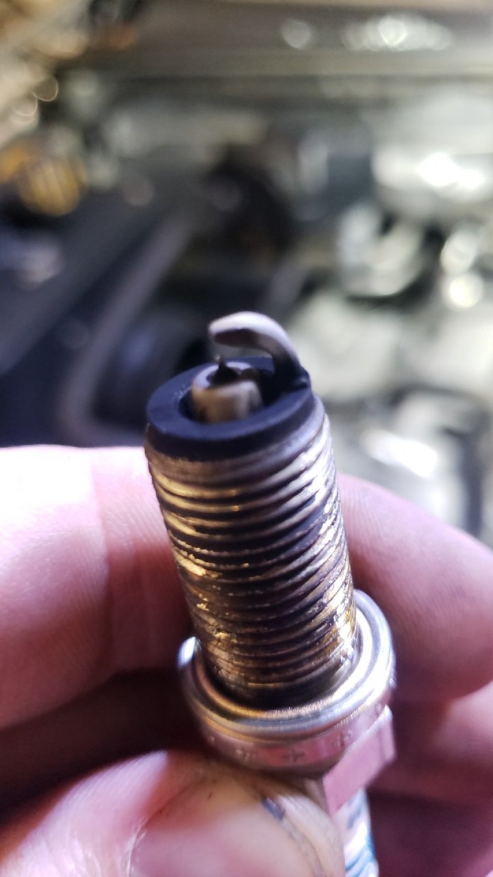

    I knew someone would ask for info I don't yet have... Haven't gotten around to installing gauges yet. :anonymous:
    Based on what I see and smell, not to mention my altitude (that sucks away ~3lbs of boost), I'm confident it was (and still is) running rich.

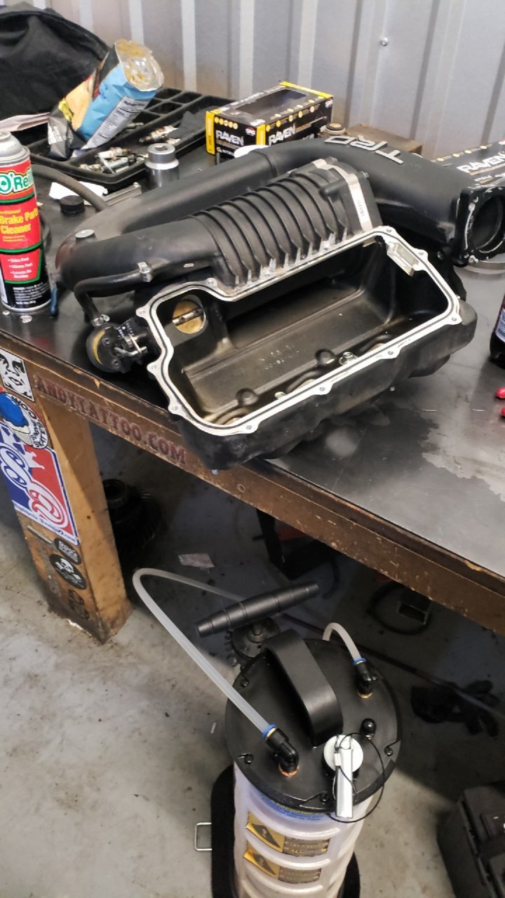

    What is everyones thoughts on using a small amount of rtv to seal up a small leak on my intercooler lid until the new o-ring comes in?

    No issue. Did you find something?

    Yessir small leak on the front side. Heres the quote from your ypipe thread

    43929B9A-646B-4BD3-8FDC-3FE9423D0A23.jpg Bypass on mine closes tight from the factory.
    Edit: I was pleased to see the internals including the intercooler looked clean of oil. Catch can appears to be doing it’s job. Gasket did appear hard and perhaps a point of a small amount of bypass.

    Plugs looked a little rich to me. New pulley should fix that.
