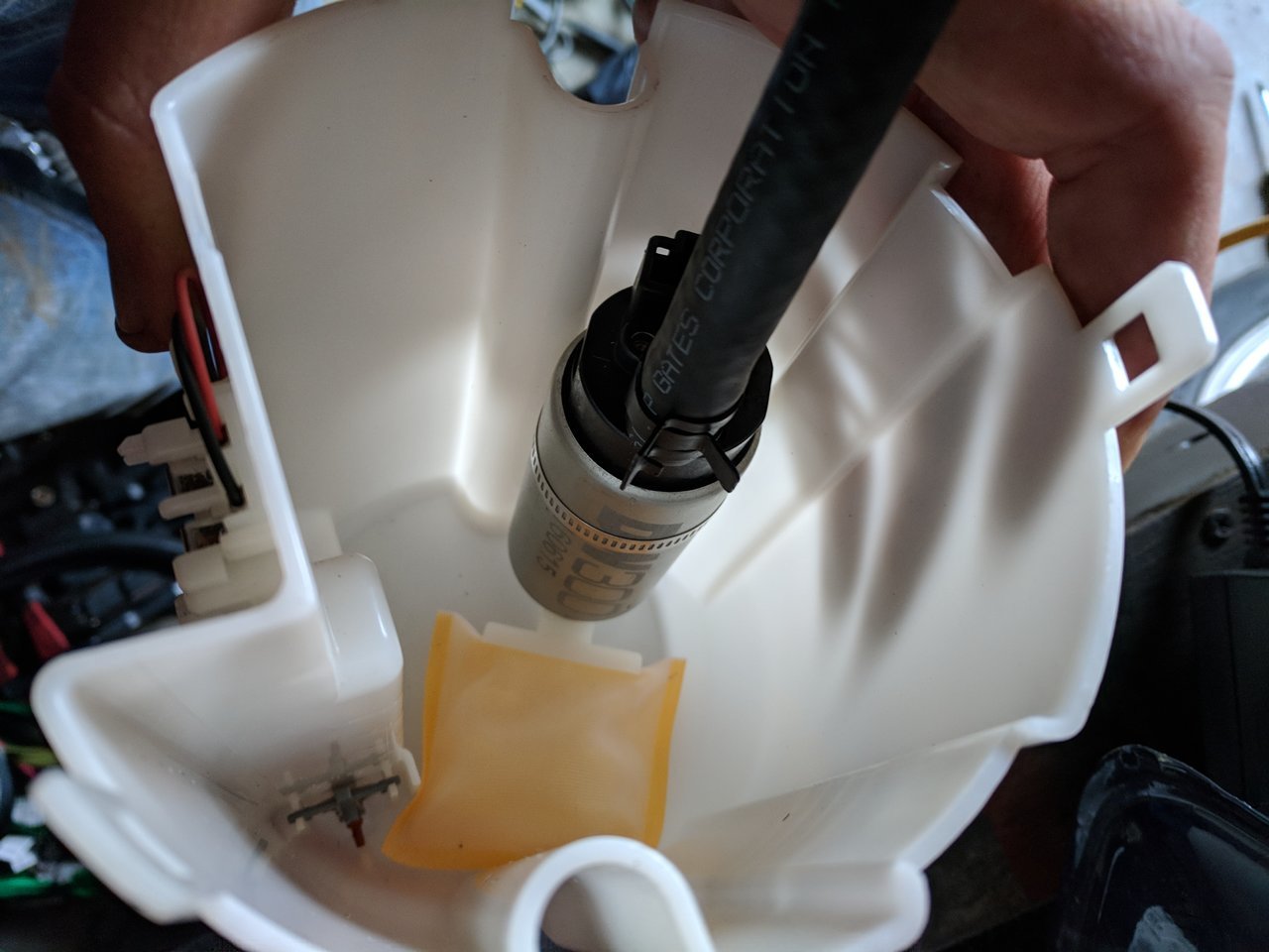

    @Skootter14 - Thanks - Appreciate that. I've done all the obvious stuff (removing the tank and getting the fuel pump assy out of the tank) I'm looking how to do the UPGRADE - stuff this 10 lb pump (new, upgraded pump) into the 5lb bag (the OEM plastic housing). Thanks again.

    it is larger, but will fit - no issues. I think other members have used that same AEM pump. you really just metal zip tie to the wall of the "cup" after cutting two slits in the cup. the URD install kit has pictures and everything of what exactly to do. Cant find the instructions right now, may have thrown them away after I did the install (also another good reason to go with the URD upgrade kit, but I know you're passed that bridge haha).

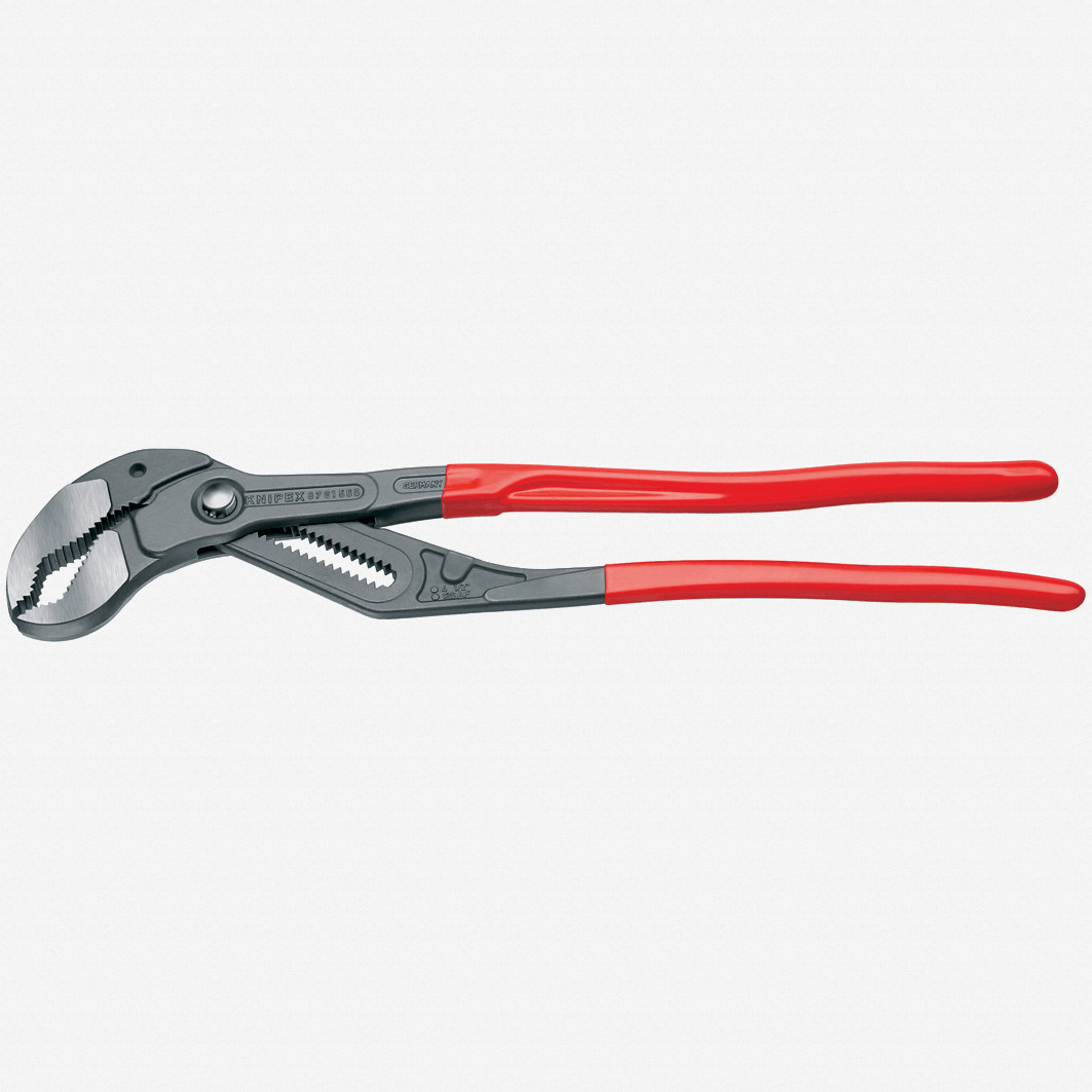

    My ”STT”, Knipex 22” pliers:
    Works fine.

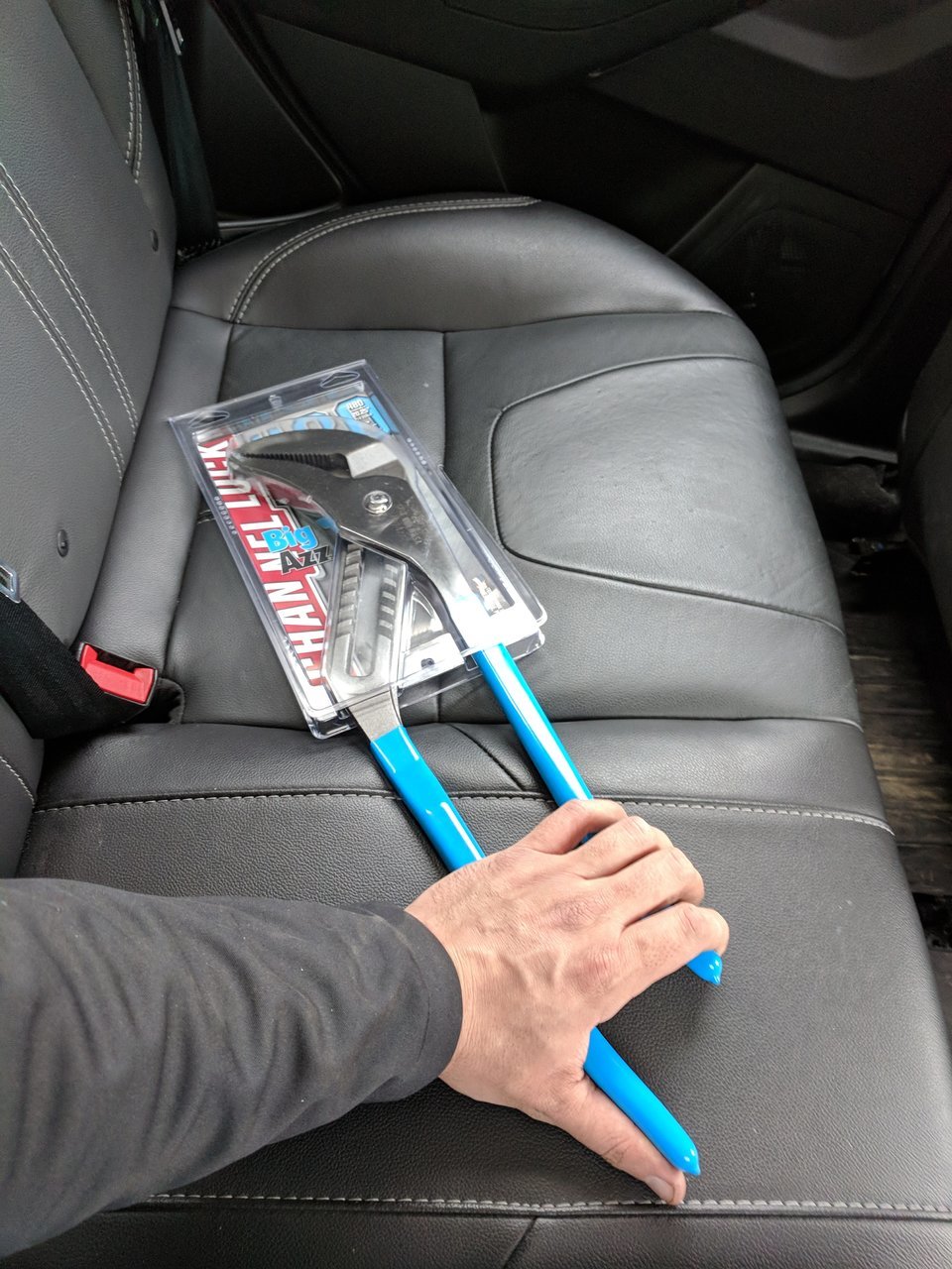

    Yeah I tried that method and just kept breaking teeth off the damn ring. Ended up taking an uber to the hardware store to pick up a pair of these:
    Also if it helps this is how my fuel pump sat in my 2nd gen:

    I use a large flat head screw driver. Marking the location prior to looseing. Then carefully tap it free.

    If you have access to a welder, that tool I made took all of 15 minutes to make and it worked perfectly. I am confident it will make installation a breeze too. :)

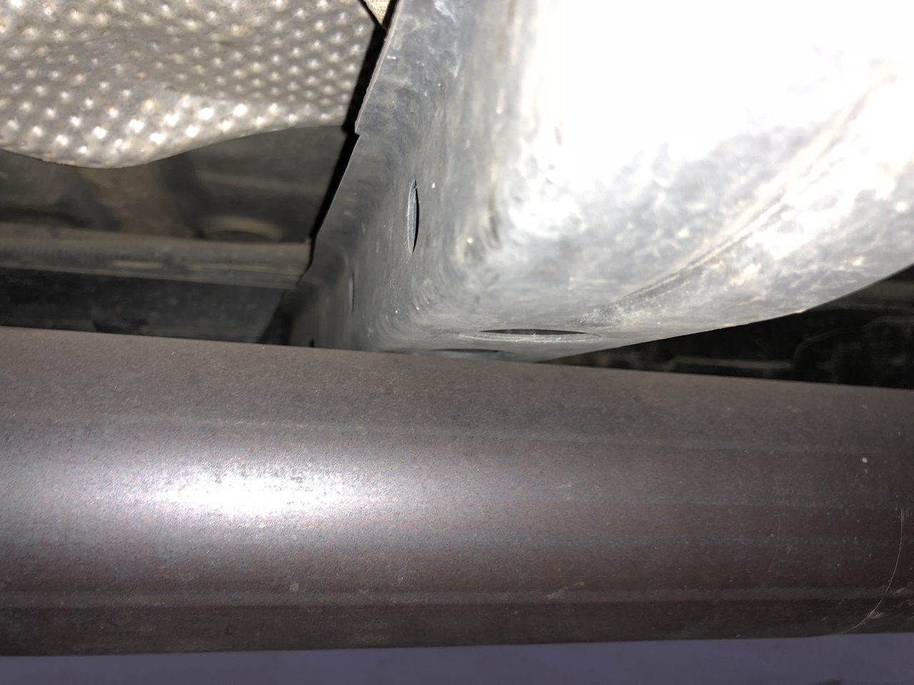

    Have any of you guys with a urd ypipe and a 3” exhaust been having any issues with the cat back rubbing on the carrier bearing cross member?1F465548-4C71-4A33-9842-C6172EAB9498.jpg
    At super low rpm, usually when I’m turning and just creeping up I am getting vibration. Just started happening after I installed my ypipe. I figure if anyone here would have any ideas as to why this is happening it would be yall in this thread.

    What type of headers do you have?

    Jba shortie headers with the cats welded on.
    And the shop that installed them forgot to install the driverside support that mounts to the transmission. I plan on buying that from toyota to see if it makes a difference

    I'd bet good money, that is a good portion of the reason why things are so close now.

    Too bad you don't have a welder and a band saw. The gap of a 90% cut through the bends in the headers, would be about 1/16". Welded back together, and you'd have your clearance.
