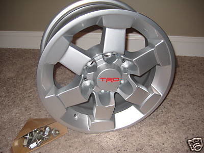

    While not widened, a few of the FJ guys with the original trail teams wheels were adding bead locks to them. They looked sweet and subtle. Frankly, I wouldn't have an issue running a large 315 on stock 7" wheel width.....
    Started with this:
    with bead locks:
    Or:
