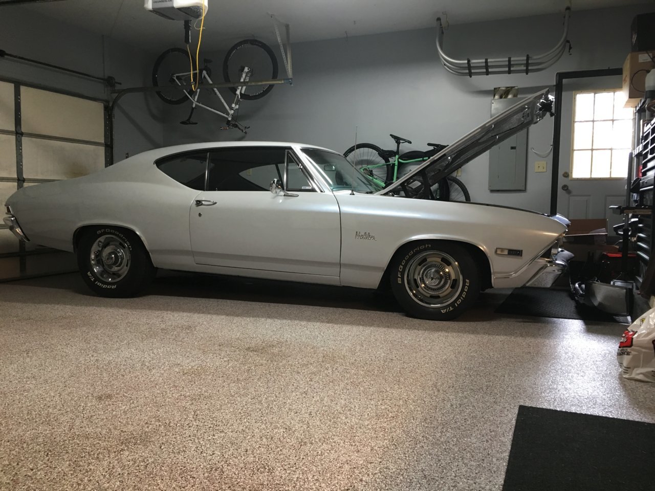

    mr.trd, Skootter14, RyanL and 6 others like this.

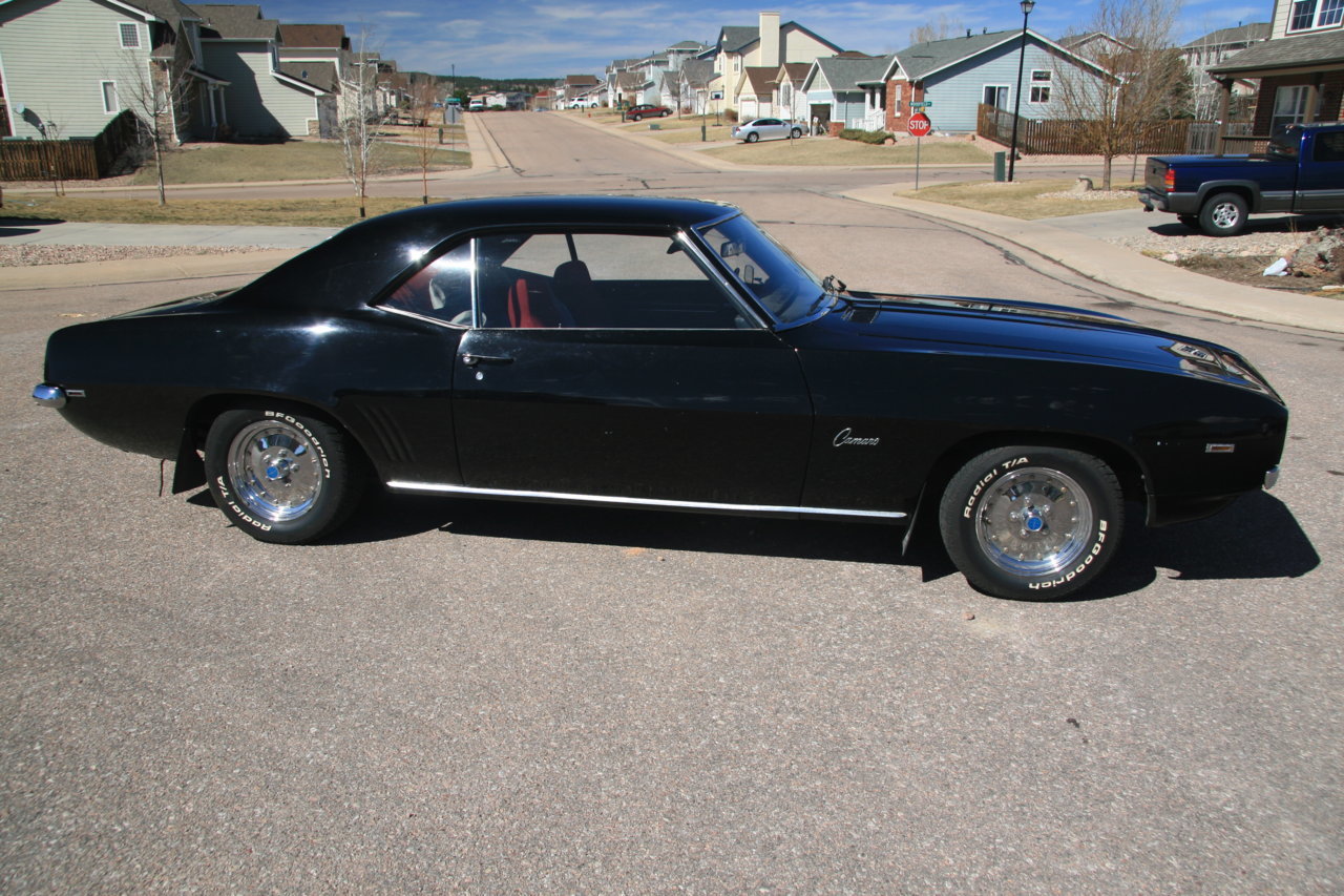

    NICE! THAT is what I'm talking about! (My first car was a '69 Camaro, base model only so no Rally wheels for me, but I always wanted them.) Settled for Cragar SSTs...

    Do you still have it?

    Sadly, no. It had a lot of sentimental value but, having spent the first 30yrs of its life on the east coast, there was too much rust underneath to undertake the restoral I always planned to do - by the time I upgraded the stuff I wanted to upgrade and replaced the stuff that needed replacing, the shop told me I'd buy an entirely new car one piece at-a-time. After much deliberation, I sold it and my '97 Mustang Cobra to make room for a '13 GT500. I still miss the Camaro, but the Shelby is a decent consolation prize...

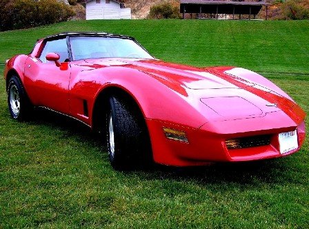

    Now we're talking! First car I ever bought was a C3 Corvette, all stock. Did the engine, trans, rear end, suspension, exhaust, etc. over the years ... man that thing was fun.
    There's nothing like the rumble of a V8. Have you guys heard how laughable the new Raptors sound??
