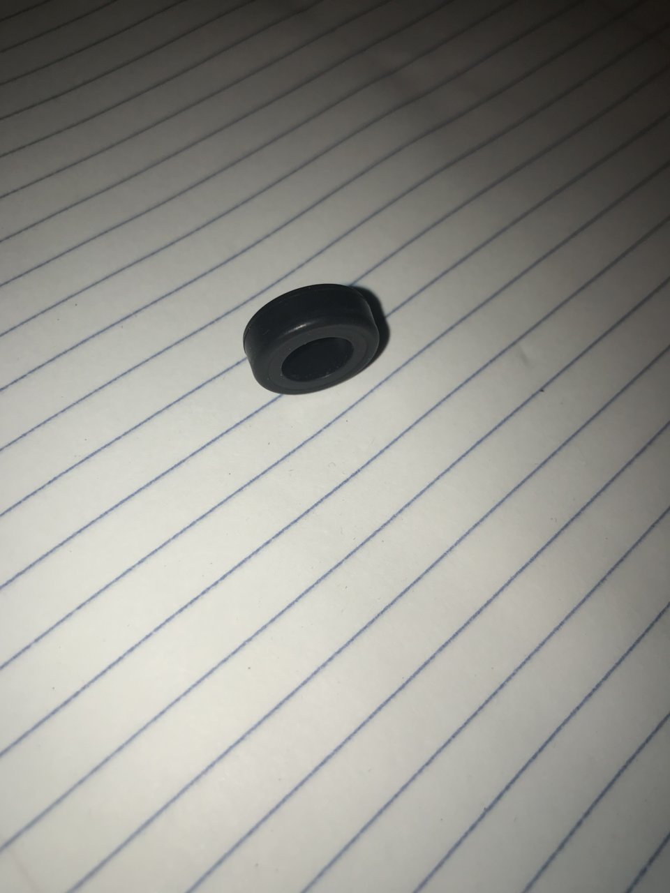

    Does anyone know if the injector port insulators/dampers are supposed to be installed only one way? It seems uniform in size (doesnt taper out on one end), but there is a little edge on one side. I think that may be from the mold when it was made but i want to make sure i dont install these upside down on my injectors. Anyone have knowledge on this?

    I think there is directionality to them. I matched the injectors that I removed. Can’t remember the orientation at the moment. I can go take a picture of the ones I removed from a perfectly stock truck.

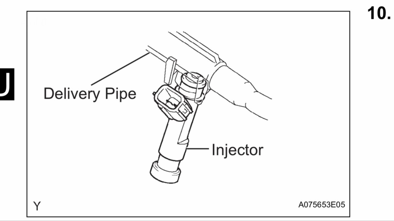

    This is out of the FSM, and it makes me think the edge should be towards the top of the injector, but it never specifies it anywhere in there

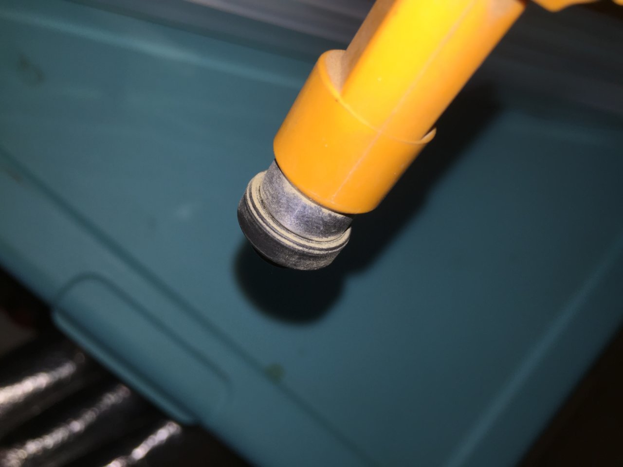

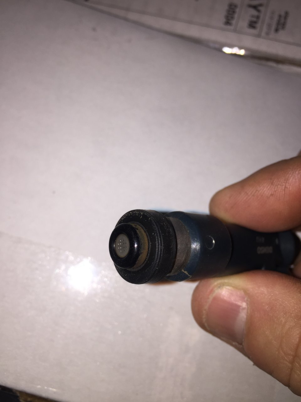

    Alright so here’s what I got. The dealership that installed the TRD supercharger installed the groove side up away from the engine. The factory injectors from my 60k take out (that I believe to be undisturbed has the groove side down toward the engine. Because they were consistent and from the factory, that’s what I’ve matched with my 62#/hr injectors. So....maybe it doesn’t matter.4AF460CA-B318-4265-A7FC-D6945BF8185D.jpg16384981-7C09-409D-8396-599775992993.jpg

    I did mine with the lip at the top. I figure it's there as a secondary dust type seal.
