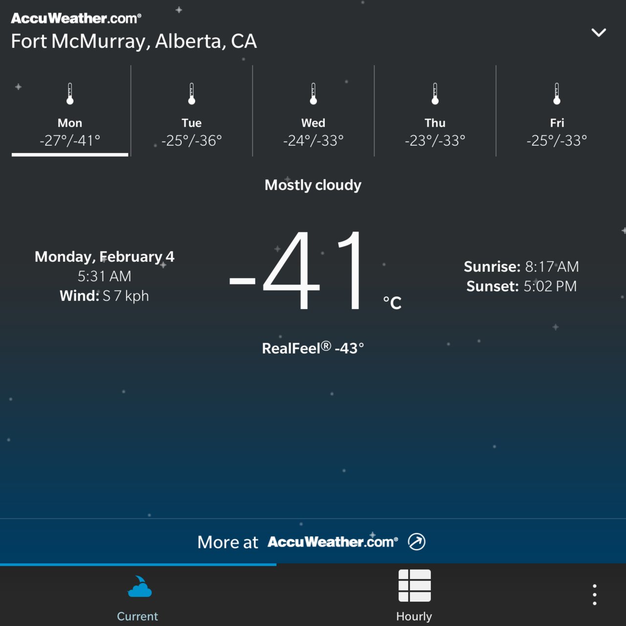

    Boost weather. Vive le Nord

    I wouldn't be able to survive in that weather:anonymous:
