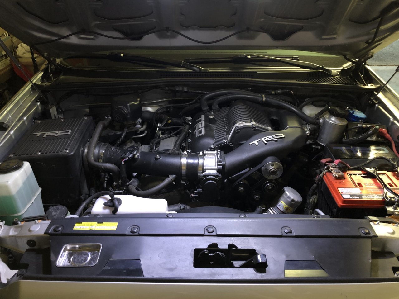

    Hard to see, but I have @Roostfactor pulley wrap and the RIP mod too.

    Looking good! A Roostfactor idler is one of the next things on my list, just been super busy lately. Finally having some time to troubleshoot the small stuff now
