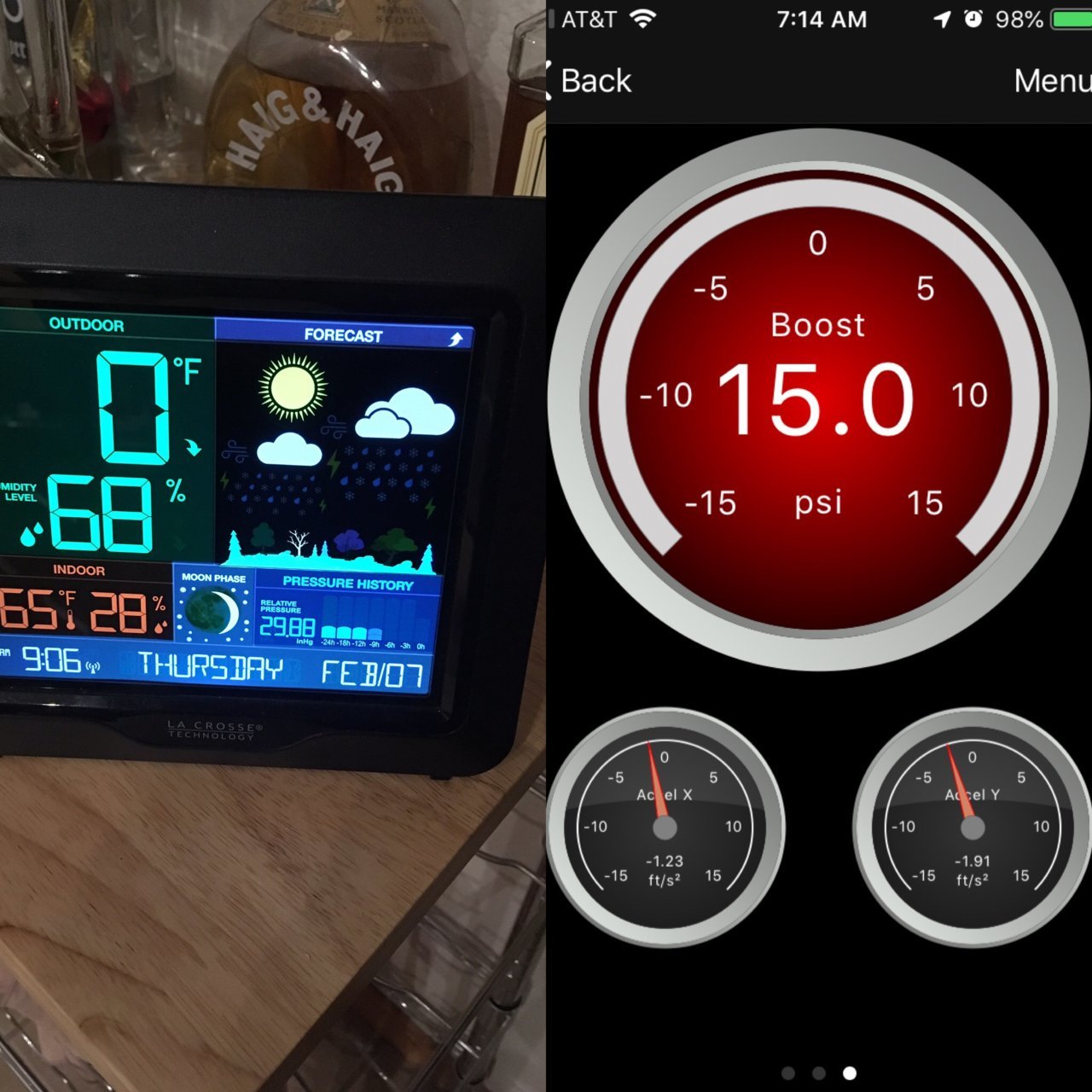

  8. Feb 7, 2019 at 6:20 AM
    snowsk8air2
    snowsk8air2 how hard can it be?
    Sep 16, 2011
    #63607
    10,493
    Flagstaff, AZ
    Supercharged TX Pro
    2011 S/C and basic mods
    This mornings temp vs booost. Wish I was really making that much.
  9. Feb 7, 2019 at 7:28 AM
    ThomasMore66
    ThomasMore66 We can't stop here, this is bat country!
    Feb 9, 2013
    #97155
    7,290
    Dallas/Fort Worth & Durango
    Supercharged 2013 TRD Offroad 4wd
    TRD Supercharger, TRD exhaust, Leather seats, running boards removed (why it came with them I cannot imagine), Salex organizers, BAMF behind-the-grill light bar, Rigid SR-20 and SR-Q - Spots mounted behind stock grill, color-matched grill, WeatherTech FloorLiner DigitalFit floor mats, Tech Deck, Avid bolt-on slider/step converted to weld on by TW member Achirdo, Diaz Fabrication Model T, Icon Stage 4 with OME Dakar rear leaf springs, OME Driveshaft spacer, Toytec 1" Front Diff Drop, FN BFD 18"x9" GMG Wheels, BFG KO2 285-65-18 tires, Ultragauge mounted above mirror, Tuffy Box lockable storage, MattGecko rear window security bar, Relentless Fab tailgate protector, CSJumper 700 lumen flood pattern back-up LED's, modified BeeRadd under-hood lighting with two KC Cyclones; KB Voodoo cargo management system and standard rails, AllPro hi-lift jack mount, 48" hi-lift, RCI Metalworks aluminum front skid, Flyzeye 3VP-RS in glovebox and console, AFE CAI, Coupe fuse box cover, battery hold-down bracket and CAI air-box cover, Wurton pod led's installed as bed lights on Lowbrow Customs motorcycle fork brake line aluminum brackets, Pop-n-Lock PL5400, Extang Solidfold 2.0, Rechelon Retro's, Moromoto LED fogs, URD Y-pipe, Walbro 255lph fuel pump, Speedhut AFR and Boost gauges, Cravenspeed gauge holder, CMC by Tandem Automotive, 70mm throttle body, CSF radiator, Doug Thorley shorties, Vibrant 7101 cats, SOS Offroad front and rear bumpers, Smoothflow 2.5” SC pulley, Steeda SC belt tensioner, roostfactor belt wrap kit, switch Pro 9100 in custom Tandem Automotive holder, IPT overhauled transmission, FIC 650cc injectors, HP Tuner, entire engine overhauled by Engineered Performance, Alvarado, TX.
    Cruised at a nice 10 psi for a bit this a.m. 45 degF and not as humid as it was yesterday. Humidity is also a detriment to boost. Takes up space for air molecules. This 2.5", fpr mod, and TRD tune is actually pretty good. New valve body shifts really quick. Feels like a new truck.
