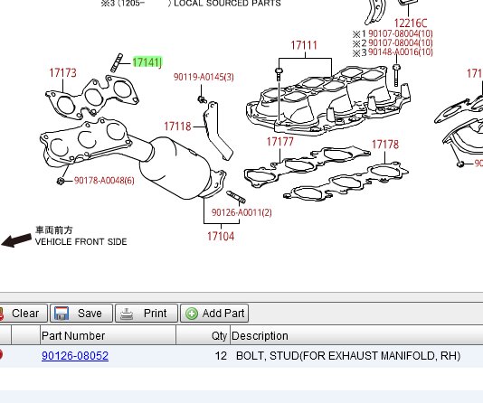

    Probably too late. But...
    Non air injection. Which your 11 should be.
    I'd also do the nuts. 90178-A0048 x 12
    BassAckwards likes this.

    I also should have specified: will I need the longer, ARP header studs with the DT short tubes? I checked out my studs and they all look really good and uncorroded.
