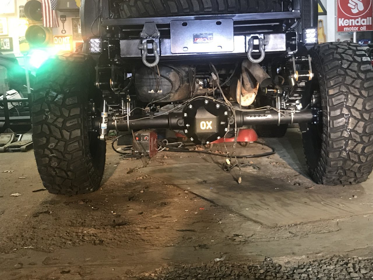

    :spy:

    Are you doing it?!

    HA!
    I don’t know TBH. I only considered the OX. That’s the way to go IMO. Can be air, electric, or cable actuated. No seals to leak like ARB.
    The “Drive Away Lock” is pretty awesome too.

    There was a 9” Ford rear installed by one of the mods that I also thought was supper cool, but I think this wins. You’re a much more hard core wheeler than me, but I’ve worried that with the SC I could take out the rear end. I don’t see how you could break a Dana 60. Did you keep the A-trac?

    I believe it’s the SC that was killing my ring gears. Coupled with the traction bar and 35s.
    The last time, I drove 2500 miles home after a week of wheeling Moab. The following Monday on the way to work I did some data logging for Scott.
    I noticed the rear making noise on my way home that night. No way I drove home from Moab with a few teeth missing off the ring gear and didn’t hear anything. Had to be the data logging. Most likely, just took off too hard once.
    After two ring gears in a month, not to mention going up to 37s, I had to do something.
    I never had A-trac.
