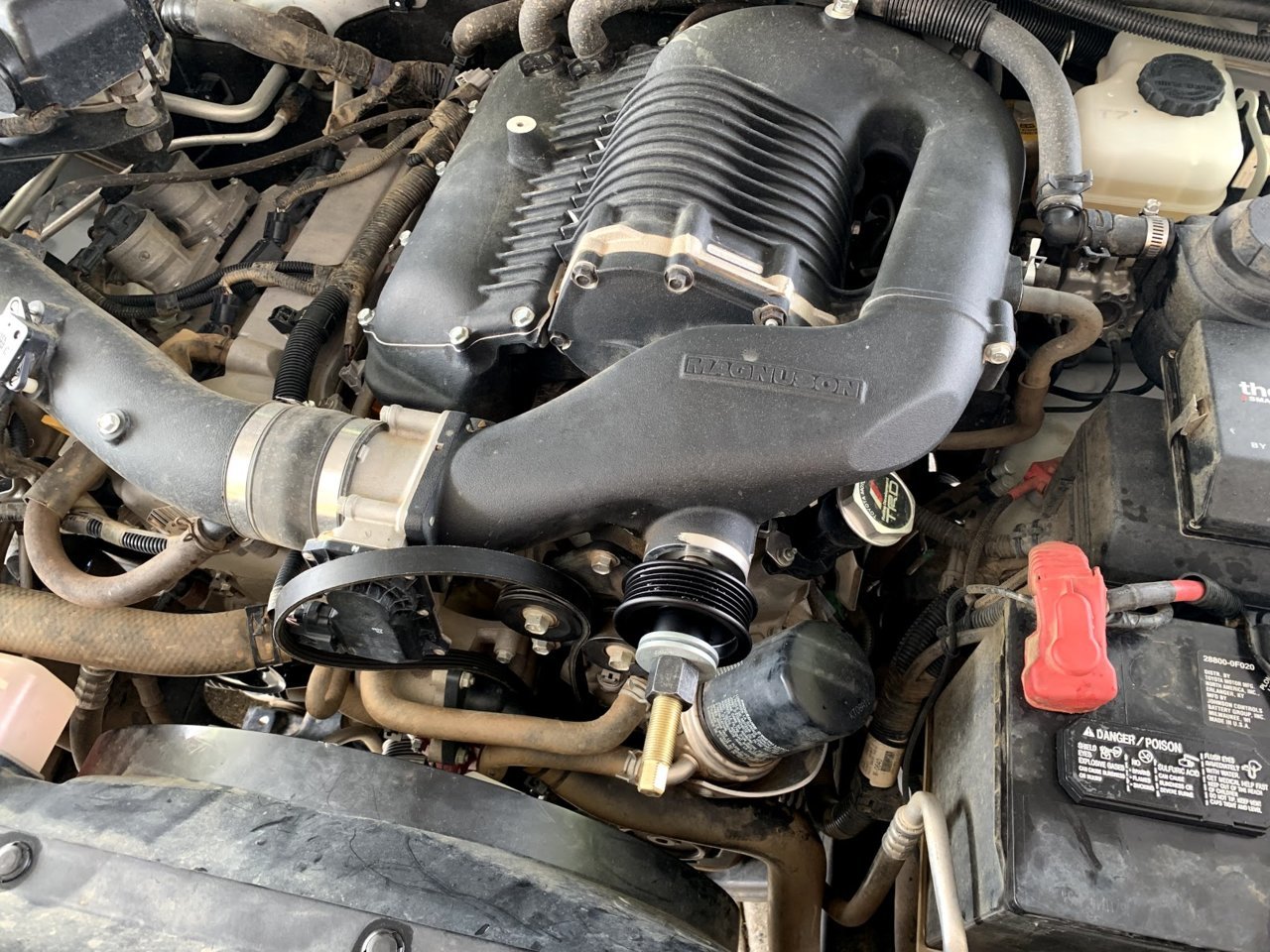

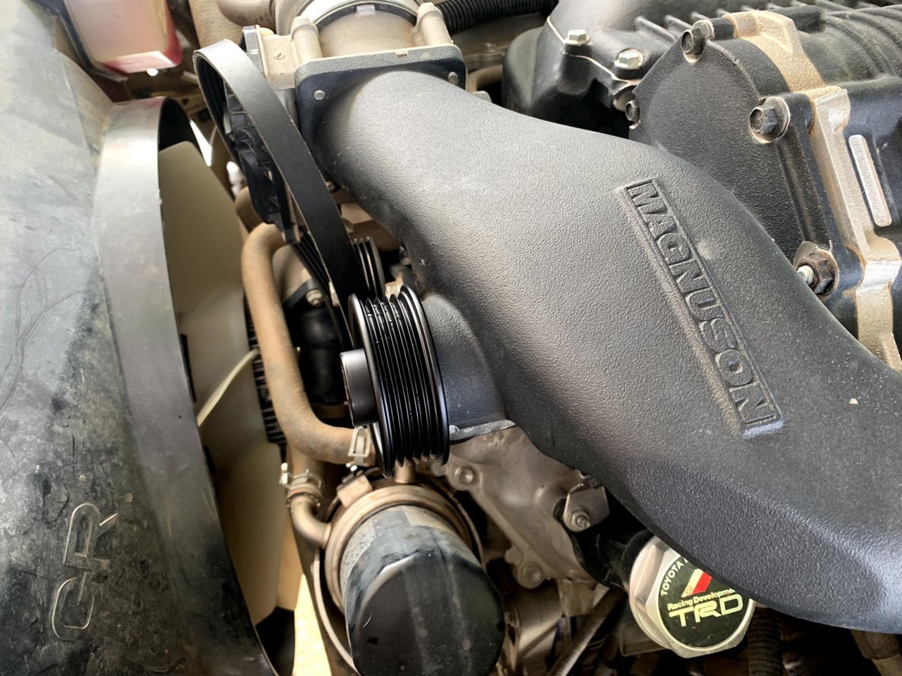

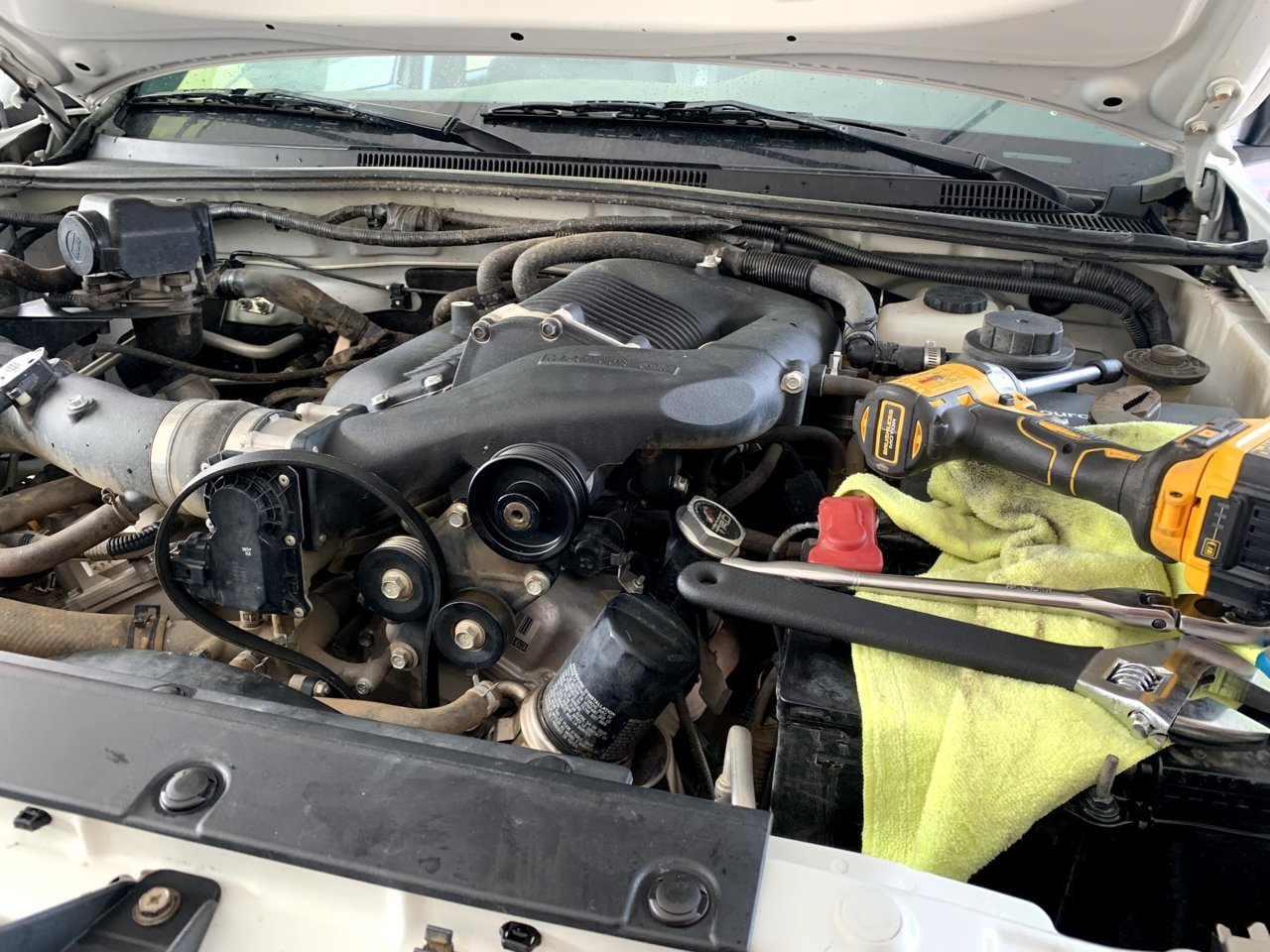

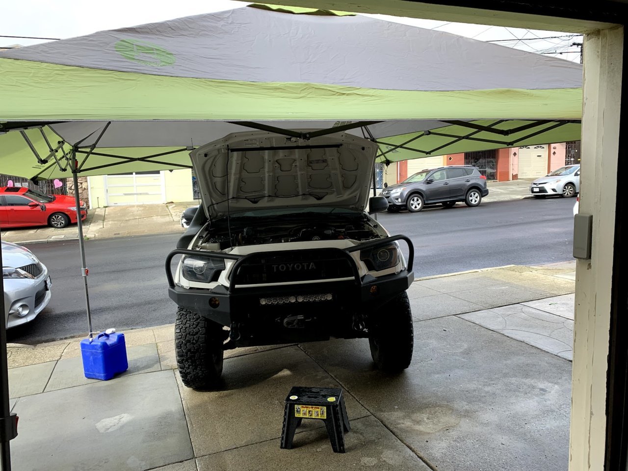

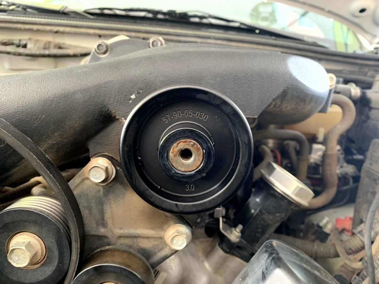

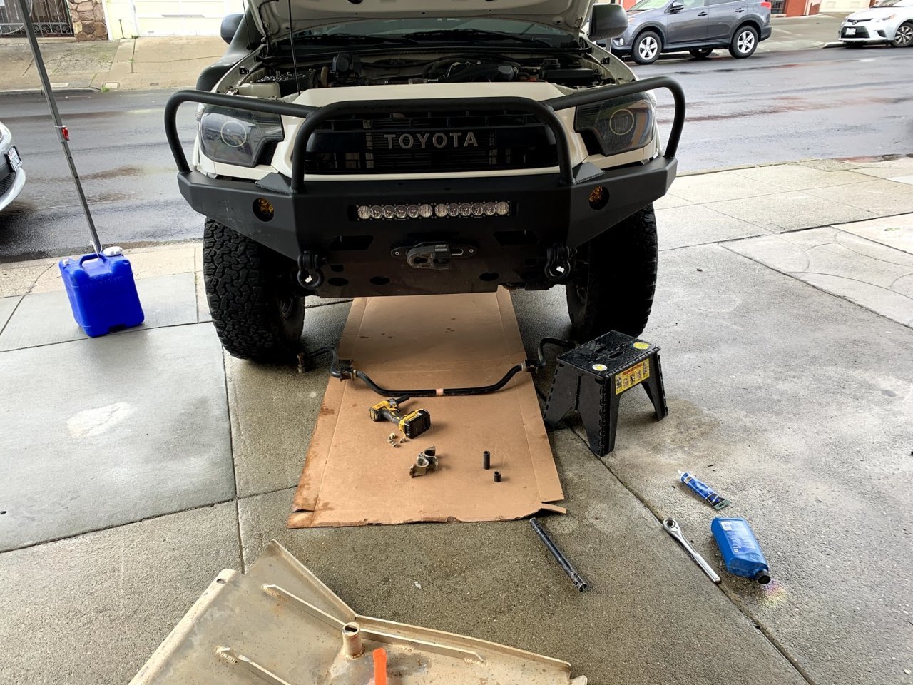

    thanks @Gadget@URD for unscatched pulley. installations was smooth as butter , It was raining all day, did installation under tent.

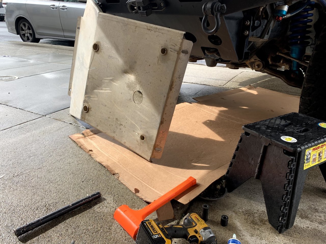

    Your IFS skid is scratched a little in that one spot there.

    What size did you go with? Stealth pulley is obviously doing it's job lol :D

    2.85
    aluminum, lol. thats not the only thing scratched, slider and mid skid took a lot of beating too

    Hell, my IFS skid is reinforced 1/4” steel and its rubbing the diff.
    I have a good pic somewhere of a buddy of mine’s old aluminum T-case skid bent around a big rock.
