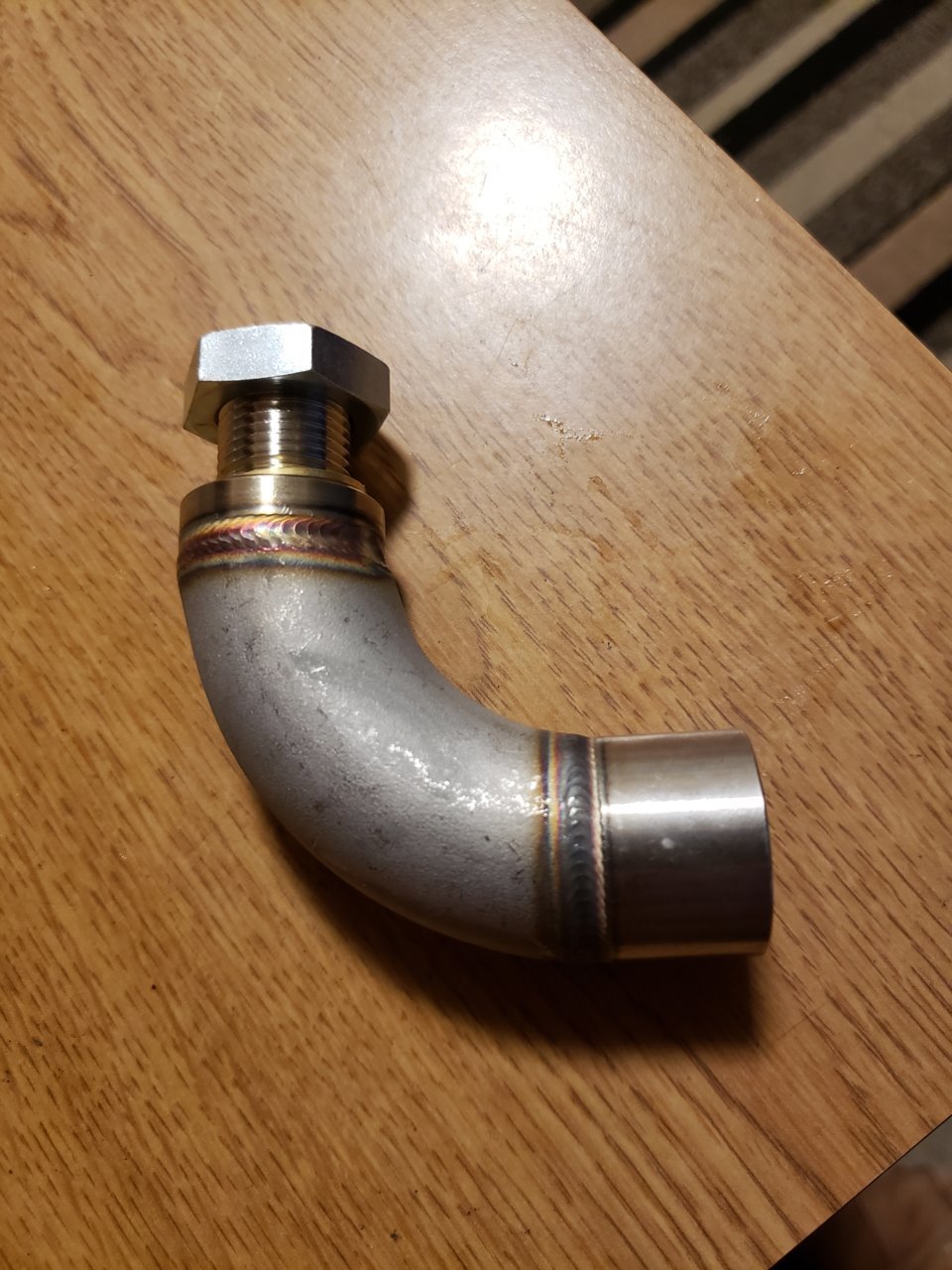

    Anyone know if there is any desired orientation of the j-extensions for the rear o2's?

    You want the o2 sensor to face at a downward angle to prevent condensation buildup.

    Gotcha. Makes sense.

    Just like this......
