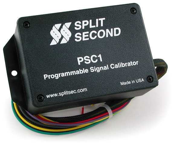

    I might only argue that the URD product (I think is an adaptation of the Split Second products, worth a look: https://splitsec.com/) is very much intended to be for tuners. They do offer some out of the box tunes, but like you said there are a few that have had their issues.

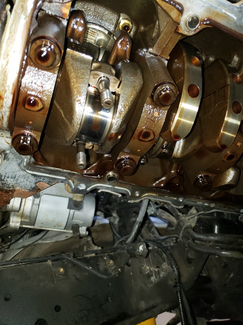

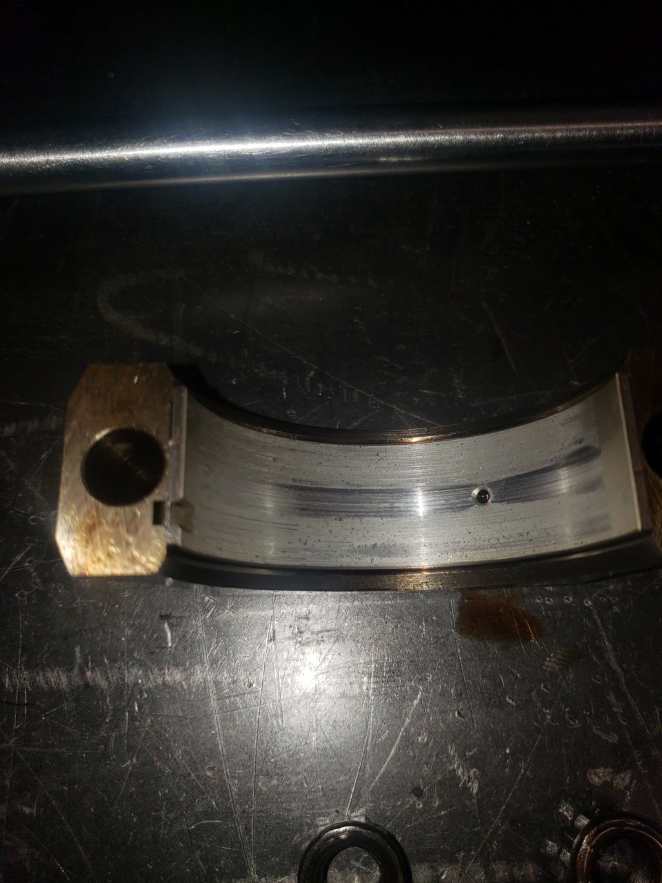

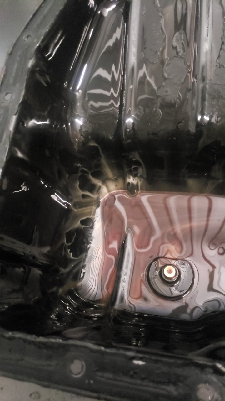

    Had a bit of a setback on the turbo 1fz today:
    0EB2FB4D-9A1D-48D3-BC01-B6DA276F1190.jpg 8DB9AFC3-B319-4448-9525-CB897282D8FC.jpg 469AAE8C-6C50-4117-B715-D48865BAC899.jpg
    Edit: pressure testing of the cooling system says there is a leak, but slow. 1fz already had a head gasket repair before I bought it. It was done at a Toyota dealer, but I’m wondering if they either didn’t resurface the head or reused the one-use bolts. Leaning hard towards the LS conversion now. I’m not made of money, so cost effective is the answer.

    What’s up with those rusted ass pulleys!!

    I saw that! No idea why a California truck would have that much rust!
