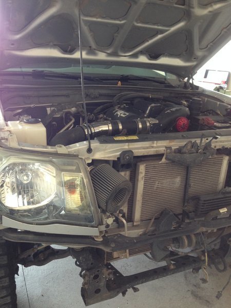

    No shield as I had to modify my intake due to rubbing on the intercooler. But the modification does shield it more than in its original location. 9075CB1A-8073-4577-9CD2-B7A05D18D479.jpg
    But like I said, it’s not a consistent problem other than the fact it only happens when it is cold and rainy/ wet. And once the truck is warmed up and it gets a few high rpm pulls, it runs fine and won’t happen again even if I continue driving in the rain.
  2. Mar 13, 2019 at 8:34 AM

    That's really odd, but if I were you I would shield it anyways if at all possible. The URD design is difficult because it is so exposed. The shield helps immensely in the rain though man. Like you would be surprised.

    Yeah I have the shield because I used it before relocatin to this position. Gonna be chopping my core supports out soon enough so I’ll see what kind of room that gives me for shielding it some more. And like I said it has only happened at start up or the first bit of driving. Even if it is pouring rain, if I’ve been driving for 20+ min it won’t happen again.

    This will cause the back end of sensor to stick out a bit more, correct? I don't think I have room in current setup but I will have to find better spot with new Y-pipe.(if that ever happens)
