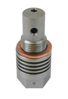

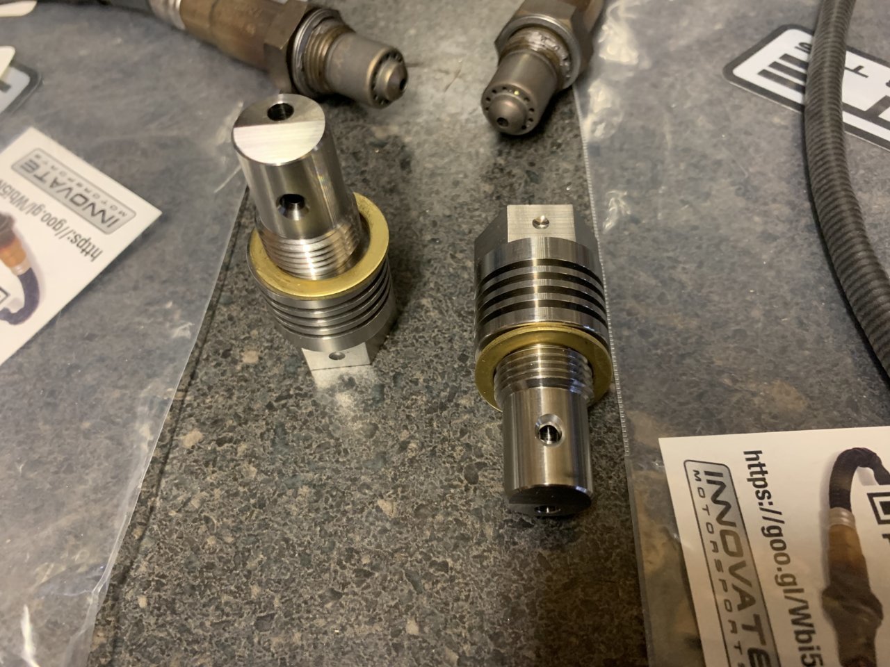

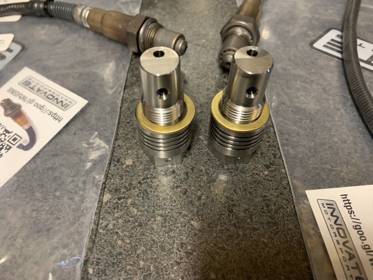

    I am not running any sort of extension but I will look into them. I am betting it is heat also. As for the placement it is about 8 inches behind the y-pipe gasket and right behind the factory O2 sensor placed at just above the 9 o'clock with a slight angle on it. It does go towards the trans and is between the cooler lines so it is tight. But I am going to see about an extension. I have enough length in my sensor wire and guage connection that I might even be able to weld a new one in after the y-pipe merge but that I think is too far away. I am running the spec.U equal length exhaust. Oh and I can't put it back at the merge because I have welded in a Magnaflow 55995 high flow cat on each side before the merge.

    I have mine after the cats, technically it is supposed to be hotter back there, but by running an extension bung which serves as a heatsinks as well coupled with a good location you should not have an issue.
    What error code are you getting on the gauge by the way? Or what is happening that makes you think the Denso sensor died?

    It does one of two things every start. 1) Runs the entire heat cycle, outside ring goes all the way around, and then gives me 4 dashes. One time it reset and did the whole start up cylcle 3 times right in a row. 2) Runs a heat cycle about 3-4 dashes of the outside ring longer than normal, then the numbers come on and it starts in the 14 or or 15's and goes down to the 8's and as soon as you touch the throttle or the engine loads up and the rpms just it goes to 4 dashes. And it just stays at the dashes unless I get a good long long boost pull then it blips a number for a second and then goes back to 4 dashes.
