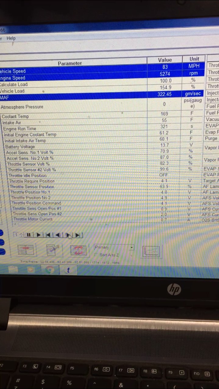

    Got some good news that I'm cautiously optimistic about. Took my truck into the tuning shop I've been in contact with and they scanned my ecu. They said they can fully tune my truck with the proprietary software they've developed. Full custom tune including larger injectors, meth, etc. Looking at the beginning of April to get a tune.
    Also got clarification on workarounds for the MAF max of 322 g/s. Scaling is only possible if the maf signal is not maxed out in voltage. If the signal has enough available voltage then it can be scaled. Otherwise, a larger tube will have to be used or the map sensor. Tundra maf is another potential experiment.
    Does anyone have good data on their maf voltage when they're seeing maf readings maxed out at 322 g/s?

  14. Mar 16, 2019 at 1:40 PM
    o0opackersfano0o

  15. Mar 16, 2019 at 1:42 PM
    o0opackersfano0o
    o0opackersfano0o Well-Known Member
    Oct 18, 2016
    #200102
    2,053
    Tony
    North Berwick, ME
    2005 xrunner swb
    Magnuson supercharger, 2.6 quick change pulley, 76mm throttle body, Doug thorley long tubes, urd y pipe, wot box with 2 step, 170 thermostat, airaid intake, urd short throw, djm 3/4
    That’s all I got. I might be able to see more. I’ll have to wait till Monday to check tho. I have the data saved on my laptop at work.
