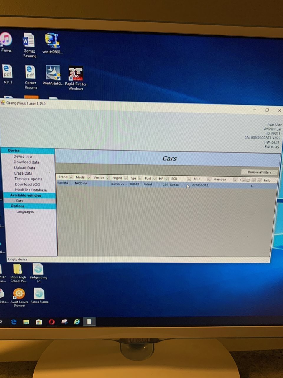

    So she said she tried deleting everything but there was nothing to delete. They handheld said “device has never been used”. She said she can’t delete what’s under “cars” where it lists the truck. Does she need to delete this? If so ....how?

    On the left hand side “Erase Data” click that. Make sure the software update has been run as well in accordance with the instructions on the website as well. Every time you plug it in it will update the device. Click “Erase Data” after all that then plug back into the vehicle to download stock file.

    Sounds good.....the wife truly knows her why around computers, being that she said she tried deleting everything but couldn’t figure the “cars” page I posted.....I’d really like to think she saw that “erase data” on the left side and tried it. I’ll report back in the morning after I get home and do this.....

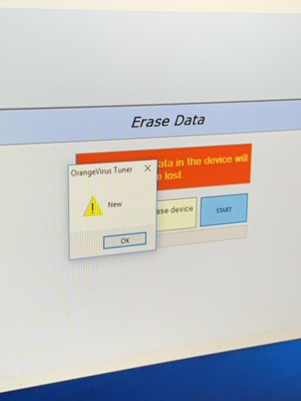

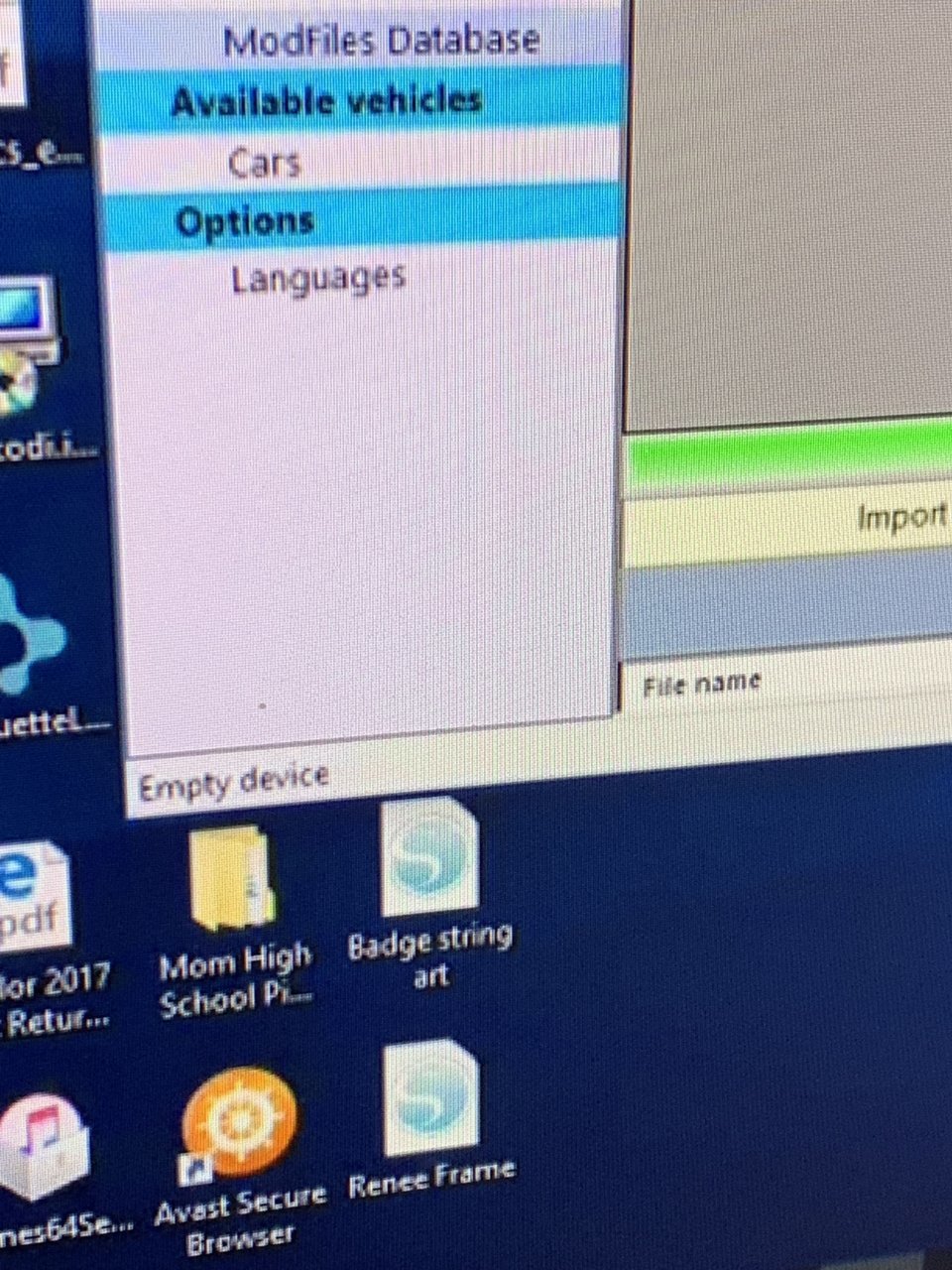

    Well, I did what ya told me to do. I was right, the wife did try to erase the data yesterday. We did it all over again and she showed me. She showed me how it says “empty device” and how it then obviously wouldnt let her erase data from an empty device. We tried updating before we did it and again after. We went to my truck for the hell of it and ended up with the same result.

    I’m sorry. I had that hiccup when I switched from N/A to SC and figured it might help since working through Mat is no quick process tied up in all the 3.5L stuff.
    I thought he said these were open box because they wouldn’t work on NA vehicles. It seems like there is more to it.

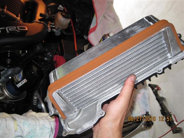

    How is the 4.0 S/C cooled? Is it just the lid on the “plenum” that’s cooled after the charge? Or does the air run through a true aftercooler?

    This is on the underside of the lid. The compressed air travels through it before it enters the lower intake manifold.
    Coolant is circulated through it with an electric pump and then the coolant is pumped to the LTR in front of the radiator.
