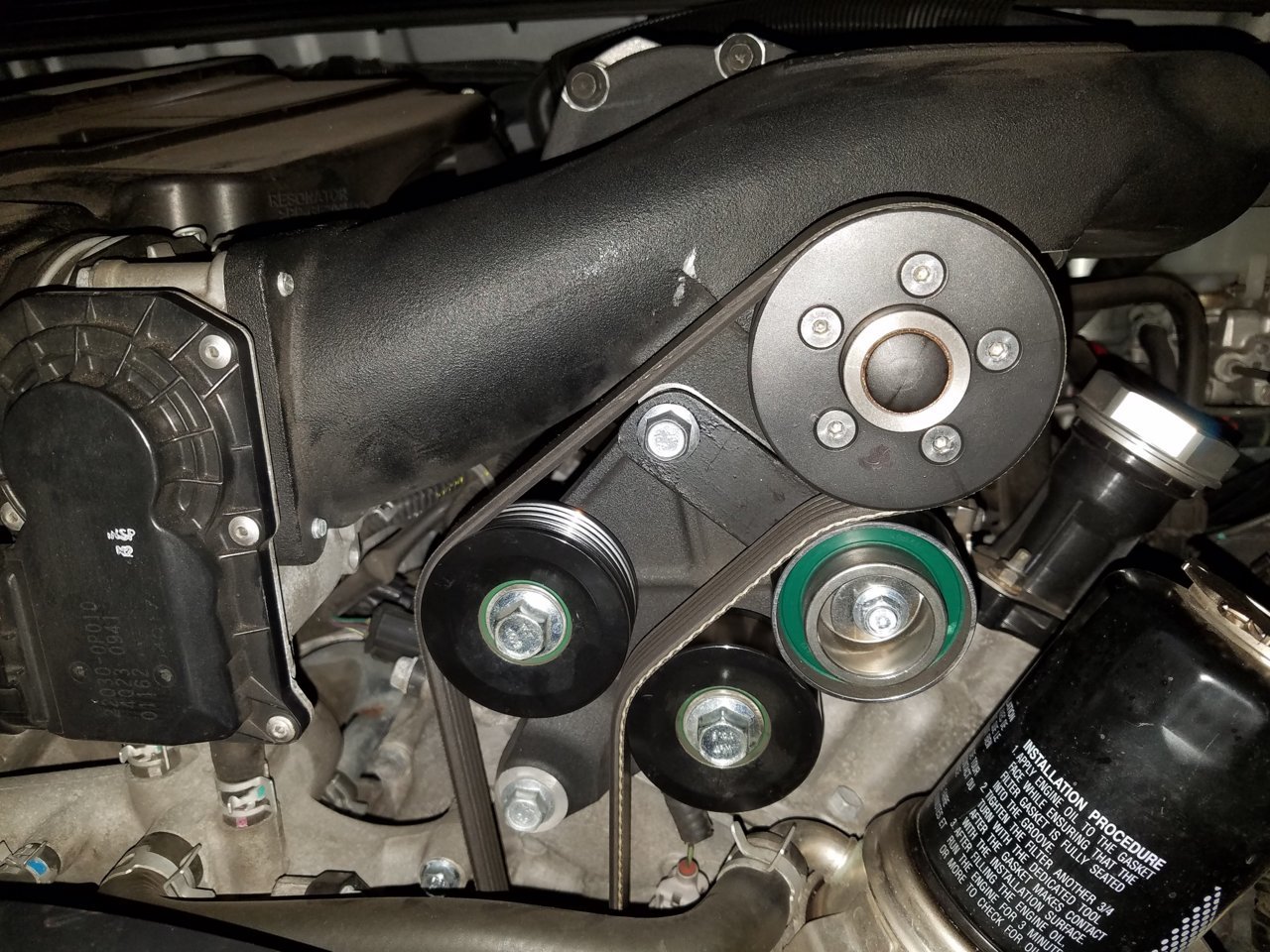

    Finally had good weather and my son was available to assist, so we installed my Pulley Boys Qwikchange Hub and 2.7" RIP-Modded Smoothflow Pulley and Pulley Wrap Mod today. Only drove a few miles, but feels good so far.
    Thanks to all the contributors here for their write-ups, pictures, and advice. Special thanks to
    - @12TRDTacoma for pioneering the Qwikchange Pulley Mod
    - @Roostfactor for designing and building the Pulley Wrap Mod
    - @crashnburn80 for his advice to use a Craftsman ratcheting 5 ton puller
    - @DocME for a good deal on a slightly used URD Snout Cutter and URD Install Tool
    - @White lightning boosted for confirming "belt math" for use of 2.7" pulley with Roost's Pulley Wrap Mod
    - A local gunsmith friend who Cerakoted the pulley for me
    - My son for his help with today's project
    I realize I'm very late to the party but, if anyone is thinking about these mods and needs a slightly used (but fully functional) URD Snout Cutter and URD Install Tool, they're available...

    I thought the snout cutter wasn’t until 2.5 and smaller. Oh I see, the quick change needs the space. I have the URD install tool, but interested in the cutter @Norton

    The cutter is required when going smaller URDs 2.825 or with the quick change pulley.

    I noticed you also painted your pulley wrap plate to match. I may have to take mine off and do that when I mount my quick change pulley.

    Trimming was definitely required for the 2.7" pulley. More importantly, however, I wasn't sure how easy it would be to do later, following hub install, IF I decide to further downsize the pulley... :burnrubber:
    Thanks for your interest in the cutter. I've received a few PMs on the tools, so need to confirm the order in which I was contacted to determine "rights of refusal." Will be in touch via PM...
    +1.
    Yes. I wanted it to be a little less obvious than its original metallic color permitted. Unfortunately, I didn't think about that until I was in the middle of the job, so painting was hurried and not up to my usual standard. Pretty sure I'll end up repainting it. :anonymous:

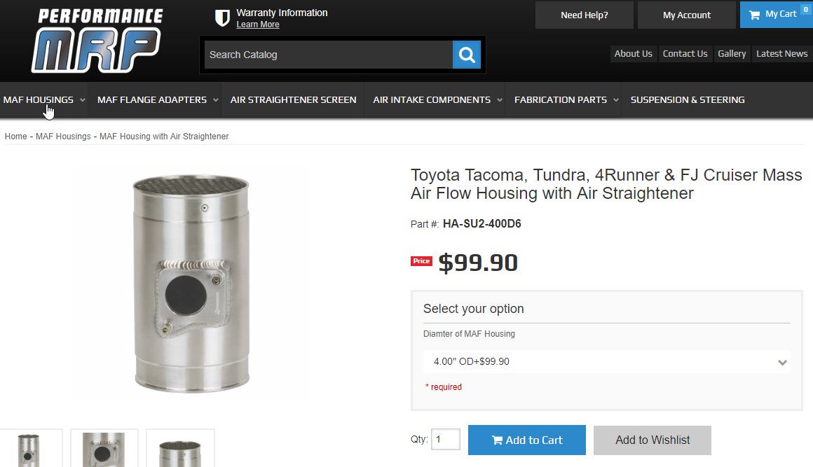

    I just ordered an FJ K&N tubing setup to pull the into from under the cowl, but these ideas got me thinking about other things. Now I understand why R&D costs so much, Better is Good’s worst Enemy!

    I don't think this will actually help improve airflow, at least not on my AFE intake setup, since the inlet from the air box will still be 3" and the outlet into the throttle body is still 76mm/3". So the bottleneck for airflow between the TB and SC inlet elbow still exists no matter how much we increase the size of the intake tube. For me this would only increase the middle section. Everything else will still be 3"
    As far as I know, this mod will just address the maf limitation for us TRD/OVtune guys. Maybe some minor additional benefit from an air straightener, but that's probably it.

    I’m sitting on a tundra 76mm TB and adapter plate trying to get 3” all the way from the cowl just want to keep it as clean as possible. The K&N gives me the right bends but is probably only 65mm. I will measure when it shows up. Your products may offer a better way though, and keep it all 3”. And this is how I ended up buying a TIG...

    It won't increase airflow but because the sensor reading is maxed out for some the airflow is actually more than what the sensor is capable of reading. The increased size apparently allows the sensor to be scaled higher so it gets a valid reading. At least that's my understanding of it. I think the ecu has to be rescaled as well.

    Would be nice if we could get something like a maf cal to rescale the maf to read more g/s

    Yes! So I guess I'd need a couple of silicon couplers. I kinda think the black plastic of my AFE intake absorbs a little less heat than a piece of Al. Don't really want to cut the AFE intake tube either. Wish there was a replacement MAF sensor that would just fix the problem. I get a code pretty much anytime I pin it for a nice pull on the freeway. Good news is it has never affected performance and I just clear it.

    I agree. It says that it comes with the software to program it for calibration, at least the universal model does. I think all the negative feedback comes from the pre-programmed models and the end user expected something different. The end-user were promptly told to find a tuner when they called by from what I understand. I don’t question the vendor or end-user but perhaps think a MAF calibration device is a bit more in depth and would almost require someone educated on such tuning applications to apply at the customer level. It seems there are so many variables not accounted for in their preprogrammed models.

    Agreed. Seems like the reviews have mixed results and more of a bandaid fix but I probably give it a shot if there was no other tuning option available.

    I don't really want to cut the plastic tube either but I'll live with an AFE bionic commando intake if it gets me a full tune!

    @White lightning boosted that aluminum maf housing might be a good place to mount meth nozzle too. Unless the TB adapter is working out good
