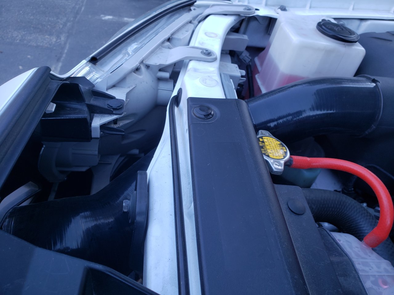

    Need some input fellas. Last weekend drove over a mountain pass to central wa. 4 hour nonstop. Temps always at 185. I'm at 200 feet elevation in the city here, on the other side I was around 800. Outside temps right at freezing. Sunny, dry air, on that side. good times. Gentle driving at 65mph. Then I tried passing on a two lane highway. Truck started drastic power loss. Afr's fell to 8.5. Shitty. Happened at half throttle, no wot use. Backed off, hit fourth, then slowly went to normal afr readings. Upon arrival checked and cleared codes. Only cat delete codes. Battery disconnect then fine, for a while. Happened again on return trip. Once I got near the mountain pass all was fine. Accelerating uphill passing everyone. I have the j-bungs in still with no sims. Quality gas, never ran low. seemed like issue happend pre meth injection point. What the f<>k happened? Could I have been running lean and the truck retarded timing to that? Never had that happen. Not fun. Input welcomed.

    Only recent mod. Didnt know why it could cause that but its silicone turbo couplers making a ram/cold air supply. 20190318_175010.jpg

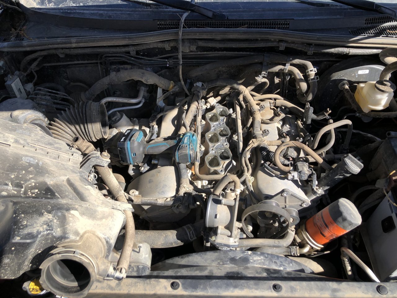

    Changed the plugs today. It only took two hours including removing the blower which wasn’t as bad as I thought it would be. I used NGK 2309 which are actually 1 step cooler than the suggested NGK replacement which I wanted, but you do have regap them slightly. I also pulled the little brass fitting on the release valve for the bypass. I haven’t really noticed anything other than that the idle is much smoother with new plugs lol. Actually one of the old plugs was toast, literally scorched on the porcalin, and I’m guessing the happened last year when I ran a little bit after plugging most of the radiator off road. I’m surprised it didn’t throw a code. Replaced the PCV valve too which wouldn’t even rattle anymore.

    I’m getting a smaller pulley in a couple of weeks. I just did it now when I was able to do it easily. I figured there wouldn’t be much change with the stock pulley which is fine for now.

    The time you posted to change out the plugs by removing the blower makes me glad I am able to do mine with it on. Lol.

    Yeah, I know it’s possible to do with it on but it was so easy to just remove and I wasn’t in that much of a rush. I didn’t install the blower either so it was good to understand how it’s bolted down and remove it myself for future knowledge.
