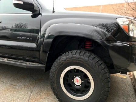

    Oooo. Glass fenders. I likey.

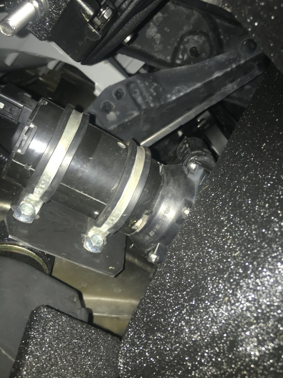

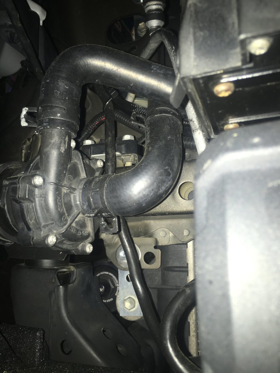

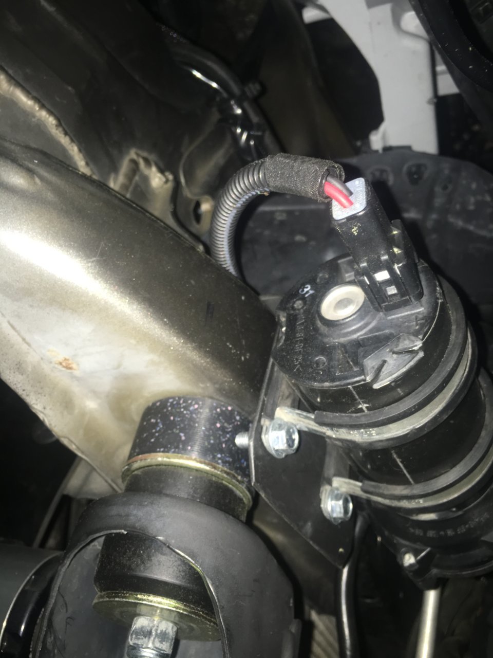

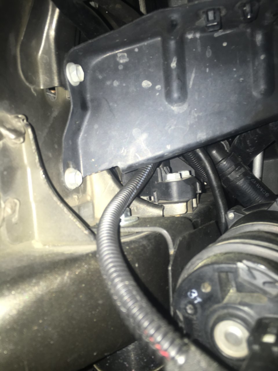

    I cut the bottom of the rad support brace off and welded on some bent steel to make a bracket. The bracket hangs from the body mount on the passenger side. I cut the hoses and added two in line splices to extend the hoses over. I had enough electrical line. I tried to pics through the plate bumper and behind it. I did all this when it was off. I did flip the pump clams over though to move it up higher. You really put it anywhere just check the gravity feed from the reservoir works. Run it on acc to check.
    0515F124-D227-4B49-B5E4-47D294BD9A05.jpg 774F5FA9-42AA-4651-A381-858D6057F3D8.jpg 487D6A07-6C4A-4633-A97E-A23A254C20BD.jpg 963904ED-9A94-413E-8784-D518CA5076A6.jpg

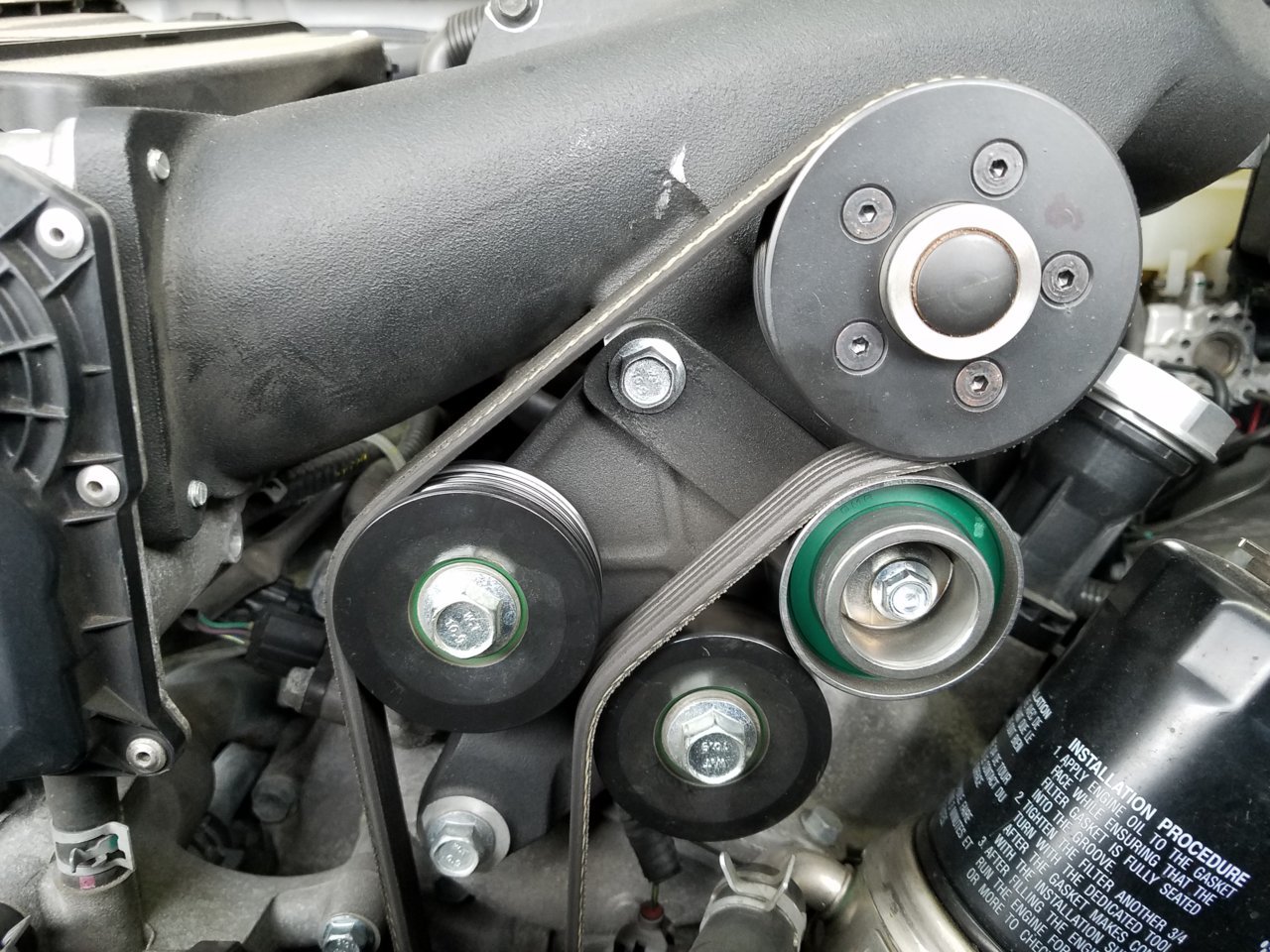

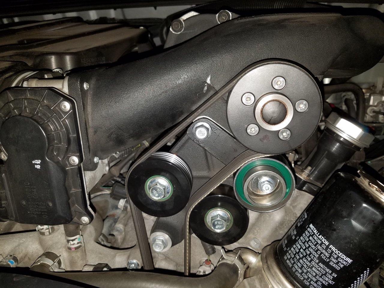

    I wanted black screws for my qwickchange pulley, which came only in a bulk package. I, therefore, have a surplus of black-oxide alloy-steel (nearly twice as strong as stainless steel) hex-drive flat-head screws I'm happy to make available. The pics don't really do justice, but here are before and after shots...
    BEFORE
    AFTER
    I can ship 7 screws (Good to have a couple of spares, right?) for $5. Drop me a PM, if you're interested in less bling...

    Looks clean
