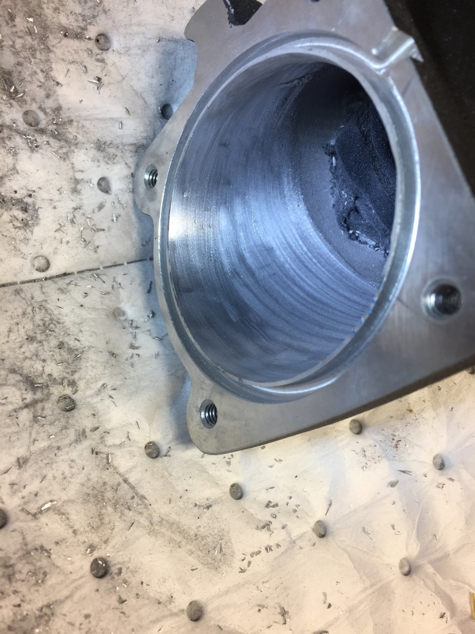

    Started some porting. Gotta try to do some more and get it all polished. Has anyone taken the super charger apart and done any porting and polishing? Not trying to port a bunch but smooth everything out for some better flow C837A2B7-A3D6-4B80-8ABD-8D9C431C0405.jpg65298CC5-B1DA-4F1E-968E-2A154B183B65.jpg

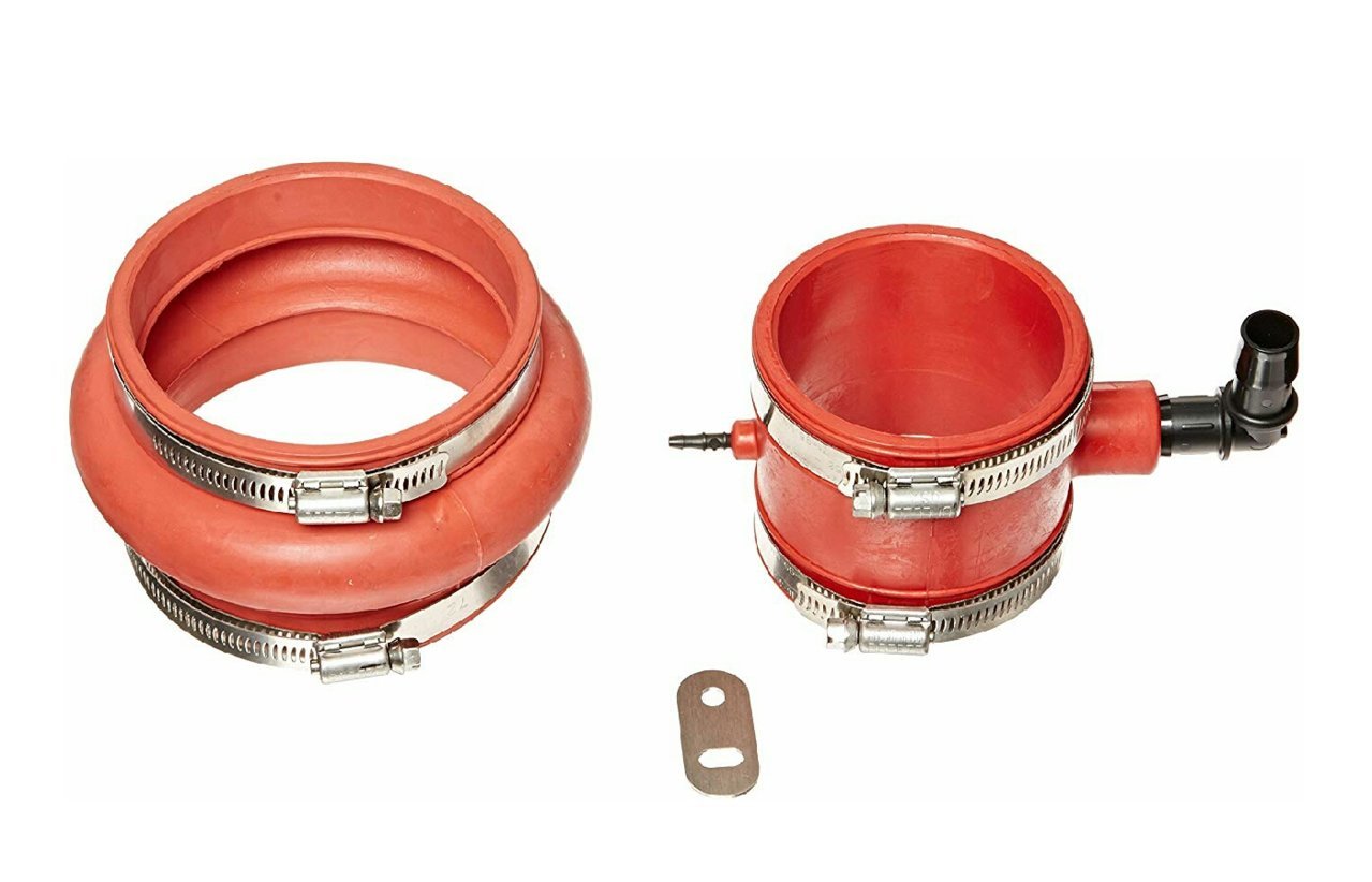

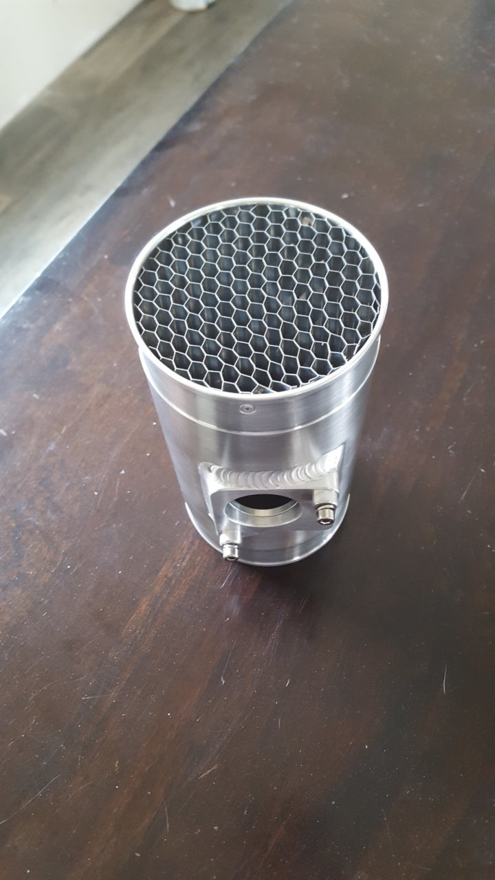

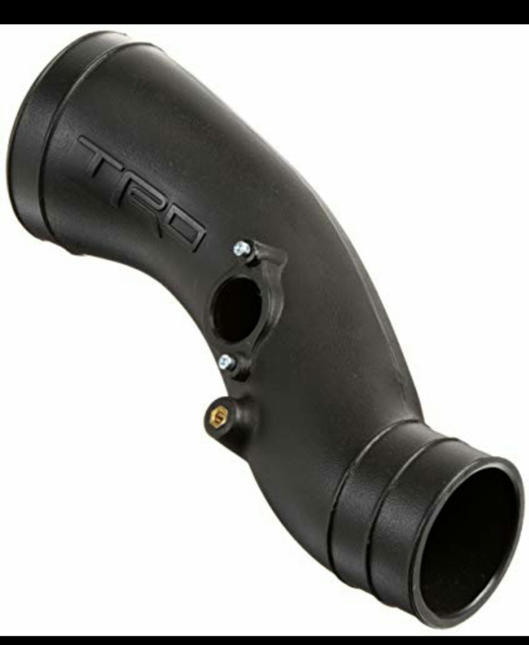

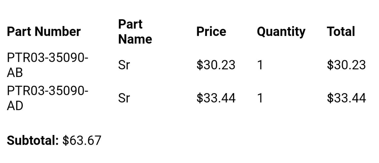

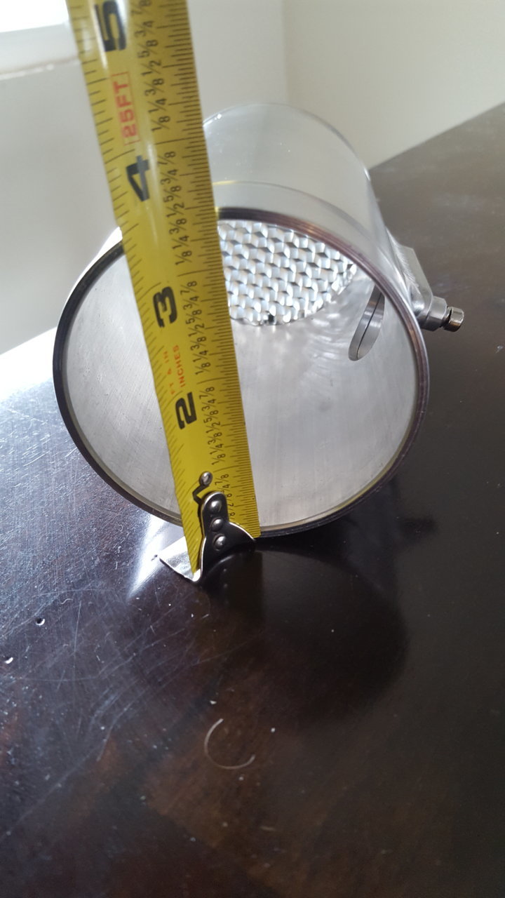

    Picked up this 3.5" maf housing with air straightener and was able to get my hands on another AFE maf tube to cut up for this housing. For anyone else who wants to try this, below are the part # for the TRD tube and couplers. Not too expensive as another option to cut and fit with a housing like this.
    Ultimate goal is better tuning.
