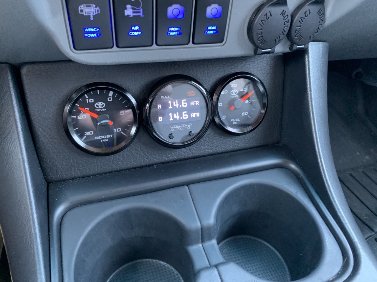

    I don’t have the AFR gauge anymore since I swapped it for the Innovate DLG-1. I still have the Speedhut boost and fuel pressure gauges, though. The DLG1 looks pretty at home nestled in between them.

    One is completely adequate. I’m just a nerd, so I have two. Opinions vary on whose is the best. Innovate ones have worked fine for me, you just have to keep them from getting too hot. If I was going single, I’d put it the y-pipe. Probably after the merge so that it is reading both banks.

    I’m on my second set of sensors. My first set lasted a year or so. I think the problem I was having was due to them getting too hot. Innovate recommends at least 24” from the head. Mine are more like 18”. Plus there are no cats. So on a WOT run, the sensors are probably seeing some serious heat.
    I bought the replacements from Summit. Innovate #3888. This time I installed the Innovate heat sink extenders to get the sensor out of the direct line of fire.
