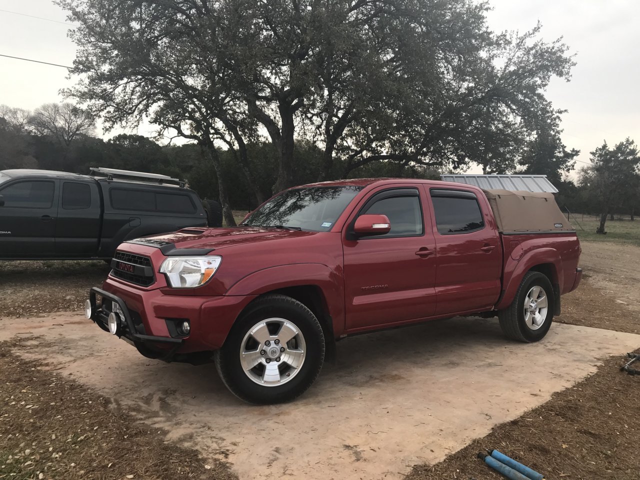

    What color softopper did you get?
    Tan here!

    I got a black one. I bought it from a guy with a 3rd gen. All I needed to get was the rear straight bar for above the tailgate (3rd gen uses a curved bar) and the 2 brackets. So softtopper claims everything is the same between the tops for 2nd and 3rd gens....except for what I just explained. The tops fit different though....in a nut shell.......the 3rd gen top looks sleeker on a 2nd gen than if you ordered a 2nd gen top for a 2nd gen. There is a couple threads on this.....

    Very nice, youre gonna dig it. Yess i agree! I think the 3rd gen one is a little shorter and it fits the 2nd gen cab better. Sits just below it instead of a little bit above it.. im glad thats the way mine was when i bought it. I think im about to get black wheels so i might be looking for someone with a nice black one to trade:spy:

    Yeah exactly....it fits a little lower. I woulda bought a used tan one but black popped up first in the for sale ads. I like both colors
