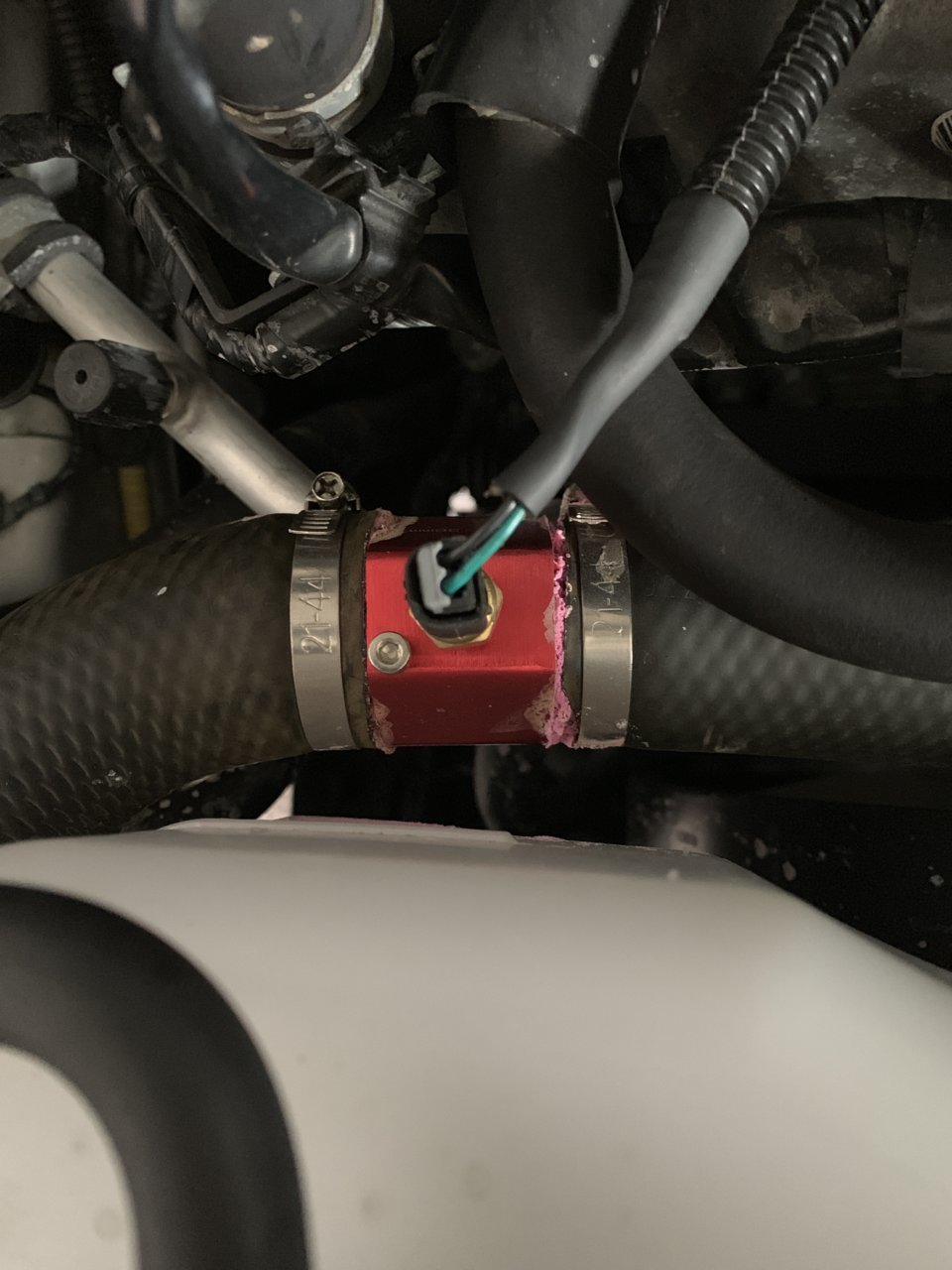

    where did you get your sensor attachment? Also, dumb question, but this is for an aftermarket water temp gauge, right?

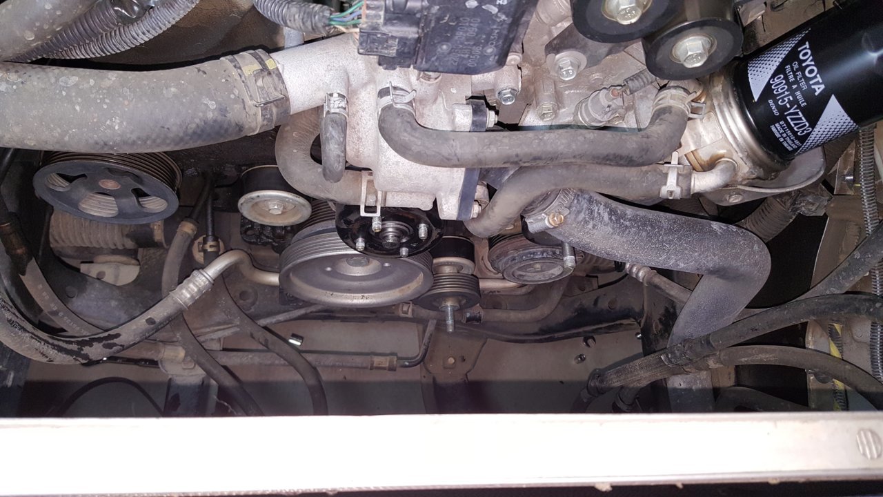

    My blower belt went bad 1,500 miles away from home on a road trip. Made good use of autozone's tool rental. Did you have to remove blower belt before getting to the serpentine belt? I haven't replaced serpentine belt myself after having blower installed.

    Yes u do

    I took off the radiator shroud and fan as well.
    Theres a bracket that holds a pulley or two for the blower onto the engine. This needs to come off and the belt. Then u can get to the serp.
    The belts should be done in pairs imo to save headaches
    Here is blower belt off and the bracket, and u can see the serp hidden way back there in place, right behind blower pulleys.

    Yeah, this didn’t come with my AEM temp sensor. I’ll have to look into where I bought it from

    Lift, pedal commander, led foglights, led interior lights, led back ups, led under lighting, urd tcai, led headlights, methanol injection, 76mm tb, hood struts, dif breather mod, ratiotek trans kit, x-series gauges, true cool trans cooler, belt wrap mod, 2.8 pulley
    I put mine in the upper as I assume pre-radiator is a more accurate # to what's inside the motor.

    I bought my temp sensor from jegs. Believe it was just an AEM duplicate sensor. Then I have a switch inside the cab. I can hit the switch and see my s/c coolant temp, or engine temps on one gauge. Yes, complicated but it amuses me.
