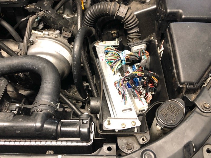

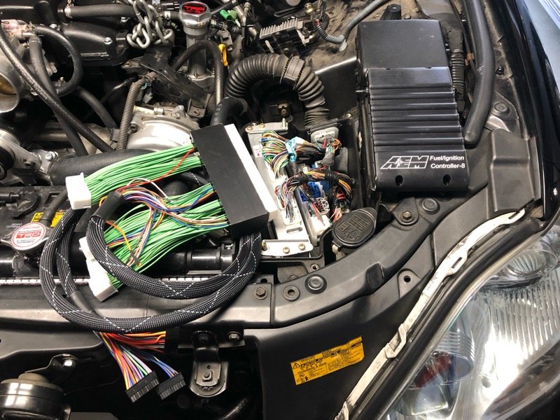

    I need them to make me a custom one off tune for my car. Won’t happen though. Most the things I’ve been using are meant for other cars with the same engine that I hope will work on my car.
    (Because the boomslang harness I got for my AEM is way too big to fit in my ECU’s compartment)

    It’s a TRD supercharger for the tundra 4.7 that’s been thrown into my Lexus 4.3. Did it myself.

    Thats pretty awesome. Did it take much modification to make it work?

    A lot of hammering and some cutting
    This is what I’m stuck on now. ECU is way up front. And the compartment is tiny.
