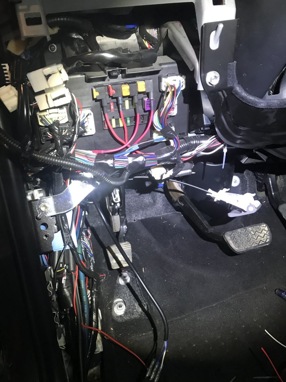

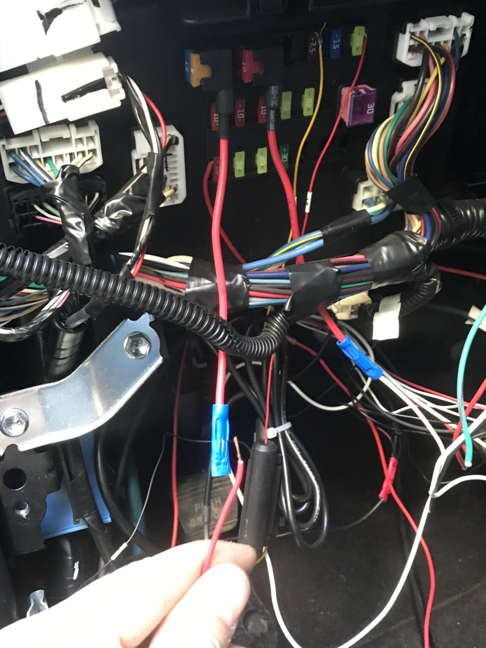

    I’m addition, did everyone use the green TPS wire and where did you tap in for that?

    I am connecting both red/red and white/white

    Mine was not wired up, the green wire from what I read in the manual, is ONLY if you want the warning lights to activate under WOT. If not wired up, they will light up under any throttle position, granted they exceed your limits that you set.

    Looks good bud! Ordered those little fuse taps off Amazon today

    Thanks man! Def looks a lot better then what the PO had done...
