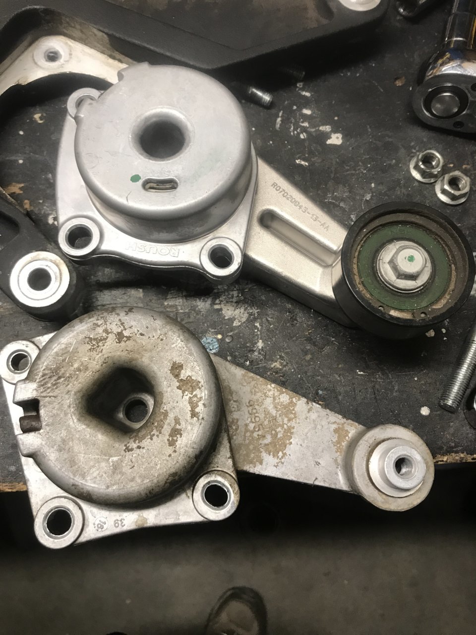

    Did you guys change the pulley AND tensioner when doing the Roush mod? Or just the pulley? image.jpg

    Swap over the OE pulley to the new Roush tensioner. It should not require modifications. I could be wrong though.

    I just swapped my old idler off my tensioner onto the new roush and put it on. If you still are running the stock fan clutch, you may have to loosen the bolts on the fan a little bit and wiggle it out some so you have enough clearance to get a ratchet on the tensioner to put your belt on. Its a tight fit
