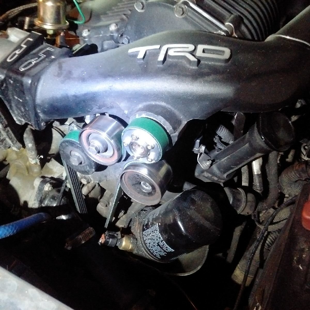

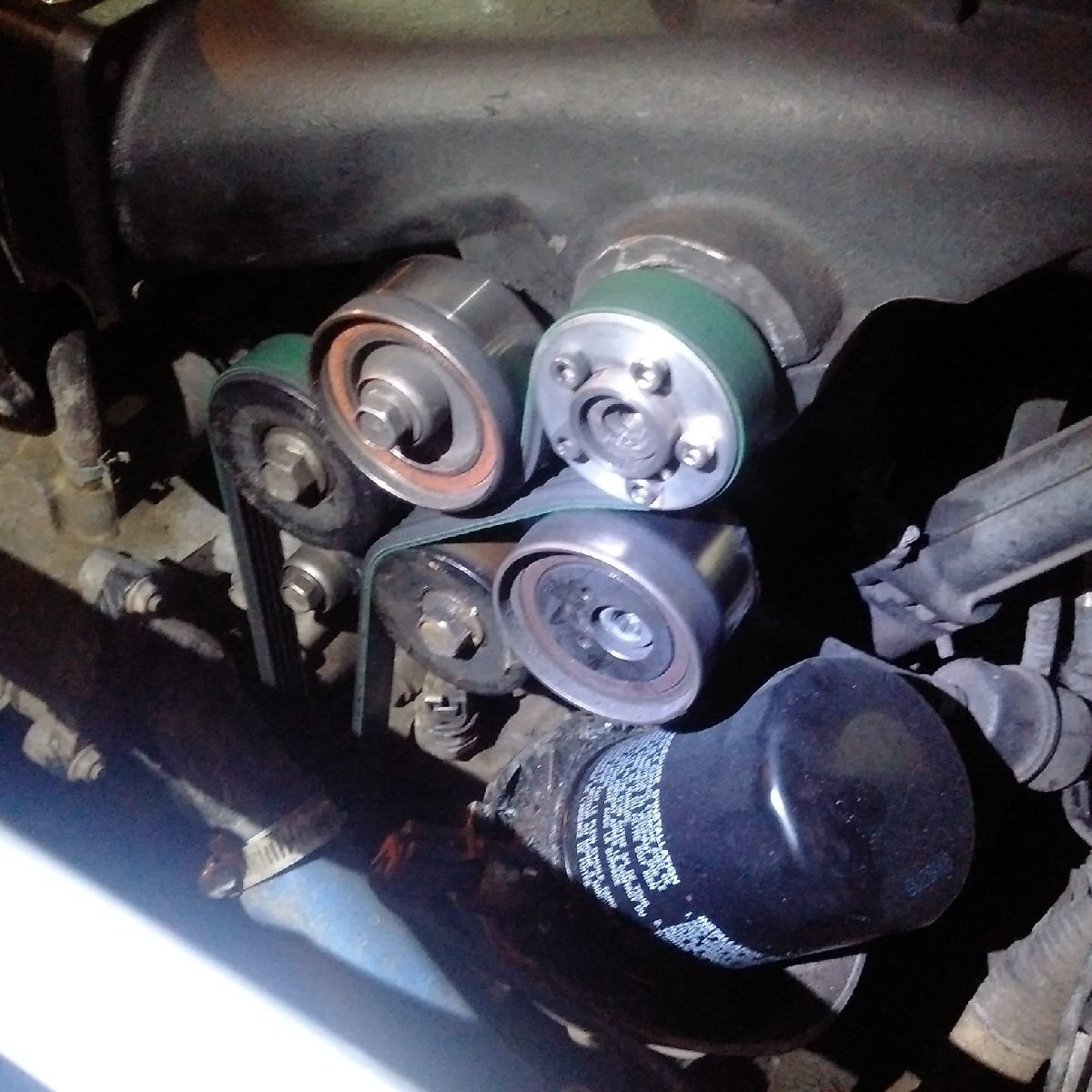

    @12TRDTacoma @White lightning boosted @BassAckwards @Roostfactor @TRON (and anyone else I've forgotten)
    I wouldn't mind knowing what you think of this. Here's a picture of my clusterf*** of noose-mod pulleys.
    This is a 69" belt. Fleetrunner of course, and this time I did an amazing job of cutting a rib off. It's a true work of art.
    Now, when I first put it on, for a couple of days, I wasn't seeing belt dust. I thought okay, that's good, but unusual, because I've always seen some. I was at about 75% of max travel on the Roush and I figured I could get a little more, like to 85% or 90%, so I tried putting on the missing stock smooth idler that sits next to the lower ribbed idler. I couldn't get it on, with the Roush at max travel there wasn't enough slack in the belt to line it up so its bolt would thread in.
    Then the next day, I'm seeing belt dust, not a ton but enough. And my boost had dropped from 15psi to 14psi, under similar conditions (or temperature, at least). I decided to try adding the stock idler back in - and this time, there was more than enough slack in the belt. Way more than enough.
    The Roush is back to around 75% travel, maybe 80%. Based on the amount of slack in the belt compared to right after I put it on, it might have stretched 1/2 of an inch.
    Do you think this is some kind of break-in thing? I didn't think belts were supposed to stretch this much in such a short period of time. Aside from the belt dust, the belt appears to be running just fine, no signs of other wear or fraying. One thing I noticed is the belt was pretty warm the second time, I had been driving around the city and leadfooting it quite a bit. Not like hot, but maybe 30 degrees. That's not enough to make me think this is some kind of heat expansion.
    Hopefully it doesn't stretch any more, if stretching is indeed what's happened. I haven't driven around at all with the lower idler back in but I'll let you know tomorrow if there's any more (or less) belt dust.
    Wouldn't mind knowing if you've seen some kind of stretch phenomenon before.

    Yes I can. They are 6203's but I can insert that into page 1 here soon.
    I always did think the heat exchanger was an overengineered piece. This just further solidifies that idea.
    I saw your update. It sounded like a clutch but glad to hear it was after all. That's wild.
    It is my belief that you have too much tension on the belt and that is indicated by the fact that you are making the tensioner travel further than it has to by adding extra rolling real estate. It may be more tension than belt is able to initially handle when new which is causing it to create extra additional wear until it can stretch out. (Fleetrunner belts are not supposed to stretch much if at all)

    @12TRDTacoma I spent some time on the internetland I agree it’s not stretch but the belt “wearing in” to the ribbed idlers and pulleys. There is a lot of tension on the belt, but not tons... the roush still has a fair amount of travel left. I’ll drive it for a few days like this and see what happens.

    Did you loosen anything else besides releasing tension on the tensioner? If you loosened a pulley bolt then retightened it, it's possible the bolt is bent which would make the pulley rotate from its centerline as the bolt is tightened. (Hard to explain but does it make sense?)
    The tensioner needs to be near centered with belt installed in order to compensate for more and less slack. Those rotors are heavy! I mean like 10 to 15lbs. That kind of mass spinning at 10000 + rpm getting spun by the crank pulley. Then you let off throttle to shift, coast, whatever, and all 15lbs of spinning rotor mass wants to keep going while the engine is slowing down. This puts tension on the opposite side of the belt and makes the tensioner move in the opposite direction to compensate (either looser or tighter). If the tensioner hits its stop with all that momentum going on then the weakest link will surface.
    I'd measure the belt and check for bent pulley mount bolts.
