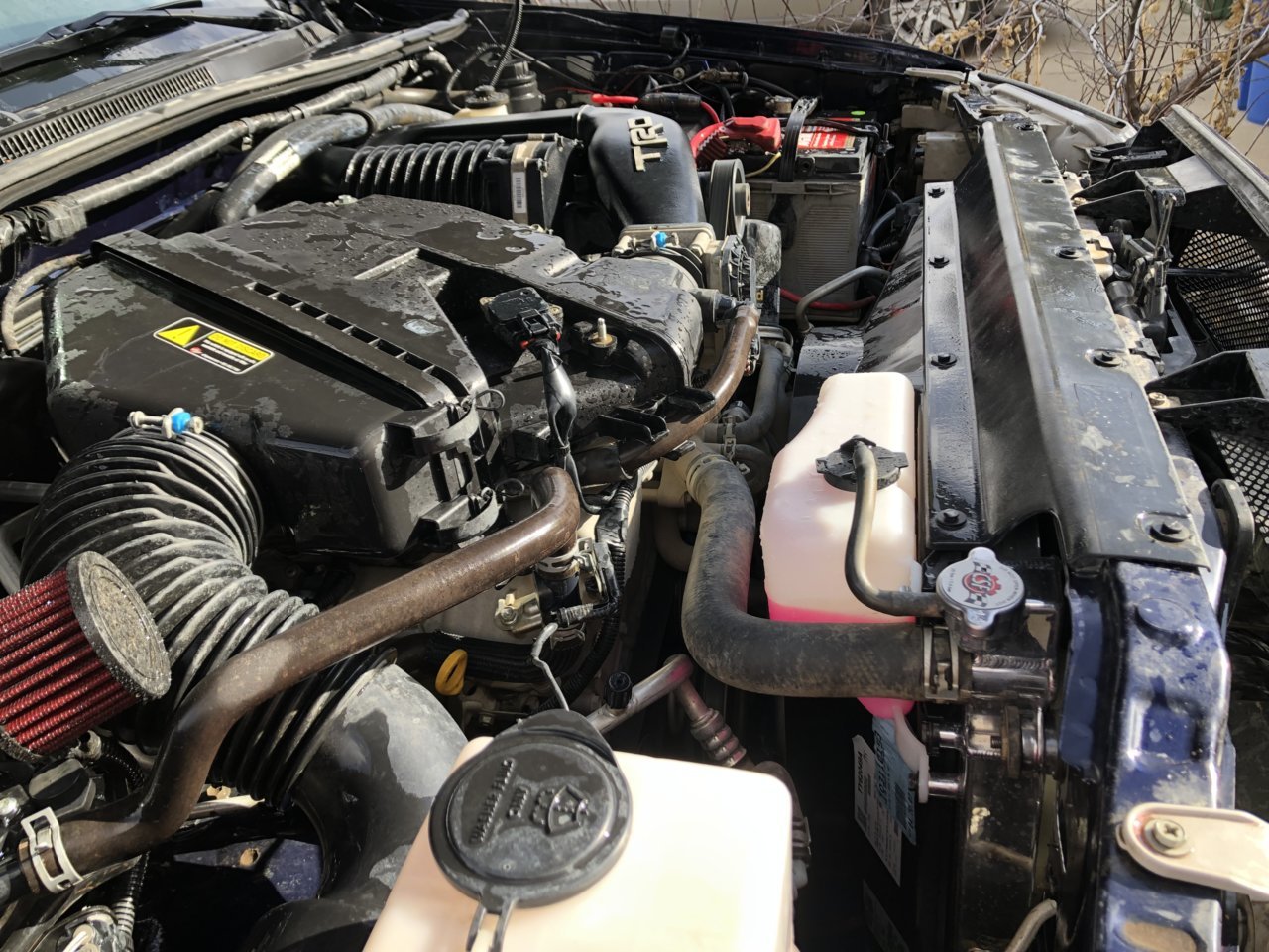

    Confirmed, the cheapest 2008 FJ fan shroud and coolant tank on rock auto fit the CSF oversized radiator just fine.
