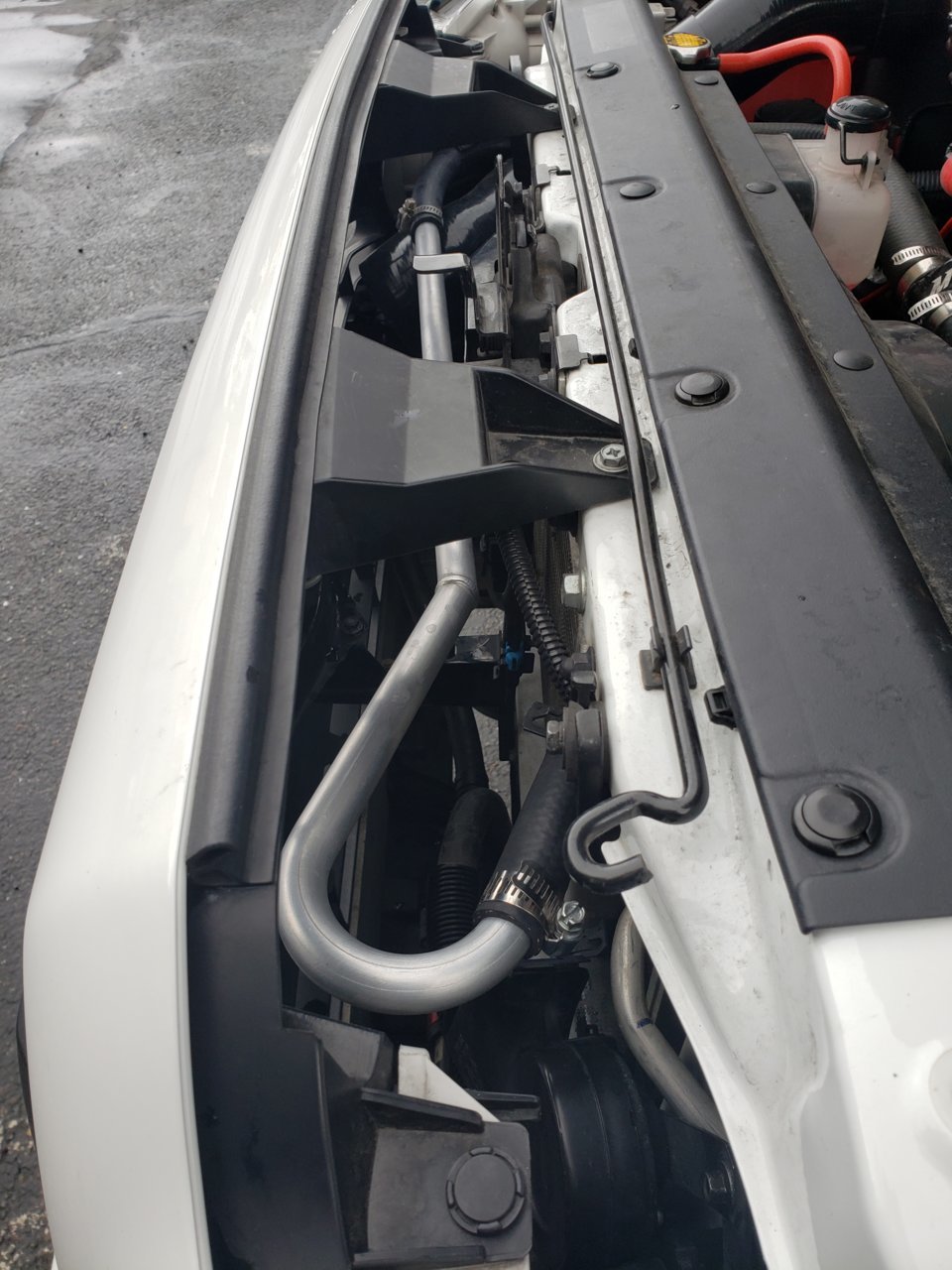

    For those that opt to run coolant lines on the passenger side hps sells aluminum 3/4 tubing to do it. I bought a 180* mandrel bend and a 2' stick. Mitred the connect point and had it welded. Connecting a fastener point now.20190413_173227.jpg

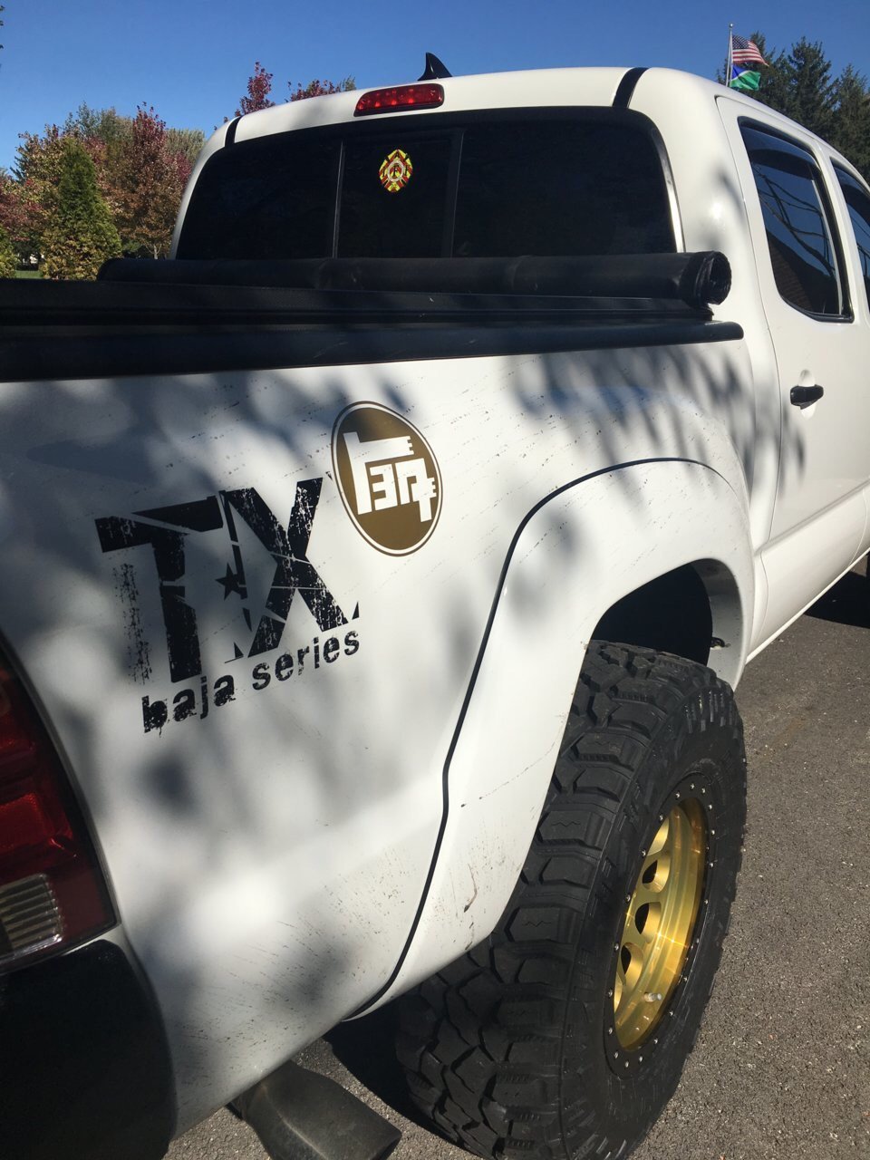

    I got da struts.....I dig em.

    If I just used hose it was too long and couldn't make the bend tight enough. Now its potentially more cooling in extreme temperatures and less prone to leaks or punctures.

    @JuanitoBunito those wheels are awesome man. I like my bronze but that gold look is top notch.

    Thanks man. I had the bronze ones for about a year or so then was able to get my hands on a set of golds. They are just a little brighter.

    Gold on white trucks is primo.

    You got a sexy white one my friend.

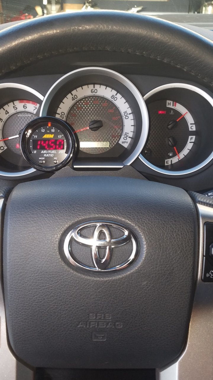

    The grinding for x gauge takes time. Well done sir

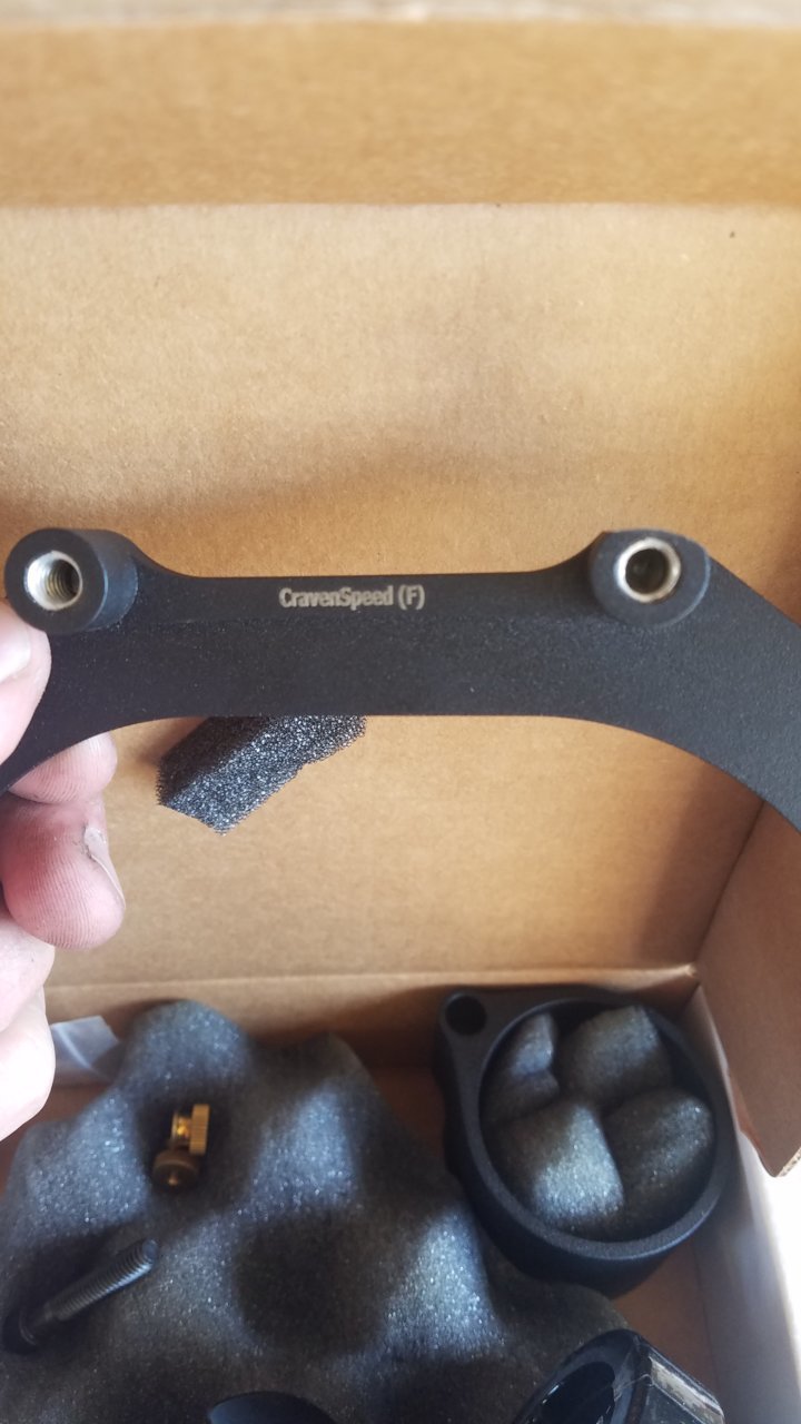

    That is the truth. I have to unmount it tomorrow and add a washer between the pod and the bracket. The steering wheel rubs the buttons when I turn. :facepalm:

    Inherent problem with that thing. You did well with extensions. I found some make do stuff at lowes but it looked crap. Works kinda for now.
