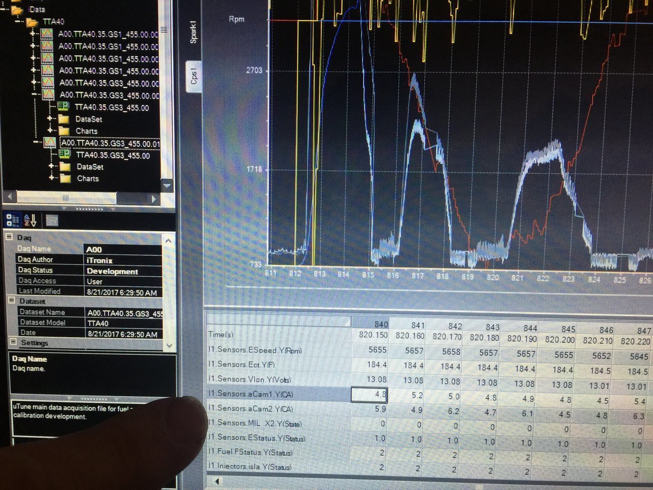

    In boost, the truck was slower than not in boost.
    TRD flash messes with the cam angles and limits what the UCON can do.
    In the uTune software, if you do a data log on a stock ECU the cam angles will around 5 or less. On the TRD flash they were around 23 if I remember correctly. @jojotoo had the same problem, if I remember correctly...
    This pic is at with the stock ECU @ WOT just before gear change. Should look like this:

  8. Jan 22, 2018 at 12:30 PM
    #1448
    TRON

    TRD Blower, 2.3 Pulley, NST OverDrive Pulley Kit, B&M Shifter, TR Lowering Kit, Spec Clutch, Xrunner Body Kit
    Never heard of this from the original ucon batches. But the newer ecu models 2009+ did change including the TRD reflash. If anyone has high standards on how FI engines should run, getting a ucon to perform properly on a consistent basis is difficult to say the least

  9. Jan 22, 2018 at 12:41 PM
    #1449
    loginfailed

    2014 DCSB 4WD
    Thanks, I’ve had no issues to speak of since pairing the UCON with a stock ECU. Despite the initial hiccups due to the TRD flash, the UCON is doing exactly what I was told it would do.

    #1451

    Brandon
    Socal
    2015 DCLB
    Yeah.. had the same cam angle issue with the Mag tune and my throttle was limited to 80% when peddle was to the floor.
    TRD reflash seems consistant across the board.. but the Mag tune is very inconsistant from one user to another.
