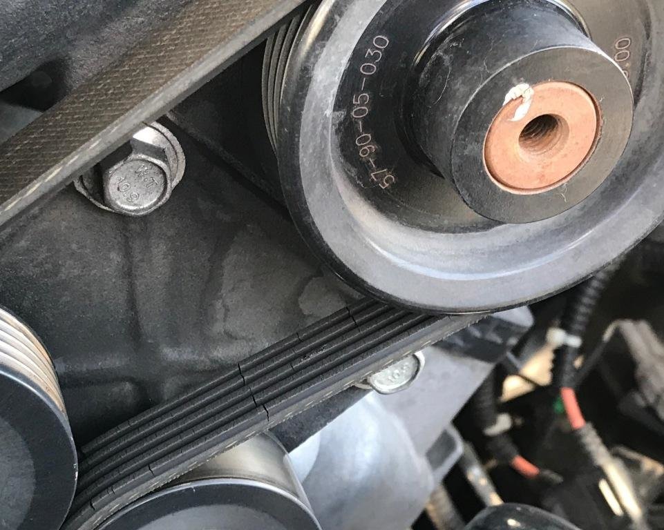

    If I'm swapping pulleys I'm due for a new one anyway. Think I could convince Toyota to spring for it since I'm still under warranty?
    [Edit] Also... this IS the stock pulley and not a stealth, right?

    Highly doubtful that they will replace the belt......but you could try!! The URD stealth pulley has the same info inscribed on it as the stocker. You could measure it....
    Edit, definitely looks like you need a belt

    You can tell by the material the pulley is made from. Is it steel or aluminum?

    I think you need to measure it. I thought the URD stealth pulleys were made of steel as well.

    That is stock. Stock pulley is stamped 3.00, URD stealth pulley is stamped 3.0.
