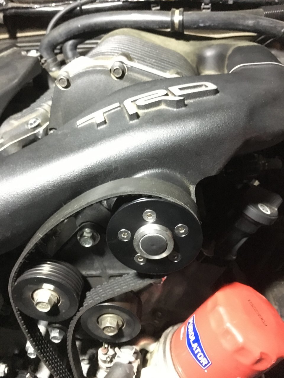

    Welp, I wish someone would have warned me before putting on the URD pulley. @TheFang it is destroyed and pretty much impossible to pull off an aluminum pulley.
    Snout trim complete.
    I damaged the threads pulling off my URD pulley. I had to chase the threads so that I could put the snout cutter on. I used my air ratchet on the cutter and it took about 20 min. Now to put on the qwik change. I’m glad they made it one way only. I still gotta trim the new belt. I have one brand new and one almost new stock pulley belt if anybody wants them. I am putting on my 2.5” on. I also got the new injectors in, but not installed yet.

    Thanks for trying @zippsub9. This 100% makes the decision to go with the qwik change an easy choice. I've been reading the original thread @12TRDTacoma made when he first tried out the qwik change, and to me it is the now tested and proven best way to go. My craftsman puller shipped today, as well as a snout cutter thanks to OP, and a fuel pump upgrade is in the works... just gotta keep finding $$ I can throw at my truck.

  18. May 3, 2019 at 7:23 PM
    zippsub9
    zippsub9 Well-Known Member
    Nov 3, 2014
    #141634
    4,583
    Halfmoon, NY
    14 DCLB
    Shit bolted onto other shit, and junk.
    F1D2F537-4D31-43AF-B5A9-6BBF0111F954.jpg 5532B89A-6115-4B2E-BAED-30B18A22B215.jpg
    I took a video but couldn’t upload it.
    I only used a two arm puller. No help. Sucked and I ended up damaging the threads inside the shaft because of it. Use a three arm to keep it balanced and centered. I only had the stealth, engine was still very warm. Not sure if that made it worse or not.
    I need the parts list. Anybody got it, I can’t afford to disturb Roost from either working on my Y-pipe or colluding on some more tuning work.

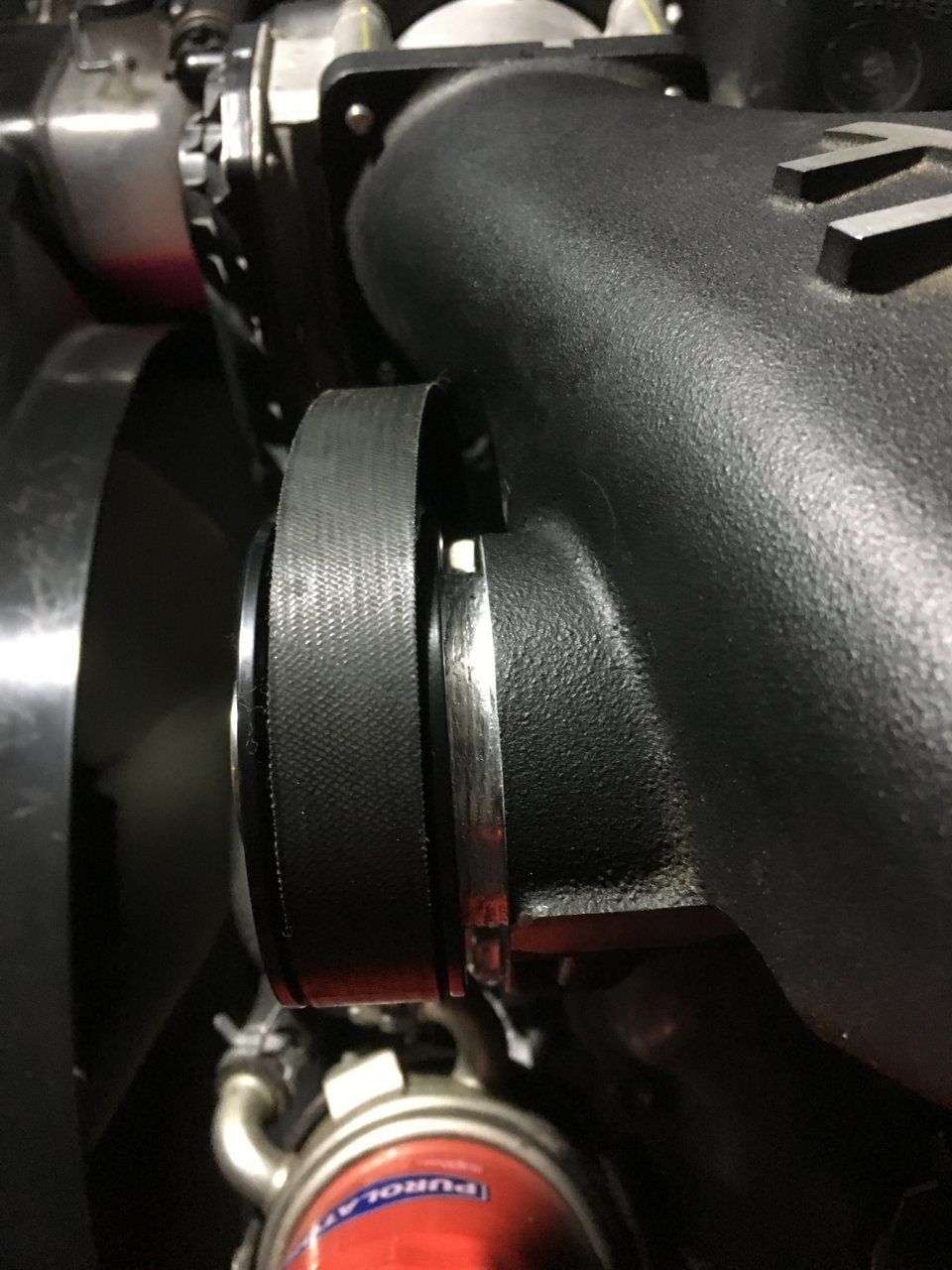

  20. May 3, 2019 at 7:31 PM
    zippsub9
    Nov 3, 2014
    #141634
    4,583
    Halfmoon, NY
    14 DCLB
    Fresh cut fleet runner belt and bent pulley. Maybe not as catastrophic as others, but I would never sell or reuse it. It is steel.
