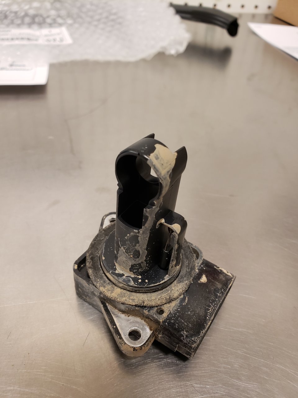

    Check your AFE MAF gasket. I think mine might have been letting a little something through.

    Holy crap! I bought a new one when I started maxing out the sensor. Mine was nice and clean.

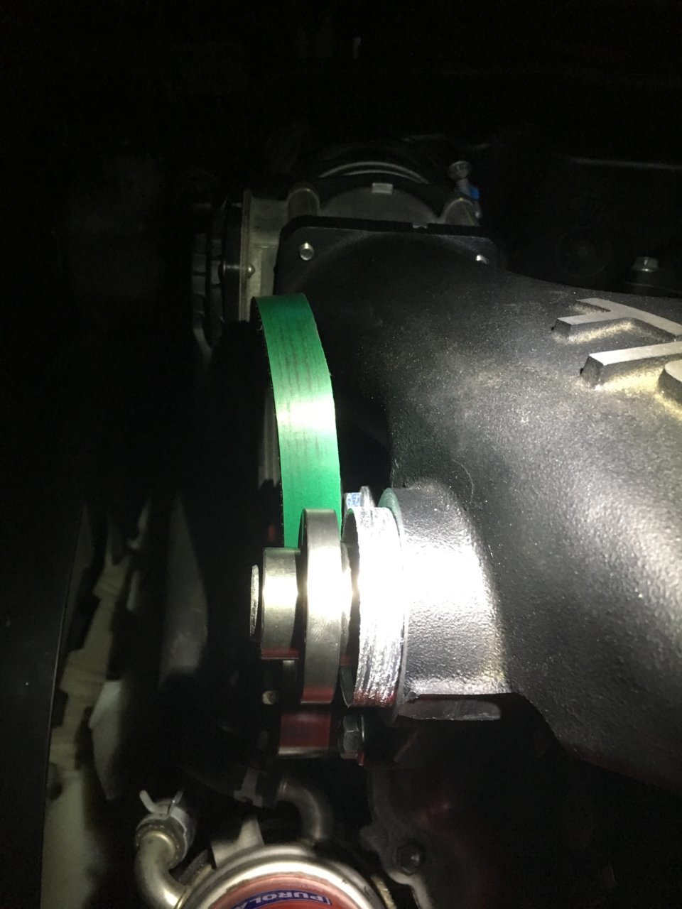

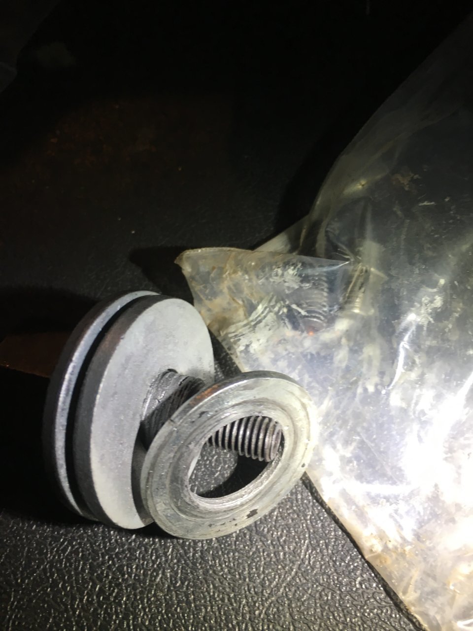

    I've posted this several times. The pulleyboys setup needs to be pressed on further.
    https://www.tacomaworld.com/threads...hange-pulley-kit.519702/page-15#post-16587262
    https://www.tacomaworld.com/threads...hange-pulley-kit.519702/page-15#post-16596676
    Sorry. There needs to be a sticky somewhere or something.

    Or you could use a socket one size too small to press the hub on. Yep, not my finest performance.
