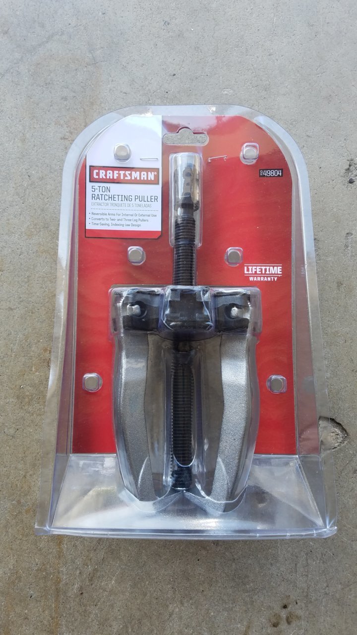

  5. May 7, 2019 at 1:33 PM
    TheFang
    TheFang No Big Deal
    Jul 15, 2014
    #133985
    2,643
    SoCal
    Tacoma TRD Sport
    TRD Exhaust, URD Short Shift, TRD Supercharger, Hellwig rear sway bar, TWM shift knob, limo tint, URD Y-pipe, URD LT Headers, URD Rear O2 Sim, Custom tube front and rear bumpers, LED spot pods, K&N CAI
    Always fun when tools are at the door when you get home!
