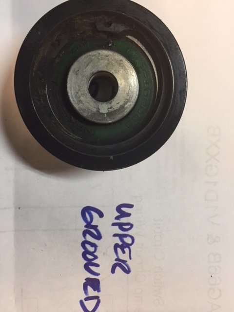

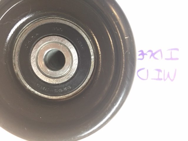

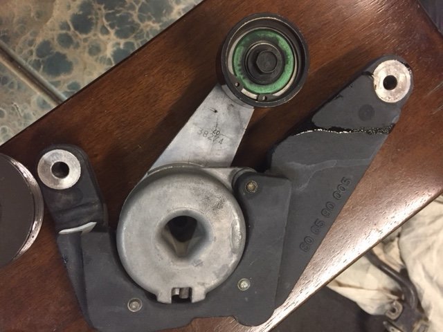

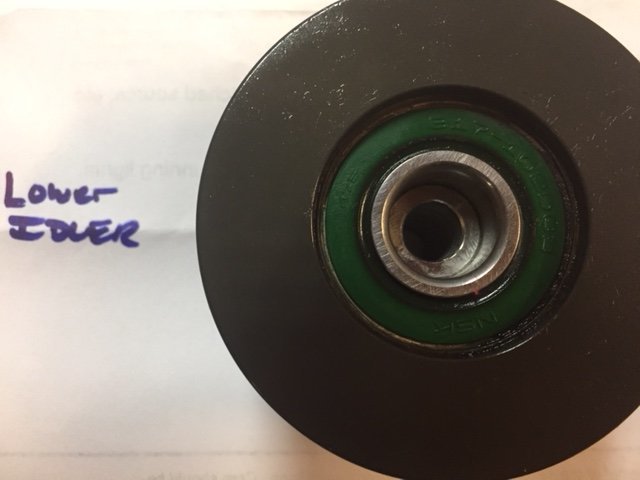

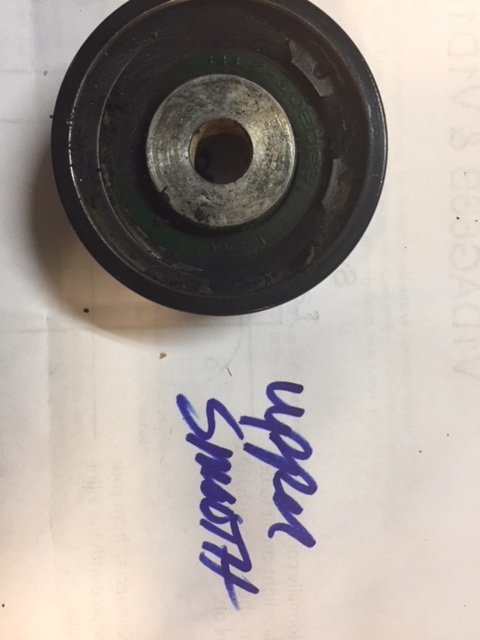

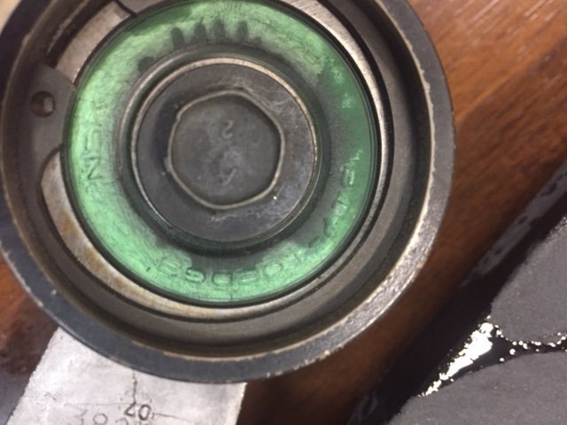

    Part numbers are accurate as listed. Here's pictures of all my original idlers, note picture of tensioner idler is redundant.

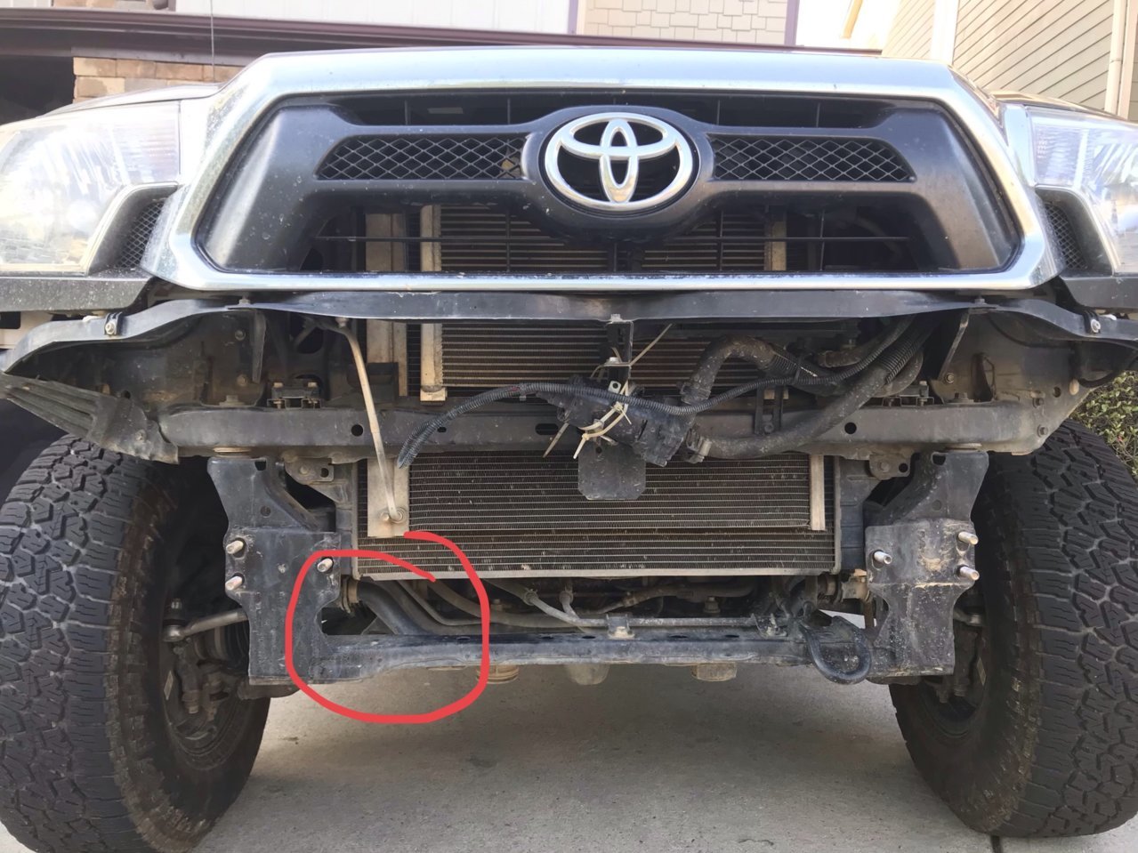

    Anybody issues relocating my coolant pump to the circled location? My only concern is if it will have any issues the few times it could potentially be fully submerged.

    Ahh, I see the way they are built. You can't really see their size because of how they are mounted. I guess the only one which uses a 6203 is going to be the mid idler. Makes sense. :thumbsup:
    I'm going to take your info and directly copy paste it into page 1 when I do the update.
