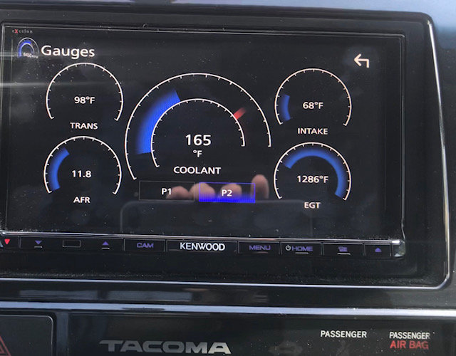

    Just installed the AFE intake and am seeing AFR max at 11.8 pretty quick at full throttle.
    1. Should I be worried?
    2. What do I need to change to see lower numbers than this stock config can spit out?

    That is perfect actually. You are at a great AFR. We need to make sure you are not pinging under RPM though. Do you hear any audible noises while accelerating hard?

    No pinging, just a lot of whine like it should be. But I’m pretty sure it’s going below 11.8 just not showing it ... I remember someone mentioned the sensor can only read into the 11.7s?
    [Edit] it’s the 02 sensor limit discussed back on page 739, I just don’t know what to do with that info. Lower AFM = richer = not a big worry, is that right?

    11.9 is the limits of the PCM air fuel ratio readout limits.
    Where are you obtaining your air fuel ratio readouts from? If you dont have a wideband AFR gauge then you really need to.

    Does this count? :anonymous:

    No, that is reading the factory sensors. You need a dedicated sensor and guage to get an accurate reading.
