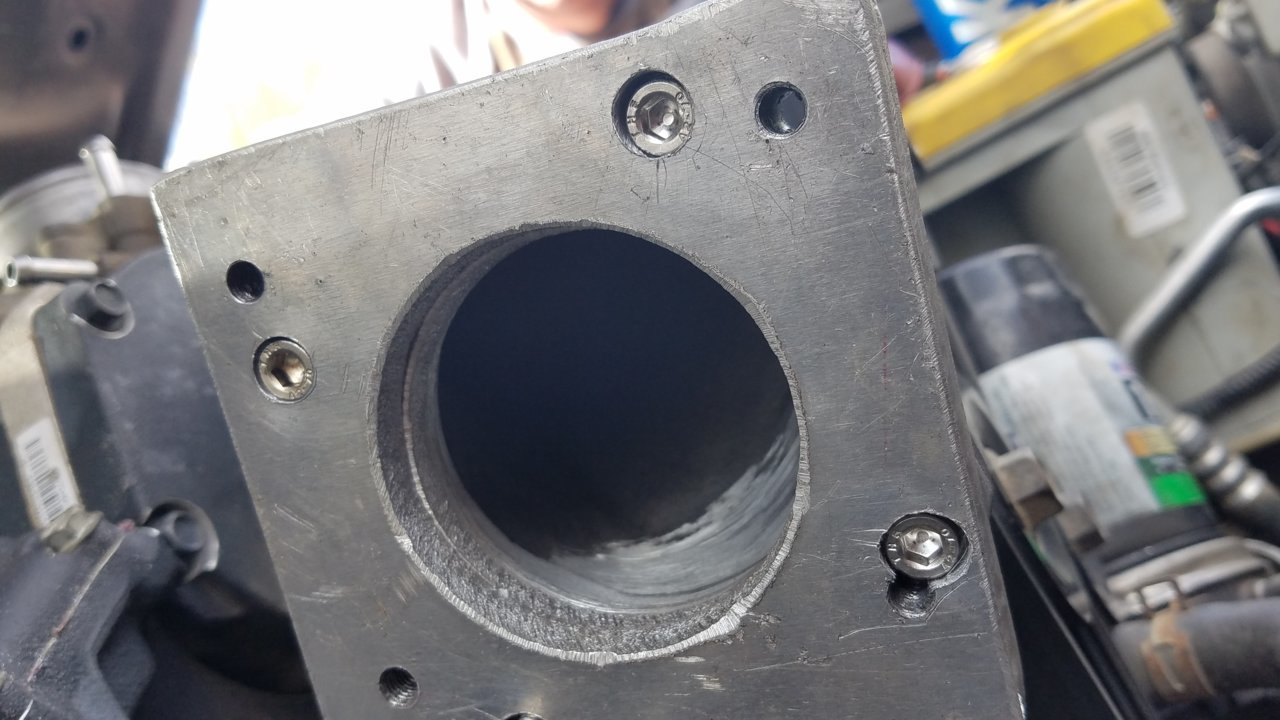

    When urd is out of stock of 76mm throttle body adapters and you decide to make your own:notsure:.
    Porting on throttle body side done and it's close on the supercharger side. Ported the supercharger inlet to 70mm too.

    What did you make yours out of? Ive been waiting for them to get more in stock. Been months now

    Just some 6061 aluminum I had sitting around the shop. It looks crude so far but I'll clean it up and shape it once I finish porting/polishing it
