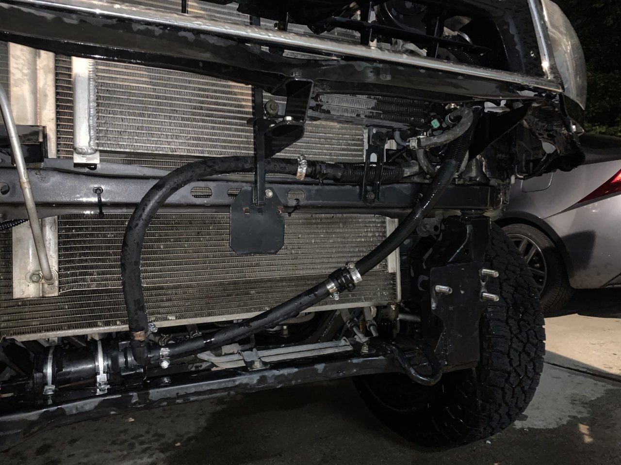

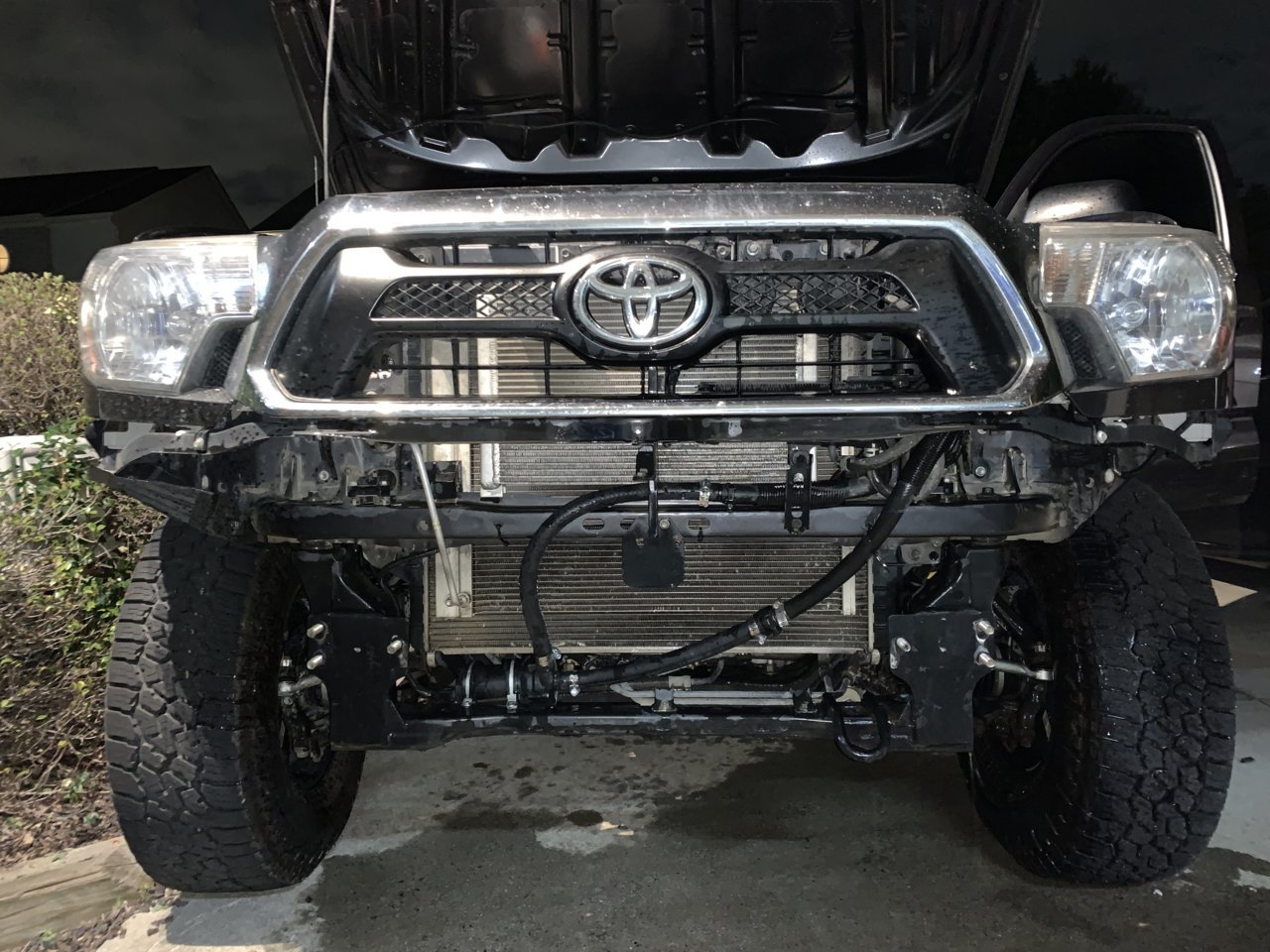

    Finally got a change to relocate the inter cooler pump! Not ecstatic about the extra connections required to extend the line, but I can always replace that later.
    80EF1A6A-B055-4C48-9CBD-3090866AAB13.jpg 060078A1-5832-4EFA-98B2-E50D06408361.jpg 61DF674C-2C69-45E9-BA48-C51BCC3BA8E4.jpg

    How come you moved it down there?
    I moved mine so I could fit my winch. I actually ended up shortening the hoses. I don’t have any close ups, but this will give you an idea of where mine ended up.

    I was looking at that spot but I didn’t want it sitting in front of the impact sensor, and it was fairly tight in that area. I also wasn’t positive if I was going to have room for my bumper and winch, so I moved it where it is so there’s no doubt that it won’t be in the way. Once I get the bumper and skids on it won’t be exposed at all
