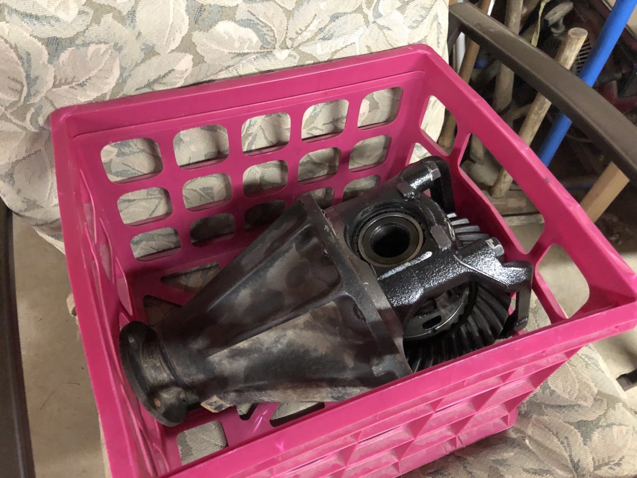

    No regear or true locker. I found this stock limited slip diff on here for cheap so I picked it up. Now I have an extra diff I can send off to be built. Now I just gotta find an extra front diff and I’ll be set.
    Also I was amazed at how clean my diff oil was. Hardly any metal on the magnet too. Most annoying part of the project had to be getting the drive shaft bolts loose. Those sum guns were on there tighter than a virgin. Also having to disconnect the brake lines, but I hate bleeding brakes thats the only reason I am complaining.

    Don’t need to disconnect the brake lines. Just need to unbolt the brackets on the hard lines and stretch them out a bit. I did no brake bleeding on my diff swap.

    You sure? I felt like the bracket towards the driverside that holds both lines together would have prevented it. Oh well now I know for next time.

    Yes quite sure as that’s that I did.

    Damn I wish I didn’t doubt myself now. Oh well it’s been about 2 years since I have flushed the brake fluid so it’s about that time.

    Second that, it is possible and makes it a lot easier
